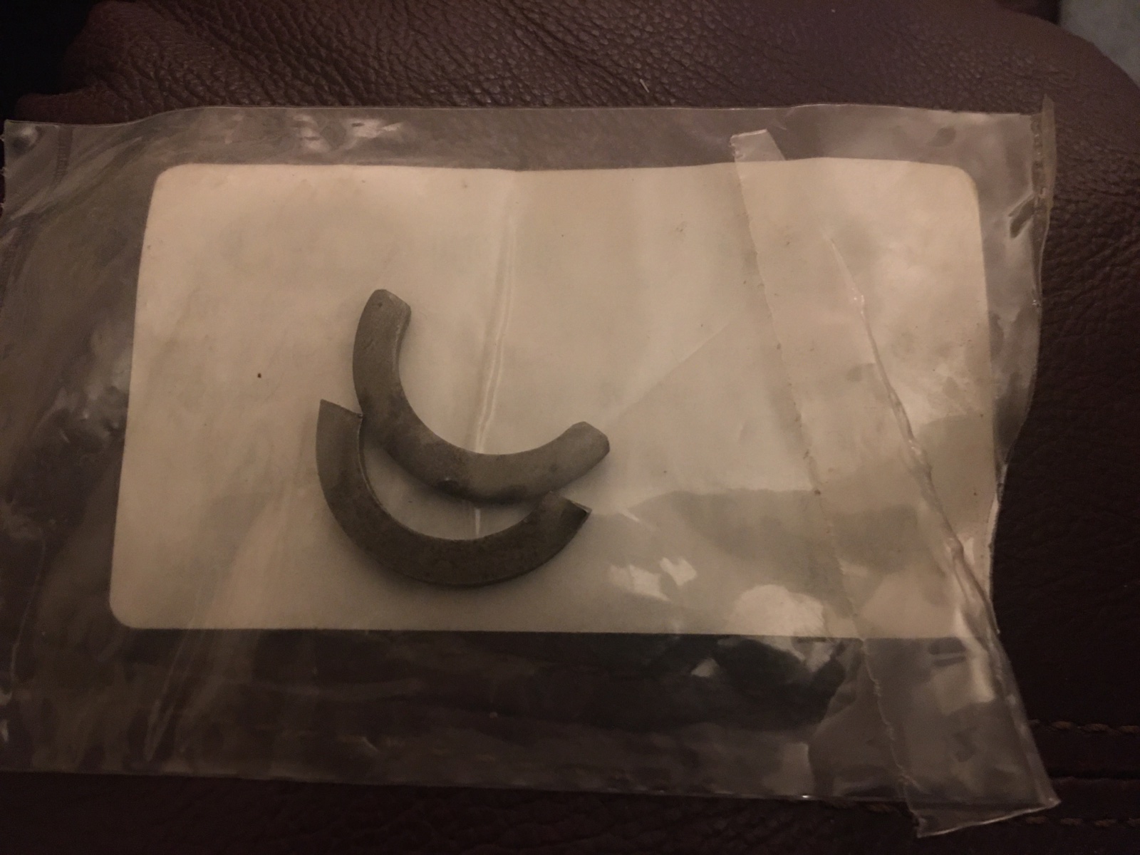

The previous owner did not have a mechanical bone in his body but he had a wonderful heart.
My dad and myself walked him through everything he did, or worked with him on it side by side.
We instructed him on assembling the rear differential. Afterwards we went over it again specifically asking him if he had inserted these.
He hadn’t so he took it apart and put them in.
I keep trying to convince myself that i can get a “good enough” look at the gear lash with a scope since it hasn’t ever had oil.........
Yeah I know—-just trying to convince myself again when i know better, if he could forget that, how could he possibly have set it right?

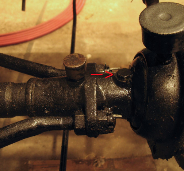

It's easy enough to check the U-joint rivet.
Just remove the plug and look inside.
