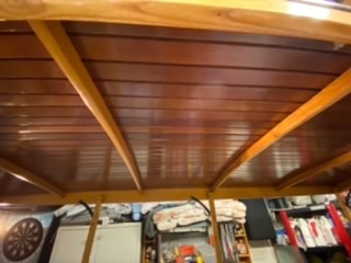

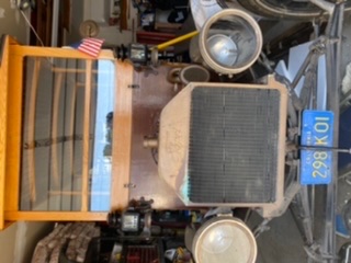

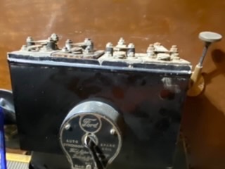

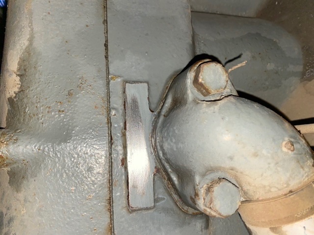

Good afternoon all! I’m a newbie to the forum, and a real newbie to this beautiful automobile! My neighbor purchased it a little while ago, and was told it just needed a little tune up!! Ya! I’ve been trying for a few weeks to get it started and have had no luck! I originally thought it was a fuel problem, so I replaced the carburetor! Nope! Now I’m thinking spark? But..... I replaced the plugs, I “think” all the coil packs are firing, but not sure? Any help is greatly appreciated! There’s no spit sputter or even a cough? I’m not an expert mechanic, but I know a little something about turning a wrench? Just trying to get this beauty moving again!
Thank you in advance!

Welcome to this awesome fun packed hobby! You’re correct in expecting engine problems to either be electrical or fuel. Does gasoline make it to the carb bowl ? The firing order is 1,2,4,3. You may remove the spark plugs, lay them on the head and reattach the wires while hand cranking the engine through this firing order. Good, hot, blue spark ? While the plugs are out do a compression check for each cylinder. Make sure the spark lever is sufficiently retarded or a backfire might injure the Cranker.

Do you have a charged battery? If so is the key switch turned to battery? Slowly hand cranking, you should hear each individual coils buzz. I have been around these cars for about 6 year’s. Definitely still learning, you need the service book. It helps wonders, and so does this forum.

Thank you so much for all the useful information! I currently have the plugs out, and the wires attached! All the plugs are firing, though I will need to check the order! I didn’t really pay attention to that! Oops!

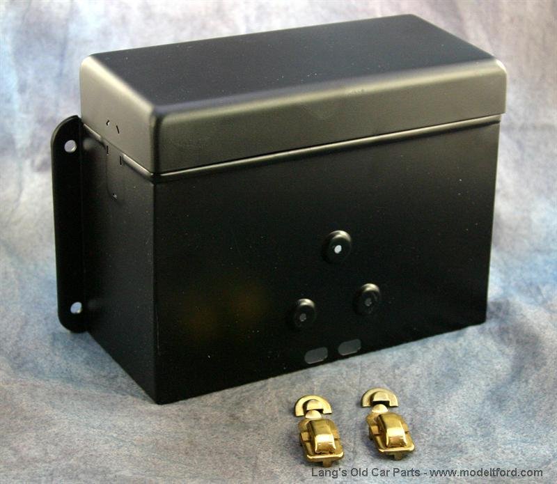

I do not have a battery in the vehicle? Honestly, I can’t see a place to locate one? There are two wires that I believe would go to a battery, but I have no idea where it would go? I have a trickle charger attached to those two wires, set on a 6 volt setting, and I do hear the coils firing.
Spark retarded? Now ya lost me? But I already know what you mean about injuring the starter! 2 weeks ago I threw my back out trying to start this puppy! Lol
Oh and service book? Where might I get one of those?

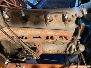

From the pictures it appears you're dealing with a 1914 or earlier chassis. That means no electric starter unless one has been added, and the battery goes wherever you want. With no electric starter the battery doesn't have to be very big. http://dauntlessgeezer.com/DG102.html.

You will not be able to start your T without a battery, so that is the first thing you need to do. You will need a 6 volt battery with the positive at the northwest corner and the negative at the southeast corner, closest to the chassis where it is negatively grounded. Positive goes toward the front. In my 1926 coupe, the battery is located behind the driver’s seat below the floor and is accessed through a trap door behind the driver. If you crawl under the car, you can, more easily locate the holder. There might even be a battery in it that can be used to trade in for a core charge, if the battery is bad. I get my batteries from Auto Zone. Take measurements of the battery holder including height and take the measurements there and they will match you with a battery matching your measurements.

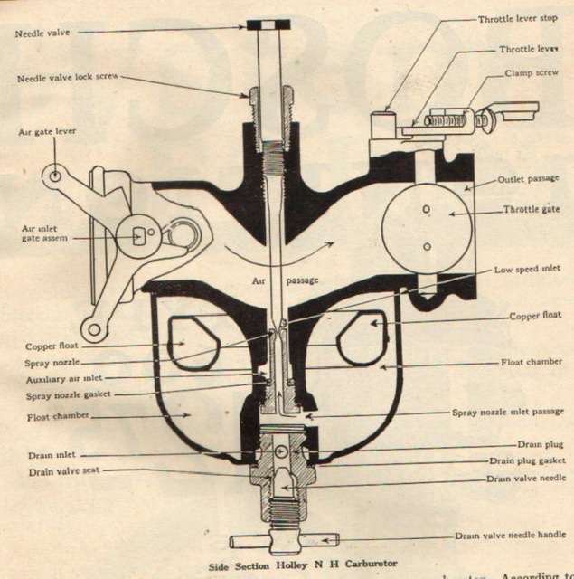

If your carb has not been rebuilt, it should be to ensure it does not leak. Rebuild kits can be purchased from Lang’s or Snyder’s. All carbs are different, so start with 1 counterclockwise turn of the choke from the closed position (7/8 to 1 1/8 turns). You may need to set the float level. On my Holley NH the float level is set 15/64” from the flange to the top of the float. Turn the key to BATT retard the spark and advance the gas. Engage the emergency brake which also puts the transmission in neutral. Be sure to chock the wheels, if you are not sure if the emergency brake is set properly, so it will not run over you and take off through the back wall of the garage. When starting with the crank, position the crank at 7:00 and using just your four fingers (do not wrap your thumb around the crank), engage the crank ratchet in the front pin of the crankshaft, Pull the brass choke ring and hold it while yanking the crank up clockwise to 12:00 and let go and quickly get your hand out of the way (Some people prime the carb by keeping the key off while holding the choke ring and cranking several times, then turn the key to BATT and then cranking without holding the ring out). When cranking with the crank, you let go at 12:00 and quickly get your hand out of the way, in case there is a backfire, that will cause the crank to spin counterclockwise and break anything that is in the way. If the car starts, quickly go to the cab and advance the spark, give it some gas by pulling down on the throttle lever and switch the key to MAG. Now you are ready to cautiously learn to drive it. Good luck. Jim Patrick

You can install a 6 volt battery and connect it to the ignition switch in the battery position. Be VERY careful not to let it come in contact with the magneto contact or the magneto switch position, because connecting a battery to the magneto can discharge the magneto.

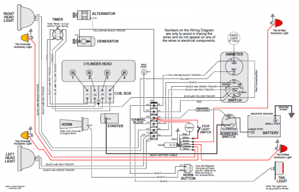

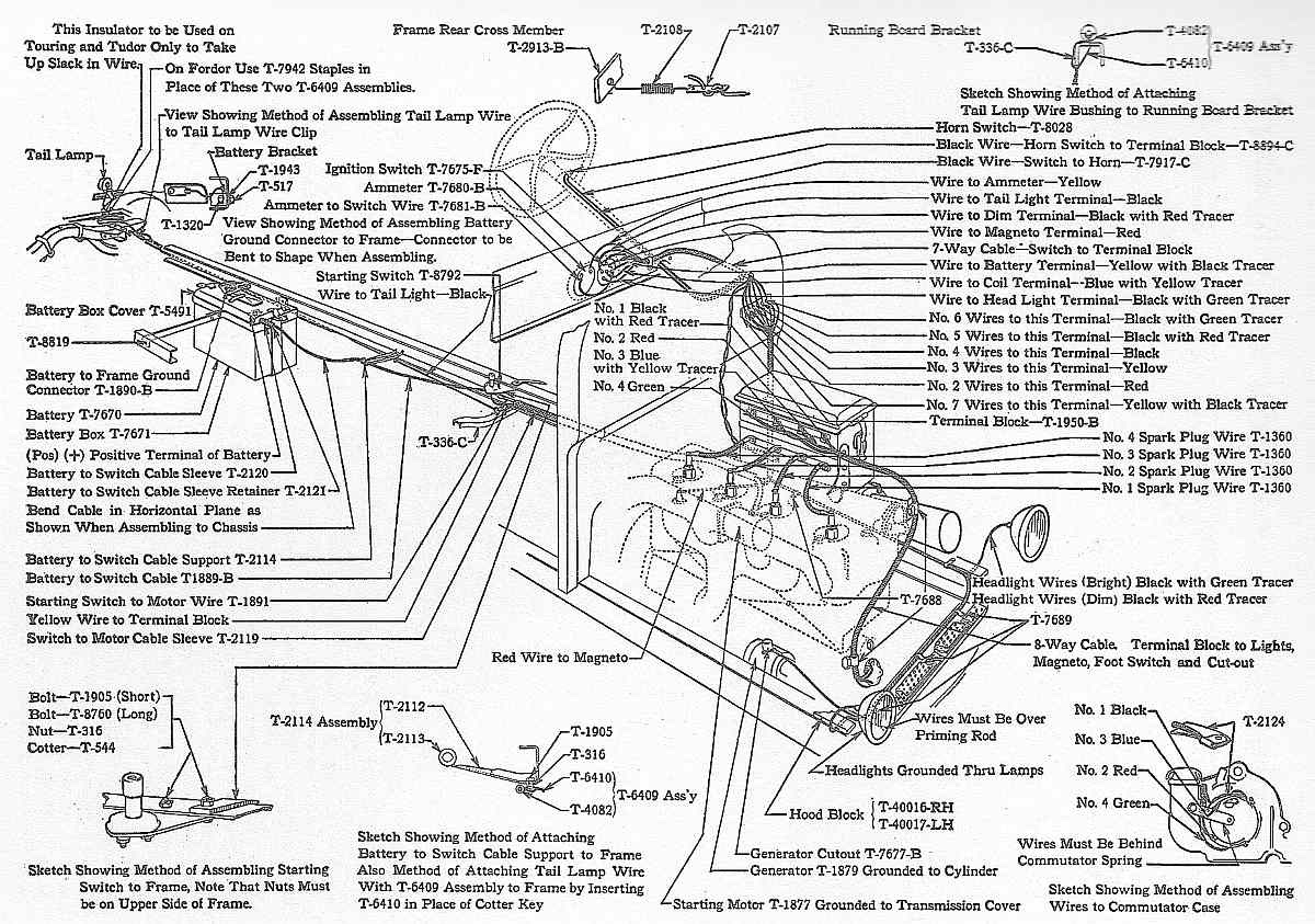

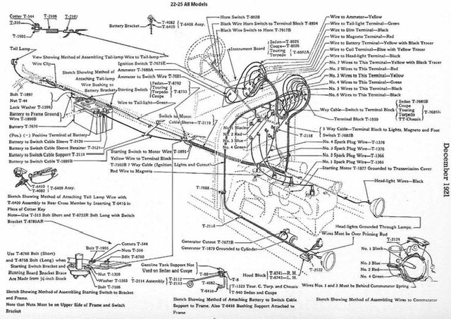

Here are a few diagrams to help you trace the wiring. Jim Patrick
- Posts: 7275
Re: Another newbie No Start
The two wires, a lack of battery, don't know where one would be mounted are all a bit confusing. One post points to having the battery in the original carrier and suggests the type of battery used in that application. That info is pertinent to a starter equipped car. You are dealing with an earlier car which most likely does not have a starter. You are also dealing with a non standard body. So, the battery could be installed anywhere. The two wires may well be at the mounting place. If the battery was used for ignition only, it does not need to me a full sized lead acid style battery. A much smaller motorcycle sealed battery is quite adequate, around 12-14 amps.

Guys, let's pay attention, shall we? As Norm and I have pointed out, the pictures suggest this is most likely a pre-starter car. Let's aim our suggestions in that direction until we find out otherwise.

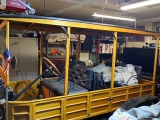

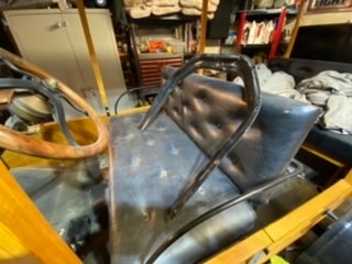

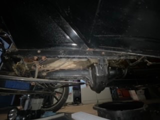

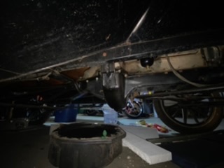

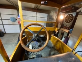

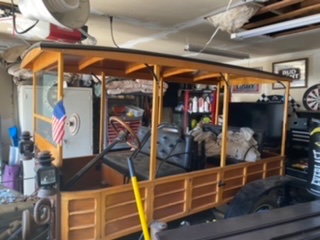

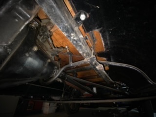

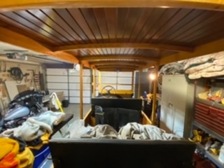

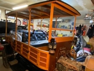

Eric. More pictures please of the engine (both sides), the interior and instruments, the underside, if possible, and the body and woodwork. What is the engine number (driver’s side of the engine above the water inlet). Jim Patrick

There is NO starter, hand crank in the front. I deliver mail for the USPS in a little town not far from here. I used to drive a tow try for a local AAA company here in town. When my neighbor bought this T, she bought it from a customer, I deliver mail to! She called me and I went and grabbed a tow truck and hauled it to her house , next door. Then we pushed it into my garage. The previous owner stated that it was running and driving then it got a 2 rear flats so he parked it for a bit, that turned into a year. He bought new tires but never put them on. He said all it needed was the gas tank and carb flushed. I cleaned the tank, soaked the carb, didn’t get a good result from the carb so I sent it to a company in Massachusetts to get rebuilt. Apparently the carb that was on it was something they didn’t rebuild so I purchased one off the shelf that they had already rebuilt. It’s a Holly NH you should be able to see it in the picture. Here are some additional pictures. Looks like someone has painted over the engine number. I can see any numbers?

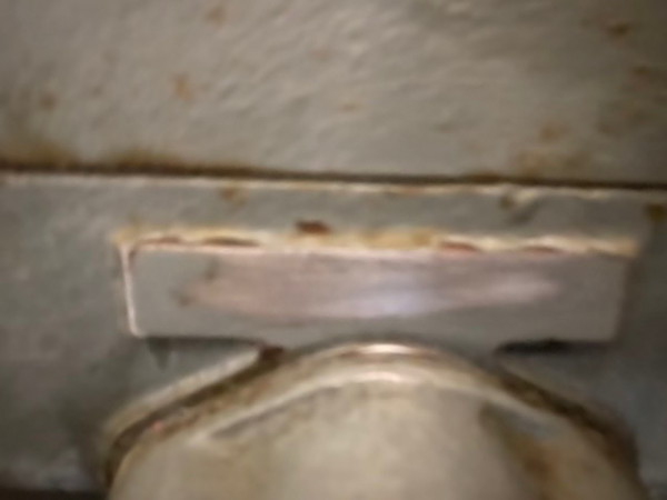

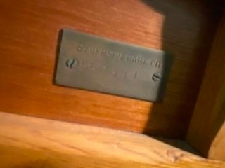

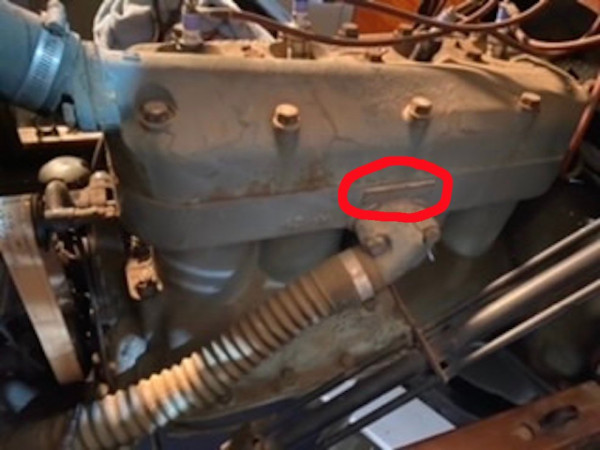

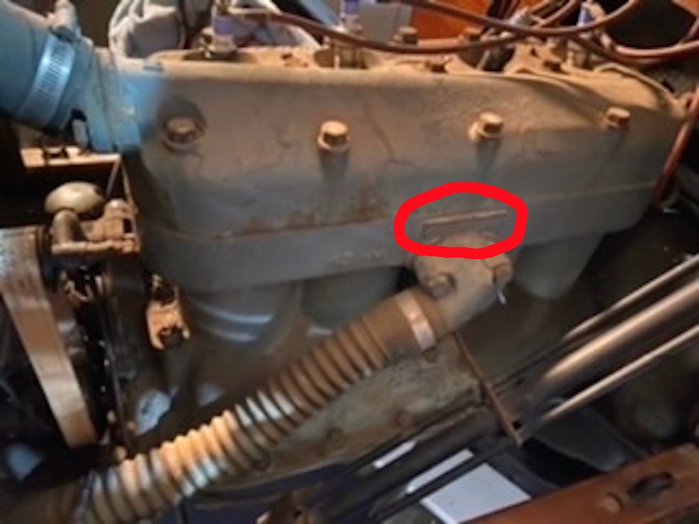

- Posts: 7411

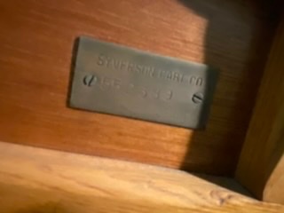

I see more hints at 1914 or earlier.

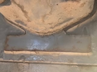

The engine serial number should be here. The other photo suggests it may be filled with paint. Maybe some coarse sandpaper will make it readable.

I knew there should be a number on that motor somewhere! I’ll try and bring it out a little tomorrow when I get home. I have one more picture to show. Not sure if this number is accurate? But it’s a nice piece of history to go with it. An old registration card!

If the number on the tag 566404 is in fact the engine number it would indicate that the engine is an August 1914. If the coil box lid was made in one piece and has rounded corners , see photo, the box is 1914 (repro coil box $299 + repro switch $274). Since many parts (but not all) of following years were backward compatible it would help to id as many as possibleMousecat wrote: ↑Mon Oct 19, 2020 12:18 amI knew there should be a number on that motor somewhere! I’ll try and bring it out a little tomorrow when I get home. I have one more picture to show. Not sure if this number is accurate? But it’s a nice piece of history to go with it. An old registration card!
engine numbers http://www.mtfca.com/encyclo/sernos.htm The number in this picture is in the range of an engine number but different t han he one on the tag - all is hard to read bu t looks like SYVERSON CART CO 552589 also a Aug 1914 engine number. NOTE: Syverson Cart Co should not be confused with Syverson Cabinet Co
- Attachments
- 9618BD83-06FE-4993-B911-8F9B22BE9FF1.jpeg (10.61 KiB) Viewed 7466 times
- Posts: 7411
It's unlikely that the engine has been changed since that 1976 registration, so 566404 is probably the engine number buried under paint. That dates the engine assembly to Thursday, August 27, 1914. The 1915 model year came late, so that date is solidly 1914.
1914: August 1913 to January 1915 approx. [August 1913 through December 1914 approx.]
1915: September 1914 (Sedan), October (Coupelet) and January 1915 (open cars) to August 1915.

Thanks folks for all this great information! I have a few ideas on things to do, I just need to find the time to get them moving! I am in no means in a hurry for any of this so I can take my time. Hopefully I can get something accomplished this next weekend? I'll keep y'all informed of any progress.
I did scratch the paint off the ID number with some course sandpaper this evening, noting showed up? Hard to tell if it's deeper down or it might have been grinded off? That would not be good! I'm going to try to remove the paint instead of scratching it more? I'll post a pic from my phone here in a minute.
Thanks again!
Thanks again!
- Posts: 2967
- Last Name: Hjortnaes
- Location: Men Falls, WI
Looks like it was ground off or was a replacement engine that was never stamped.
- Posts: 7411
Replacement engines had serial numbers, but replacement blocks were unnumbered. They were to be stamped with the number of the presumably wrecked block they replaced, but they didn't always get stamped. That's probably what you have there.
Eric, Looking at your photos you have one showing the manifold side of the engine, near the timing cover there is a 3017D generator block off plate in view indicating the block is a later than 1919 production. Look on the block below the manifolds & see if there is a single long valve chamber door with the throttle rod coming thru a hole in the cover or 2 shorter ones with the throttle rod coming thru between the 2 covers? One cover would mean you have a block from mid 1922 or later, two doors would be a block from 1919 to mid '22 production. Service engine blocks were outfitted to be able to accept a generator or the 3017D was available to use with an original pre starter timing cover for early cars not having a generator. This may explain the blank serial number boss. George
- Posts: 7411
I missed that detail of the post-1919 generator spot. Obviously a later engine, and one of those unnumbered replacement blocks.
I confess that I have not read all of the posts, but in the OP it looks like the owner is diagnosing the problem by throwing parts at the car. The Model T is no different then any modern gasoline-powered automobile; fuel, air, and spark at the right time and if the engine is in decent mechanical condition it will start. Checking air is easy - pull the plugs and with the ignition off, put your finger over a spark plug hole and have someone crank the engine. Find someone with a bit of endurance as you may have to crank the engine over two full revolutions for each hole. A clever person will use two fingers and do two spark plug holes at a time. The person cranking will appreciate that. If you can feel pressure coming out of each cylinder on the compression stroke, the engine is probably in good enough condition to run. Previous posts have dealt with spark and fuel; you want to establish that both are present. I would do the fuel check first with a bit of starting fluid, but go easy with that stuff.
Welcome to the affliction!

Study the electrical diagrams until you get it. Just make sure no DC power is given to the magneto. Ever.

Timing: 1,2,4,3 on a T. Give the timer a good servicing, cleaning and lubing and make sure all the wires are in good shape and snug.

Eric, I see a lot to digest here & not to confuse you more I want to add my 2 cents. MOST IMPORTANT TO ME IS SAFTEY, I am not a fan of starting a T in an enclosure. When I was able to use my neighbor's garage I always pushed my T's outside, it is not that hard. I always have a functional fire extinguisher near by. You indicated that you replaced the spark plugs so I only can assume that they are new? When cranking the engine over do the plugs get wet with gasoline? Have you put a few squirts of oil in the cylinders, it lubricates, makes a better compression seal (& suction for fuel on the intake stroke) & makes it easier to hand crank. Placing the rear axle up on jack stands with clearance under the tires & placing the handbrake lever forward places the transmission in high, when cranking you will be rotating all of the drive train, it also should be easier to hand crank. As a last resort tow the T (at a low speed), but if you are not experienced with driving a T, I will not recommend a novice to be behind the wheel of a T while towing. You need to mentally become at ease with the workings of the clutch pedal so that you do not have to think about it, like riding a bicycle, if you go for a ride on a bike you would just hop on & pedal not think about it. I think the move for a reconditioned carburetor was a smart move, I hope you recovered the original carb for later as it should stay with the cars spares. Good luck on bringing the car back to life. George
PS, I think the body was a kit by the Syverson Cabinet Company, I have an Open Express that is & Ray the makers son gets on these Forums from time to time, the tag may have been produced locally to provide a serial number location for registration.

Another Sunday and another day in the garage! I dropped some oil in the cylinders and let it sit for a couple of days. Looked everything over, looks like number 3 coil pack is not firing? I’ve got 4 replacements, so I should be able to get one that works, if not I’ll send them off to get repaired. One other thing I noticed that struck me a little funny.... I tested out the wires from the
Cap to the firewall, if I’m connected to number 1 wire, should I be getting a contact reading on ALL of the pins on the firewall? I’m thinking there might be a short in the wire harness? In any case, I have found a gentleman that has a 24 model T and he knows the president of the local chapter that went under not to long ago. Anyways, they are going to try and stop by some times this next week and look it over with me! Hopefully the knowledge they have will get her going! Thank you all for your input! I’ll keep ya posted on what comes!
- Posts: 6581
Your question is ambiguous - are you asking if you should be getting a reading OR are you questioning the fact that you are getting a readingMousecat wrote: ↑Sun Oct 25, 2020 5:35 pmAnother Sunday and another day in the garage! I dropped some oil in the cylinders and let it sit for a couple of days. Looked everything over, looks like .... I tested out the wires from the Cap to the firewall, if I’m connected to number 1 wire, should I be getting a contact reading on ALL of the pins on the firewall? ...
To test the continuity of a wire you must disconnect it from each end. If you don't get continuity then the wire may have a break in it causing the voltage not to pass through it. A "short" is caused by an unintentional connection within the circuit.
NO to the word ALL because the two lower posts are for the power source either Mag or BAT depending upon the switch position. The posts above them go to their respective plugs and the top row is from the timer. The coils have points and if they are open there would not be a connection from the top row to position to its corresponding plug end.
So to properly test for continuity a wire needs to be disconnected from each end. If you testing a single circuit path then the ends of that patch should be disconnected from the circuit.

Eric, On a Model T timer wiring harness to ground can be caused by a wire terminal grounding against the timing gear cover. That would cause that coil to "buzz" with the key on, this does not sound like your issue. Sometimes a non firing coil (buzzing) can be caused by dirty terminals in the coil box, terminals on the coil or a loose coil, if loose place a cardboard shim between the back of the coil & the back of the coil box. George
