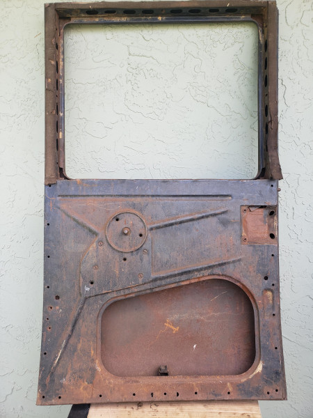

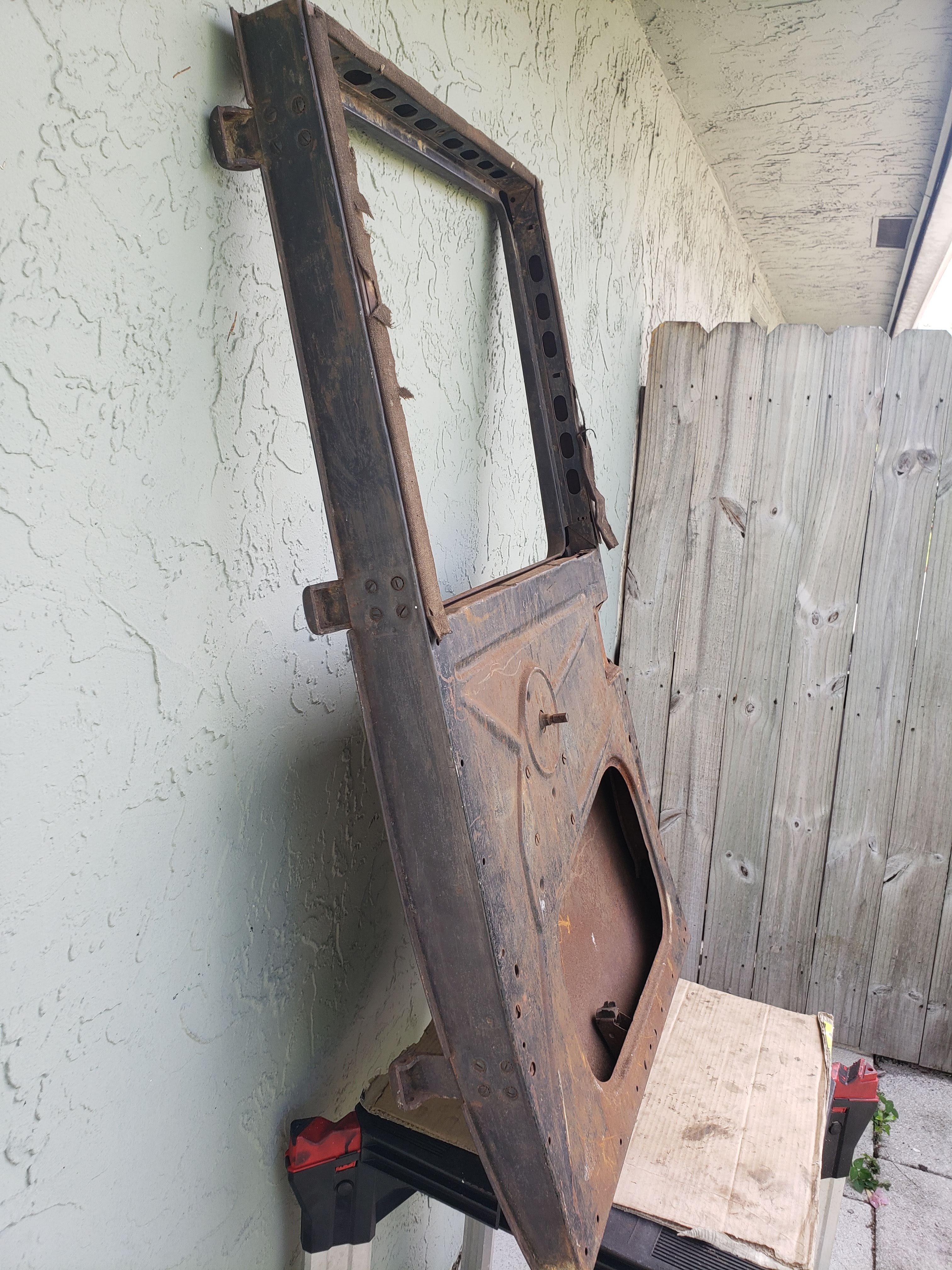

Help Identify Door

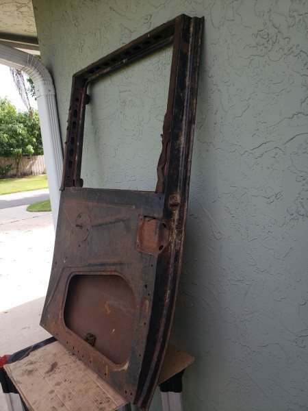

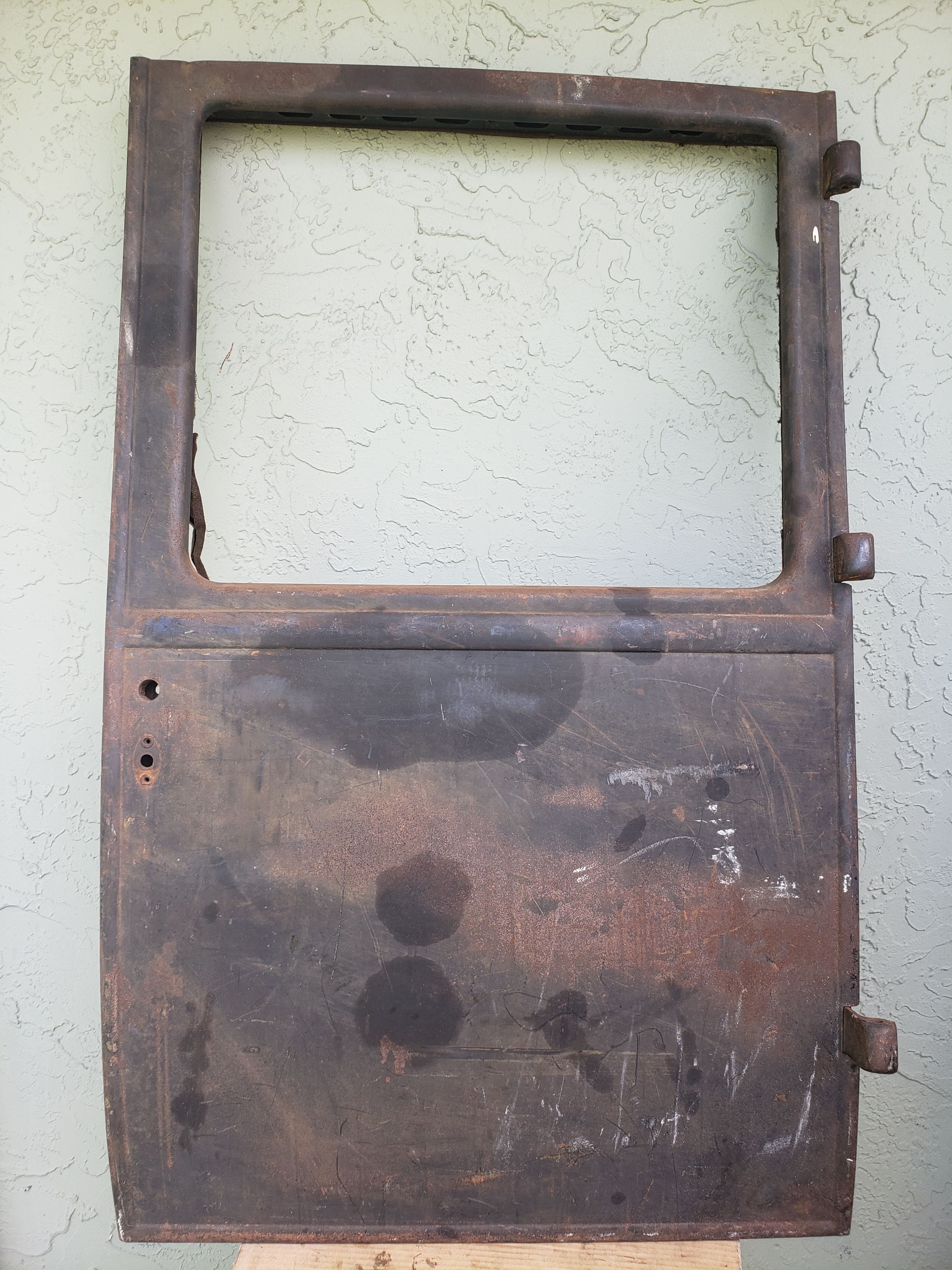

Can not tell how wide it is from photo, need a measurement, it is 25 door but do not know if coupe, fordor or a tudor from width.

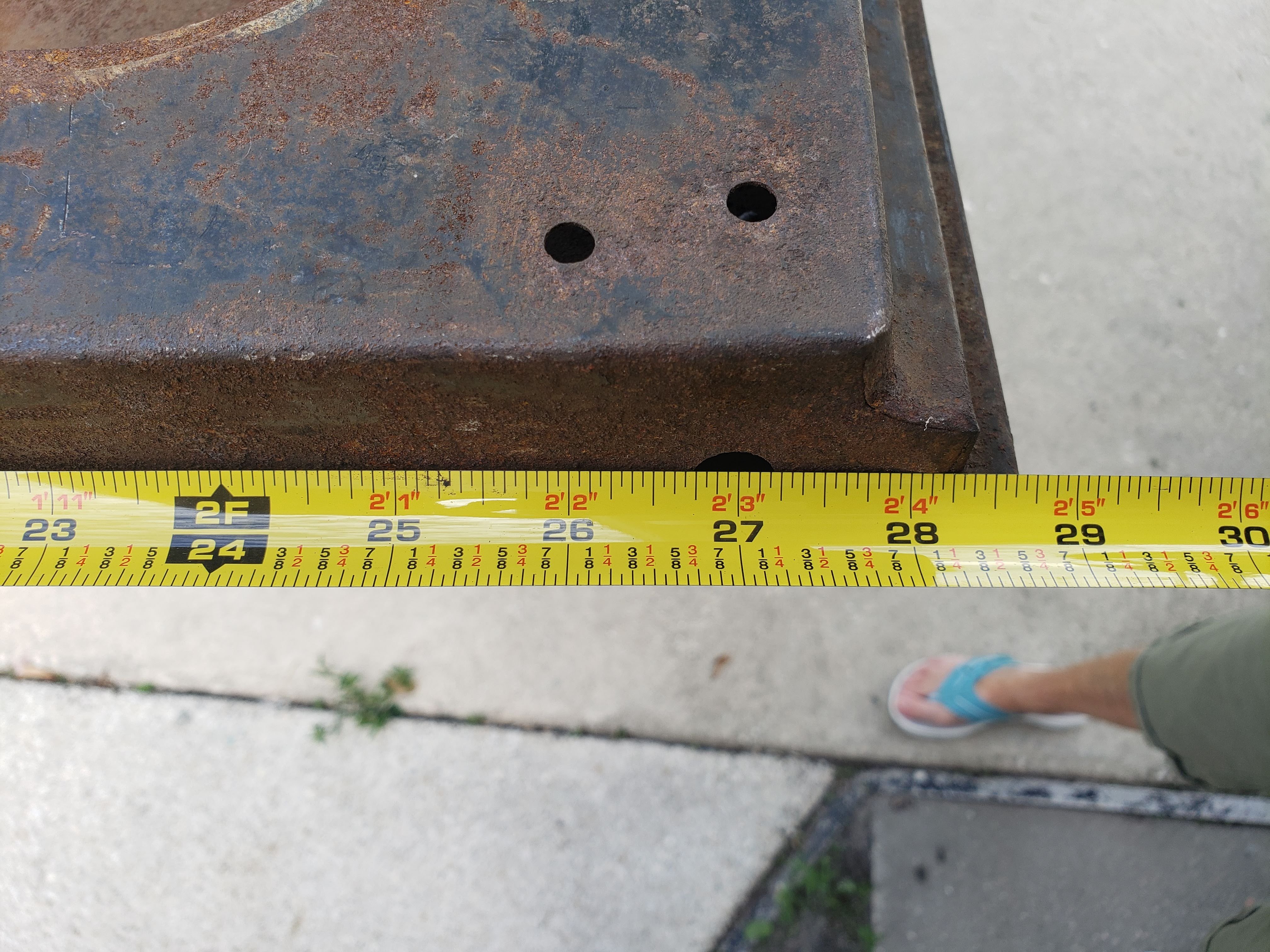

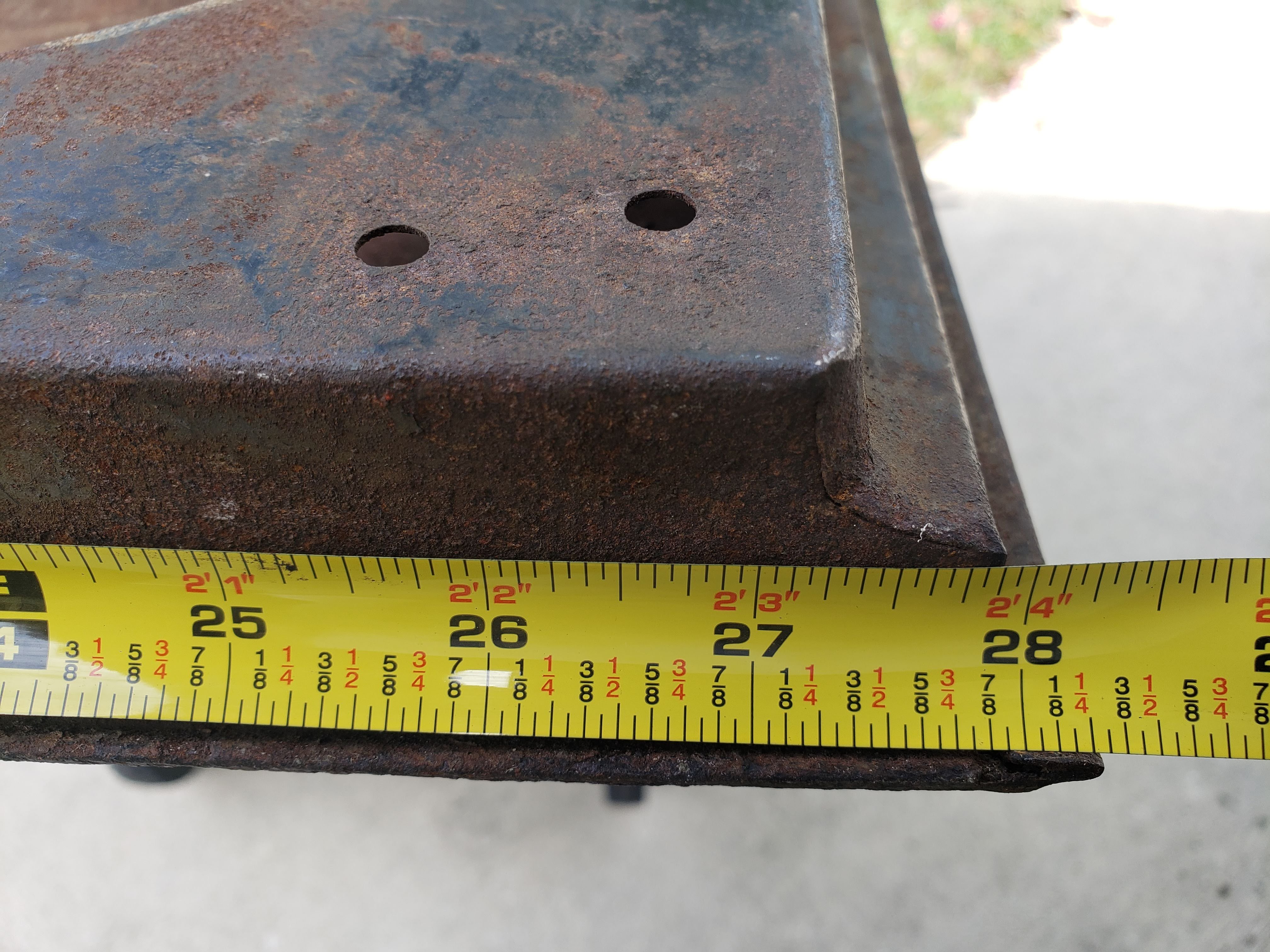

28" to 28.75" wide more measurements see link:

Looks like it's off a Fordor, it looks just like the driver side rear door I have apart on my 25/26 for window regulator repair.

Fordoor door, made by Budd Corp.

It's a right front door for a probably 26/27 fordor, i don't know when the all steel doors were first used, the back doors all have the angled rear bottom.

I have a 24 Coupe that I restored and doing so I found out the my car has wood framed doors but during late 24 Ford introduced steel framed doors which would be used on into 25.
But I don’t know if the 25 steel framed doors would be the same as the later 26-27 doors since those bodies were a little different than the 25.
The information in the Encyclopedia does mention the steel door change in 25 but doesn’t say if they were the same for 26-27. Others probably know for sure.
It does mention that some of 26 Fordor bodies only were similar but the fenders changed.

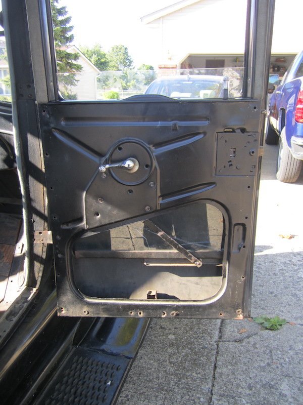

This is the right front door on my 1926 Fordor, I'd say it's close but no cigar?
Re: Help Identify Door
If someone asked me I would say it's a '25 Tudor sedan door. I just measured mine and it is 28 3/4 wide and 47 1/2 tall measured on the outside. Measured inside is 46 3/8. That's what your last photo in your link shows. My Tudor has wood framed doors but the late '25 steel doors should be the same. I measured some '24-'25 coupe or Fordor doors that were only 24" wide.

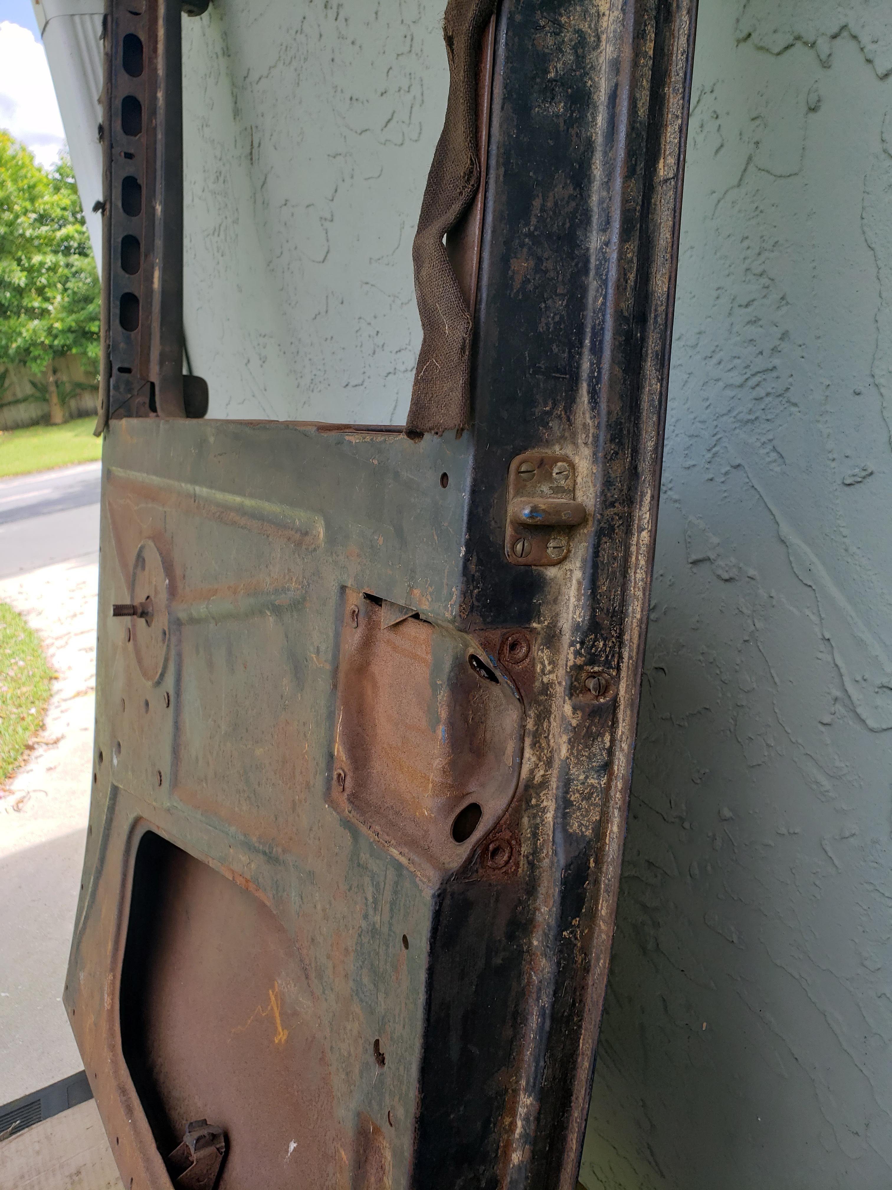

Definitely a front passenger door, it has the hole for the keylock. I just checked my '25 coupe door and it is only 24 inches wide and the window regulator is nearly centered like Joe's Fordor door. The door in question is wider and the regulator is farther forward. My guess is it's for a Tudor.
