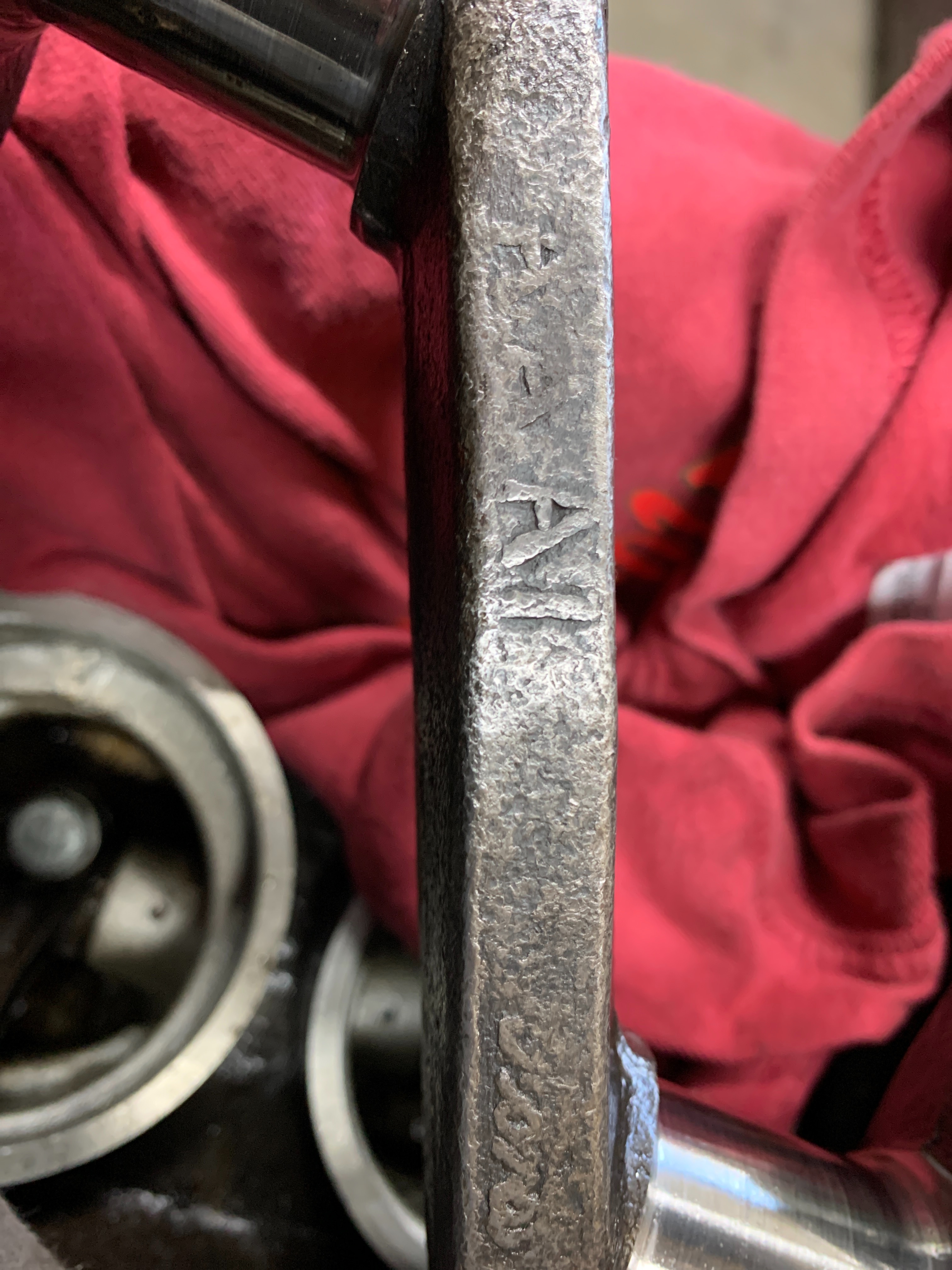

Thank you everyone for your comments. Here’s some more history on the motor. It came out of 26 touring. We pulled it two summers ago and replaced it with another one we had just rebuilt. This one has lots of miles on it and was last rebuilt in the early 70’s. I could tell it was getting tired and when adjusting the bands I could see that the triple gears were very sloppy and it looked like the magnets were almost touching the magneto coil.
I was getting bored so I want to see what it would take to rebuild this motor. It’s not a EE crank but a AAA crank. All the journals look nice(no scoring) except the third main. Knowing what I paid to have the last motor done right and that I’m in know hurry. I’m going to put this on hold for a while. The block also going to need new valves, pushrods, some seats, rings so it really complete overhaul.

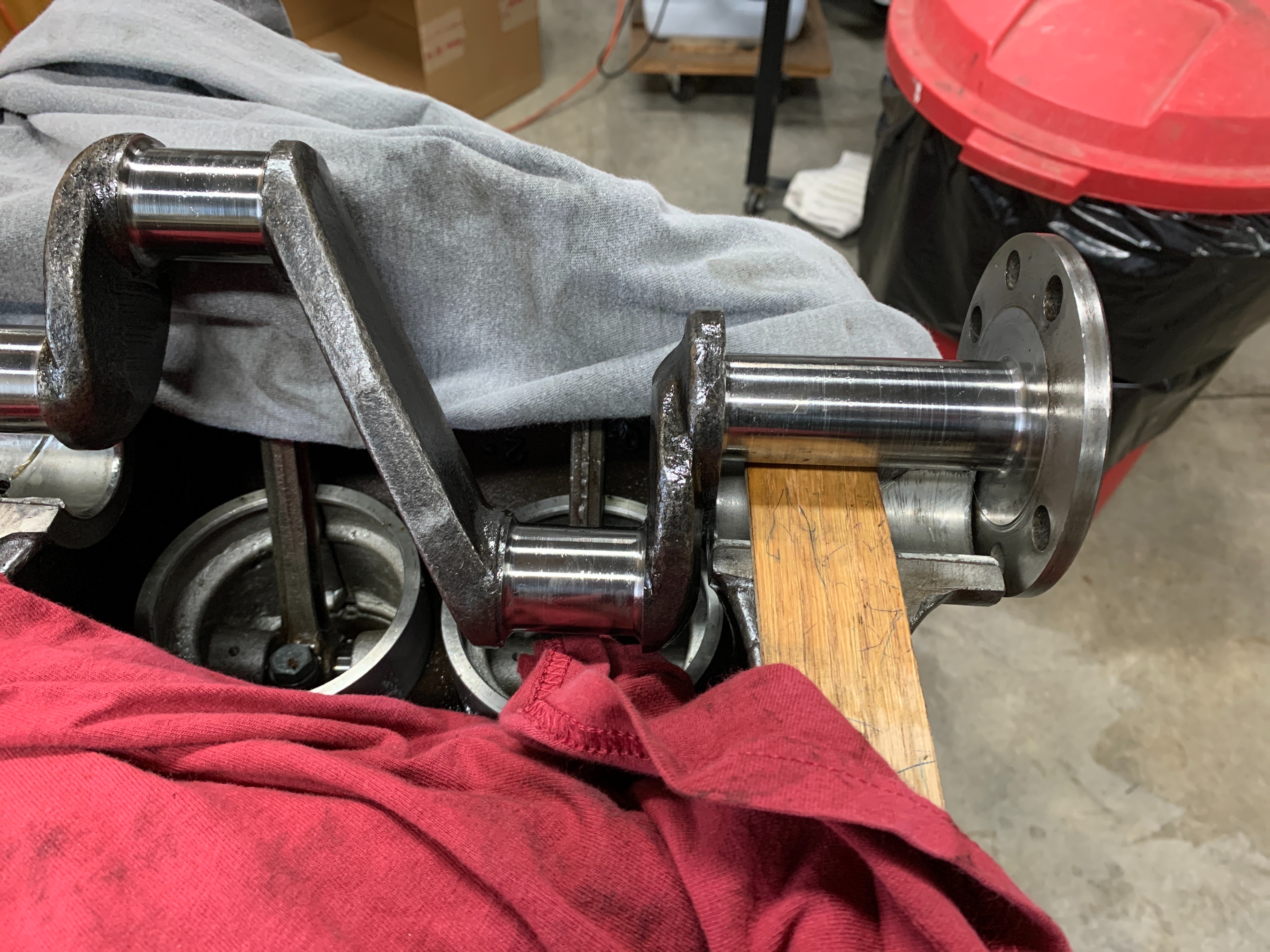

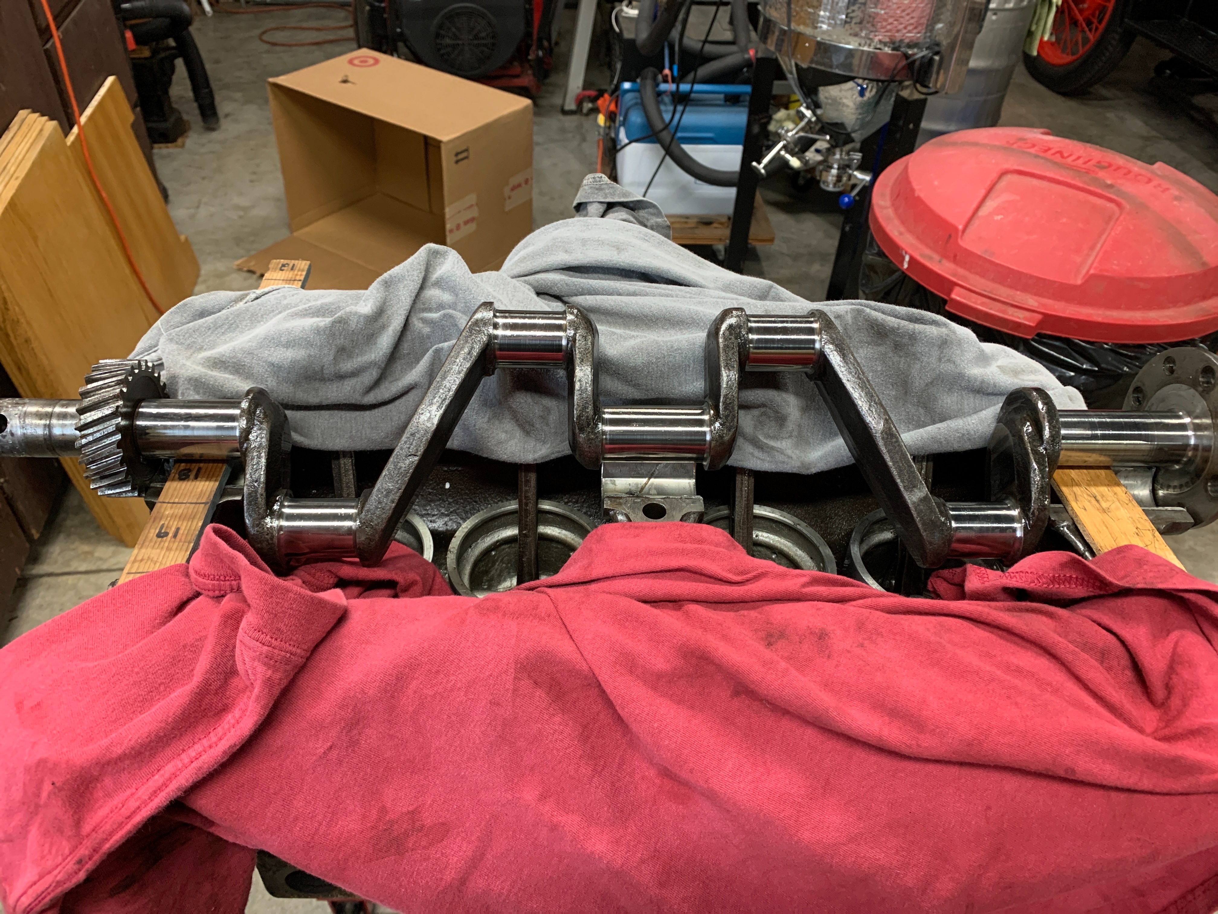

Here’s some photos

Not uncommon to see an earlier crank installed in a later block, I have seen many of them, I like even better yet to see two heavy rods and two light ones in the same block, they did what they had to keep them running.

Tom, Your #3 journal is probably on the “better side” of average for something that was in service a few decades. What I can see of the #3 babbit looks pretty rough though.

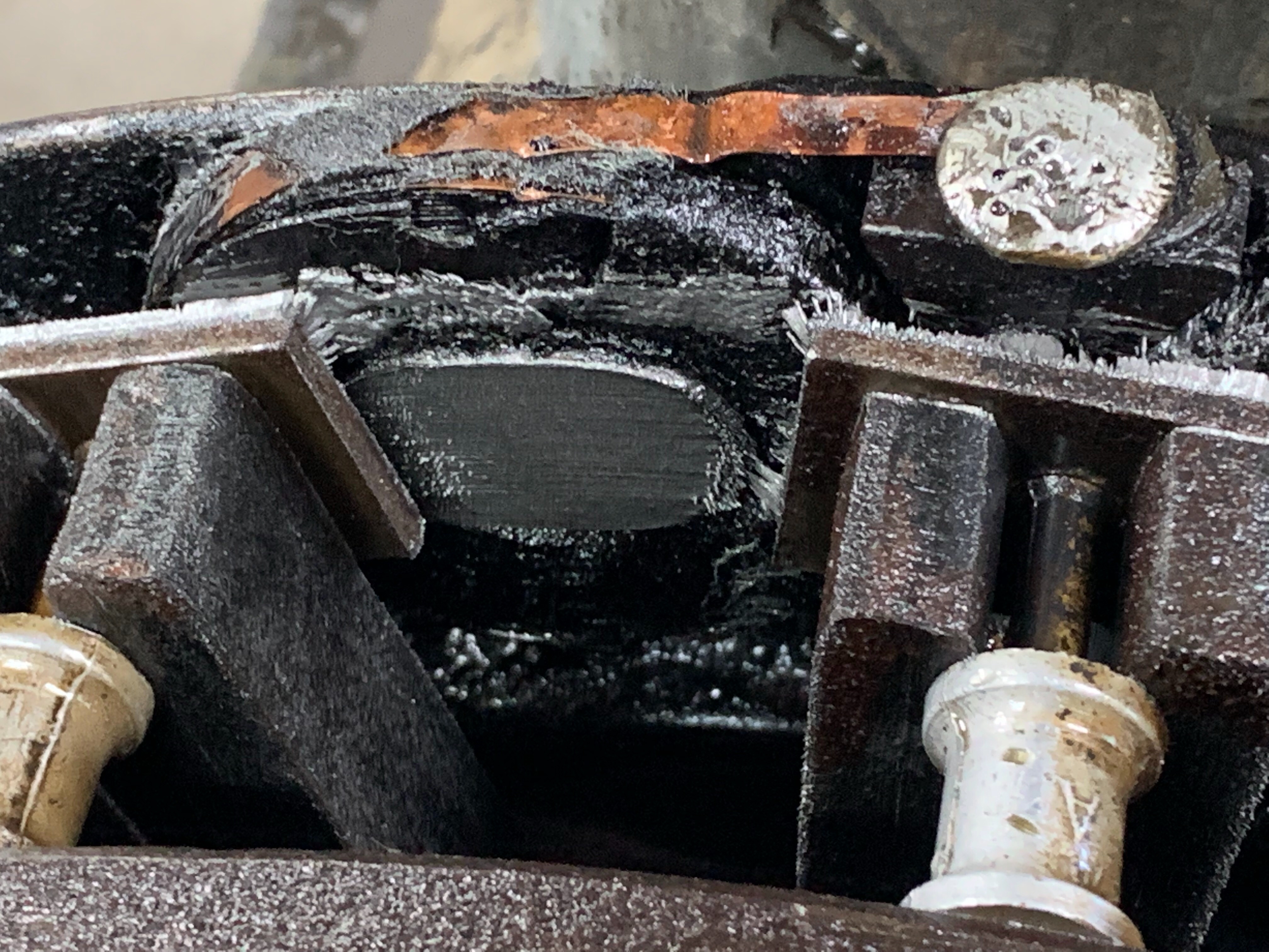

I think the 3rd main was getting a lot of metal shavings. Here’s the coil after the motor was pulled. I don’t think I had many miles left.

Doubt those shavings are from the crankshaft- something else is producing that quantity of shavings.

The black goo and most shavings you see attached to the magnets is from the rings scrapping up and down the cylinders walls as everything seats. It will diminish over time but never go away as the cylinders get polished, esp after a bore or hone job. If you washed the findings or even rubbed them between your fingers, I bet they would be a lot smaller then they look now.
