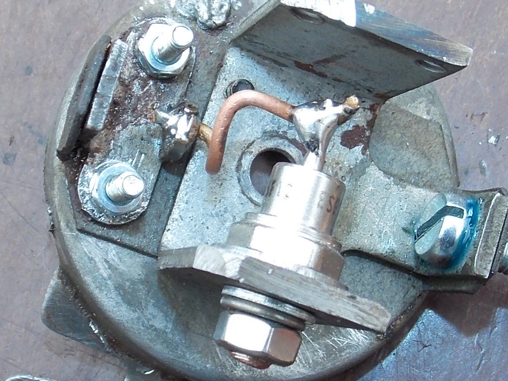

Re: Cutout or Voltage Regulator
Why do you not convert your old(or new) mechanic cutout to a diode cutout. It work great for me for many years now.
Good luck
André
