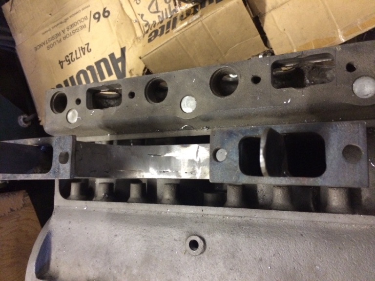

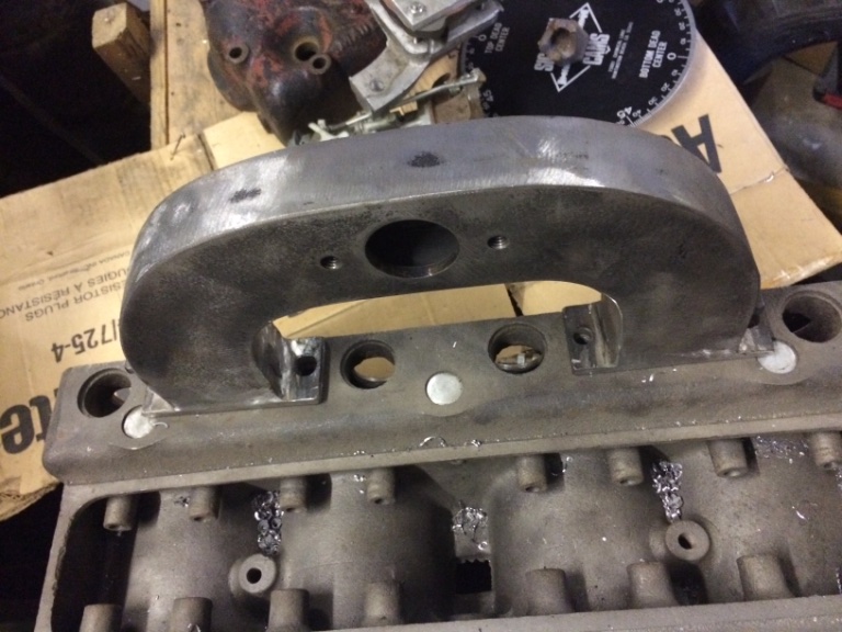

This manifold can be mounted either way up to accommodate either a updraft or downdraft
Effectively a 4 intake port manifold. Without the divider the bottom end torque is poor.

The majority of the intake is runner. Just plenum under the carb.

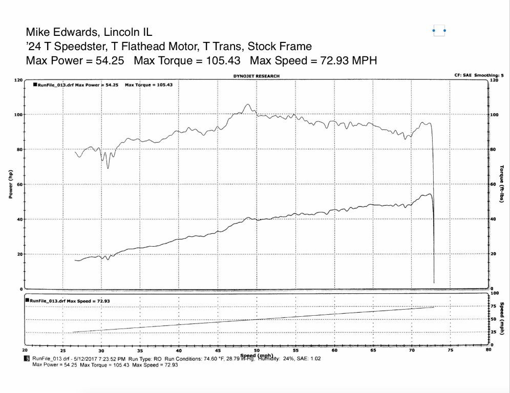

This Model T kicked my butt in Lincoln Nebraska 2017. I believe that this is his dyno sheet, WOW. It has simmilar porting. [/size]

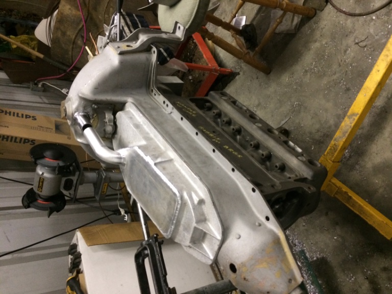

I run what I call a “semi dry” flywheel!! There is a dam that keeps the oil away from the flywheel. The transmission shaft is drilled and fed from the rear main bearing. Some oil is sprayed onto the bands.

Very interested in how you set-up your semi-dry flywheel .
Any pictures or drawings?

I hope this helps
