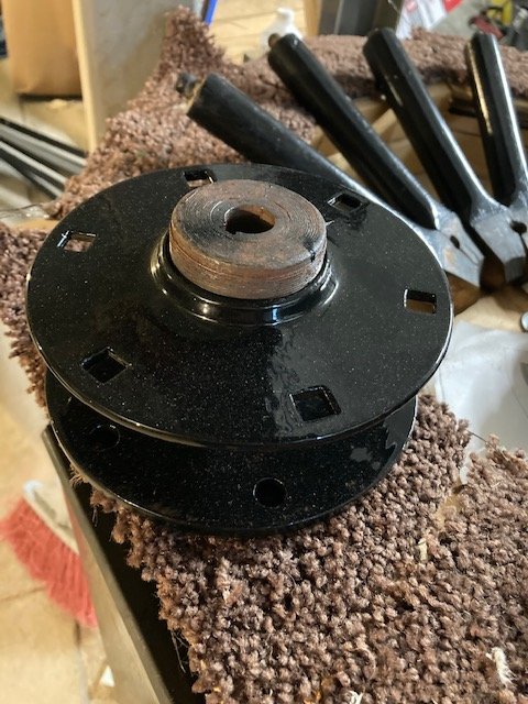

viewtopic.php?f=2&t=18771 The big problem now is my powder coated hub top plate is stuck and won't go down to its proper depth. I read a warning about this phenomenon in the past with powder coating hubs. I've tried sanding off some powder coat but so far no go. I am open to suggestion on ways to deal with this?

The easiest way to fix it is to remove the powder coat back to the edge of the spokes. You may have to do the same on the bore of the plate. These areas will then have to be hand painted with primer and enamel once the wheel is assembled, to seal out moisture.
The thIckness of the powder coat may also make pressing the spokes onto the hub difficult too, and you may have to remove the coat from the hub also.

To much paint or coatings causes this. Nothing new here. Use a file to remove the coating or enough to let the hub cover to slide down.
It doesn’t take much to make the cover stick.
Sometimes a coating of rust causes this to happen.
Clean off the hub surface and the inside of the cover. Use a light coating of lube to help it go down. It will go down eventually.
The fit is suppose to be pretty snug. It’s designed to be that way. To much paint and it won’t go.

The tolerance is very small. I had to file all of the powder coat off to get it to go on.

And...the powder coat came off with multiple applications of Citristrip and a cup wire wheel. Citristrip turns it into a tarry substance that isn't easy to get off by hand. I didn't want to do my PPG Shopline for just 2 pieces so I did Krylon Appliance Epoxy. I think the powder coat looks really good because as advised it is thick. The Appliance epoxy not so much but the difference in appearance is slight. Hub bolts absolutely do not fit especially on the rears because you have: outside cover plate thickness, inside cover plate thickness, hub inside thickness, hub outside thickness, drum outside thickness, drum inside thickness. That's 6 thicknesses on all the surfaces so if the powder coat is on thick, hub bolts literally do not reach.
