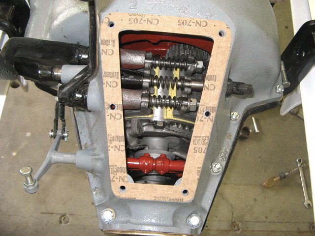

Are you saying it looks like this (picture stolen from the internet without permission):
If it does, it sounds like you are good to go. The collar does not move up and down, rather forward and backward (fore and aft). Does the clutch pedal move between low and high gear if you press on it?

Ahhh! Thank you! Now it's clear. I misunderstood the direction that the fork moves.
