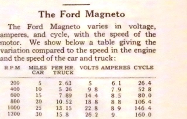

- Posts: 6592
Re: Magneto Problem
Since the car runs fine on BAT but not MAG, logically the problem is with the the MAGNETO portion of the circuit (see wiring diagram for magneto to switch). MAG & BAT use the same coils, plug wires etc. so everything from the switch to the motor potion of the circuit is the same for both. So one can assume the problem wouldn't be expected to be in that end of the circuit. Yes there is a contact difference in the switch that chooses the voltage source MAG or BAT so it is from there back to the source that the problem is expected to exist.
Again if it ran rough before the Long Beach T guys recharged it and then it ran perfectly afterwards they recharged your magneto and now after some time it runs rough again that would suggest the problem is with the magneto. So I would focus your efforts on the suggested Magneto checks above.
Here is a simple test for magneto voltage output.
