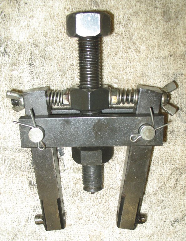

Bored or honed bushings. "racing clearance" fits. Go to the outside specs.
The clutch hub puller langs sells is a great tool.

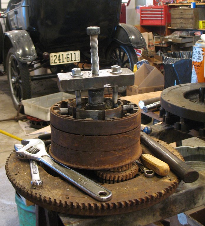

The original Ford clutch drum puller sometimes works, but a particularly stubborn drum will just bend it.
I agree the puller sold by the parts dealers is much better.
You can also make your own if you have a heavy enough chunk of steel.

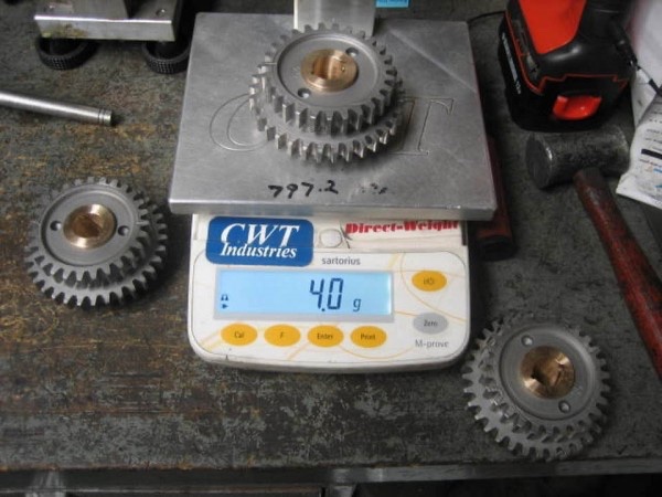

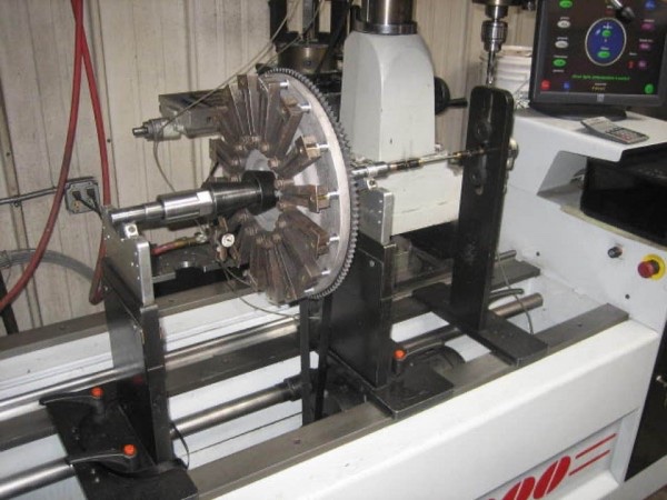

OK here is my 2 cents. I just went down this road You can see what I've done here
viewtopic.php?f=2&t=9508
My Transmission broke a triple gear pin and ended up causing all kinds of issues. The Model T is a very forgiving car until it's not. You can read all about people bandaging their car together using all sorts of trickery. Some good some bad. For me rebuilding the transmission was beyond what I was capable of.
I started researching machine shops and found J&M Machine in MA. When I brought them the transmission John took it apart and magnafluxed the drums. Two of them were cracked. The third was put on a lath so many times that it was extremely thin. So I needed new drums. Not many people make them but J&M does. Comparing their drums to the originals I could see that the J&M ones were very strong. Keep in mind that when using 100 year old parts most things will be worn out. I also got to see what a good machine shop looked like while I was there. I chose to use their drums and their services as I didn't want to do this job again.
They balanced everything and made sure that I would all work perfectly.
So were they a bit more money. Sure. Did I make an investment in my transmission so I won't have future problems. Yes!! Remember Machine work is expensive. Bad machine work is way more expensive.

Hey I’ve read thru the rattles thread. Good stuffMopar_man wrote: ↑Thu Nov 11, 2021 4:20 pmOK here is my 2 cents. I just went down this road You can see what I've done here
