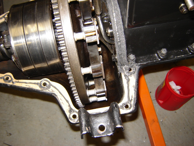

Please see attachment. Being patient with lots of good preparation will yield good results. Hope this helps,
Stu
Stu

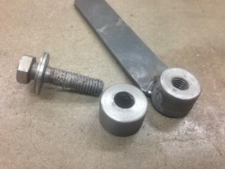

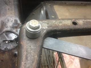

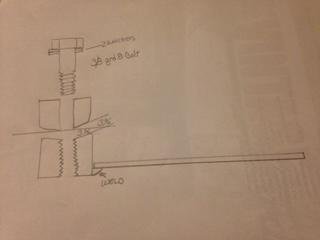

This is a tool I made to flatten the dimples in the pan from multiple attempts to stop leaks. It can be used when the hogs head is off.
Craig.
- Posts: 5269
Re: Setting the hogs head
Great idea. Smart tool!

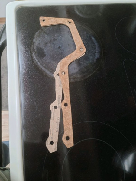

First each set of gaskets ordered in 2021 from 2 main well liked suppliers I used for years
So make sure you get good ones

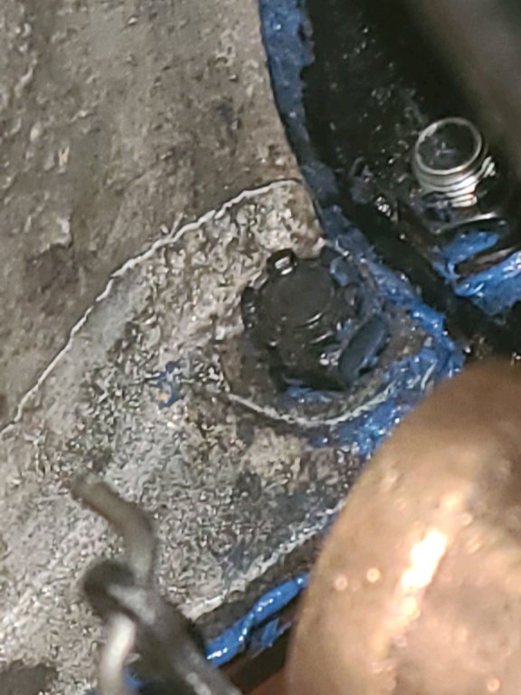

Then if you unlucky you get to do it all over again
Practice my Impressions of a drunken sailor
Yes it's repairable but luckly had another one
- Posts: 5269
Nothing "unlucky" about this, except that you had another one.
Since you took the effort to show it, for the benefit of others, as a teaching tool of what not to do, I will point them out.
1) information on the fragility of early covers is well known here. A quick google on the subject will bring up a detailed explanation of the improper thickness of the felt in relation to early hogs heads. (Original Smith) You can get away with it on the more forgiving iron covers.
2) Not any silicone is acceptable. This blue, clear, windshield or window caulk will not stand up to hot oil. Ultra black or silver will.
Those extra blue beads will soften & give your motor a case of intestinal worms. Congregating in the oil funnel. You wont know until you starved a rod.
A transmission screen may or may not add to the life of that rod.
3)Pulling down the HH is a "gentile" process of back to front. GENTILE.
4) A 110 year old, increasingly harder to find cover managed to survive, only to be permanently scarred or sent to scrap In an age where a few key strokes could have saved it.
I sincerely hope others will learn from your experience. No offence intended.
No offense taken but many T I've built have had zero issues with blue RTV
And I've owned 39 Ts to date and worked on mny more
But with the alloy hogs head one needs to be more careful in this gap area
My other hogs head went down like it was supposed to
Hogs head in the pics already been repaired and waiting
Used a pattern to bolt it down
