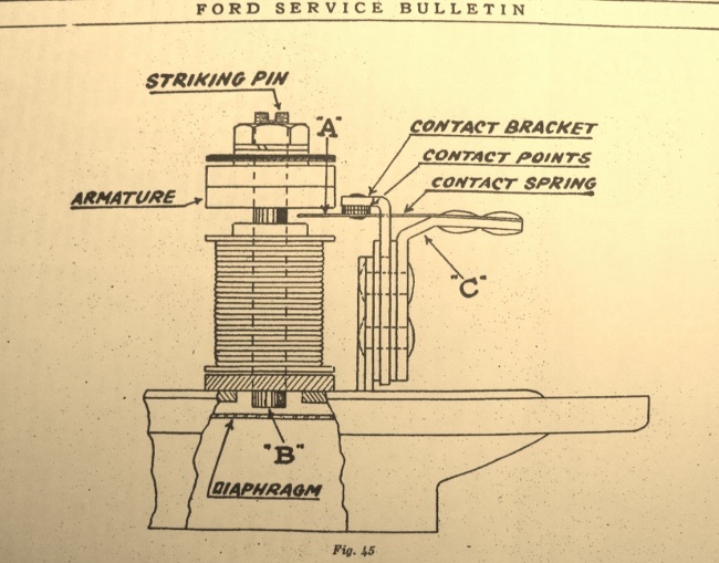

When you get to adjusting, here is the Ford Service Bulletin info:
