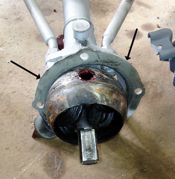

Post by DanTreace » Sat Jan 12, 2019 10:00 pm
Dry, no gasket. That gasket is placed between the 4th main cap and the hogshead.
There isn't gasket or sealant as anything there will just displace the torque tube ball cap rearward which you don't want.

Post by Oldav8tor » Sat Jan 12, 2019 10:46 pm
Sorry Dan, I guess my description was poor.... I was talking about the gasket that goes on the cap that attaches the "ball" to the fourth main on the back of the hogshead - the gasket you were referring to.
The photo shows the cap I'm referring to (arrows)

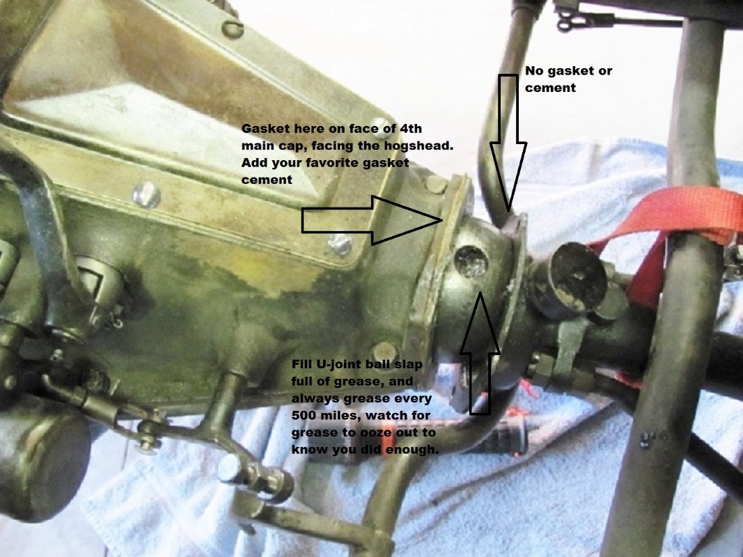

Posts: 4042
Re: Need Input
Post by DanTreace » Sat Jan 12, 2019 10:59 pm
Tim
Here you go, this should tell the info with a picture! :)
Dan (click on photo to enlarge the copy)

Post by Oldav8tor » Sat Jan 12, 2019 11:20 pm
Got it. Makes sense :D Thanks!
