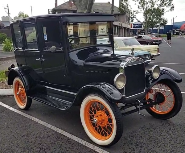

Starving for fuel, can NOT figure it out!?
Lets me start by saying I have done extensive research and also searches on this forum and many/many others with no luck. I'm reluctant to post as I love the challenge but I'm simply out of ideas.
I have a 1926 Fordor with a fresh 1925 engine. I have had it running for a few weeks. I'm running a NH carb. The engine starts and idols flawlessly. When I first started the engine I noted the intake would frost up and drip. I did not have a hot air pipe at the time. I drove the car after it was warmed up for about 15-20 minutes and it would start to sputter and then die altogether. I could get it to restart with full choke applied but once I released the choke it would die. Clearly starving for fuel. I checked several things, including seeing if the bowl had fuel by opening the drain and noted that it was full. So being new to these engines and an updraft carb I suspected it was freezing up? My best guess as after 10 minutes, it would start normal and off I could go. So I found a hot air pipe and installed it. Just like that, no more frost and I assumed problem solved. Wrong. I would again drive 15-20 minutes and same deal, cough and sputter and die. Full choke and would restart but die once choke was released. Again THE BOWL IS FULL of fuel! I wait 5 minutes and the engine would restart and off I'd go but the problem would reoccur in 10-15 minutes.
The tank is pristine clean.
The gas cap has a vent hole.
The carb is new. Float is set correctly. I changed to a float ball valve to rule out a needle valve issue. Jet is clean and correct. low/ high ports clear.
New gas line that does have a steel filter. (i've read many times these cause issues)
So it is clearly starving for fuel but yet there is fuel in the bowl? Again I know this because I open the drain and a steady stream comes out. Oh and after I let fuel out it still doesn't restart. I was thinking vacuum or vapor lock but nope.
I guess I'll take the fuel filter off and try it but I highly doubt thats it. What am I missing? Can't wait for the replies. What would change after 5 minutes that would allow restart?
Thanks very much, Angus

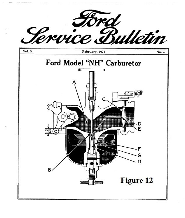

I am going to suggest that fuel coming out of the bowl is not proof that it is full. It is proof that after the car died, there was some fuel left. And every moment spent climbing out of a stalled car and fiddling to open the drain valve is time spent refilling the bowl and fooling you into believing it was ALWAYS full.
A steel filter is typically a 40 micron mesh, or .0015" hole(s) and with gravity feed, at best you are not much more than "sweating" fuel into the bowl...that filter is meant to be used on a modern car with a fuel pump.
The car will idle and run a bit as the fuel level is modestly keeping up with the consumption, but any kind of increased consumption will slowly run the fuel level lower and lower until the idle and main circuits are not sufficiently fed. Choking the carb introduces a vacuum and a "gulp" of fuel out of the bottom of the carb through the main jet, and that is why it will start but not keep running
I believe you are on the right path by eliminating the filter. After all, what needs filtering?
Once your car is running right, do not be surprised if the ball-style float valve eventually fails either full open or full closed...that is the next in line as far as failure modes.
Only thing that doesn't compute is having an NH but calling it an updraft carb (?)
You will have this thing fixed soon.

Something I failed to mention in my previous post is that an NH can digest enormous pieces of junk so long as that junk doesn't stick in the float valve. There are no "jets" as in the sense of more sophisticated carbs such as Zenith and Stromberg, so there is absolutely no reason to be running any kind of a filter that has a smaller mesh than what is already in the sediment bowl on the tank.
If, on the other hand, you are running a Zenith or Stromberg, or any other carb which has very tiny idle jets, the best thing you can do for yourself is install an old-style tractor sediment bowl with a clear bowl immediately prior to the carb as has been suggested above by at least one poster.
