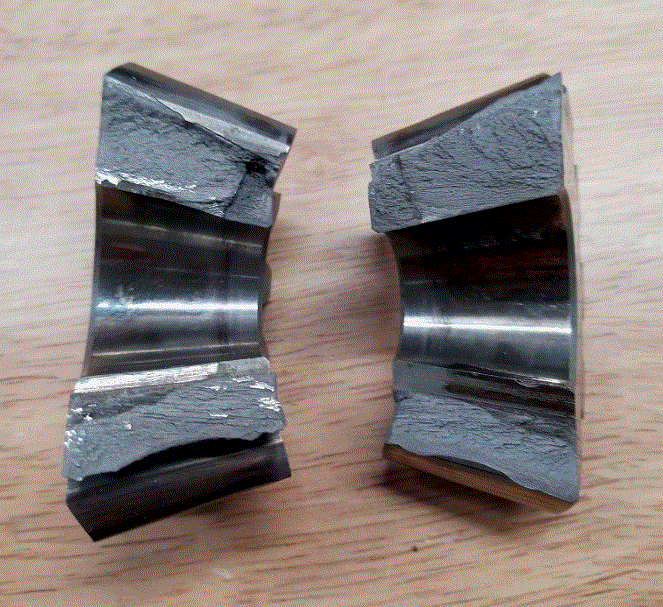

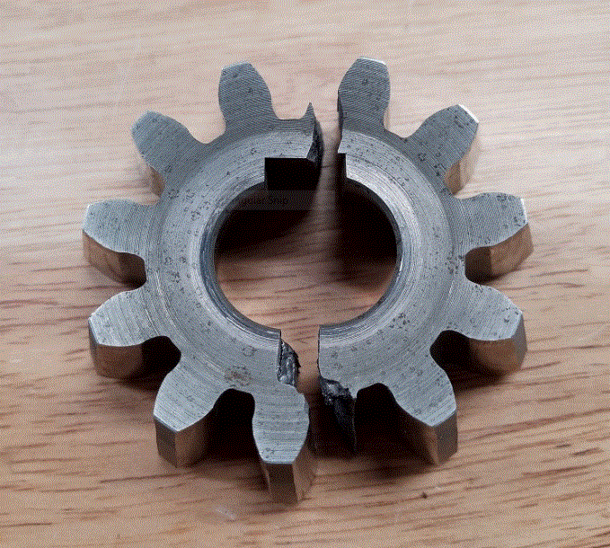

The same thing happened to me 3 weeks ago.
This is what happened to mine.
Hope yours is just a pinion key.
- Posts: 5599
Re: Differential issue, any ideas?
Ken - was that a Ford script pinion ?
Ken Lefeber
- Posts: 70
- Joined: Mon Jan 07, 2019 10:40 am
- First Name: Ken
- Last Name: Lefeber
- Location: Plymouth, WI
No.
Bought new and installed about 2 years and 2200 miles ago.
- Posts: 5599
Reason I inquired was that some pinions were made a while back with the keyway in the incorrect position - can't recall which way it was but I have enough Ford pinions to check against yours.

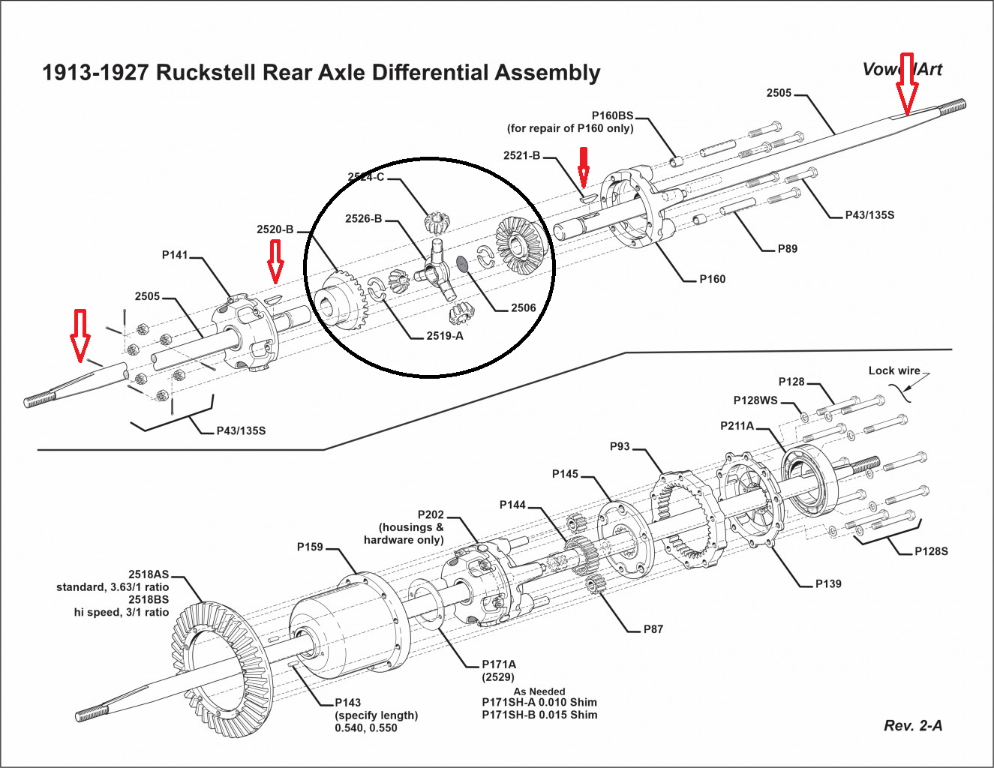

- Posts: 6592
In looking at the diagram just referencing the one as an example
If one wheel spins freely on the axle (not affecting the other side) and the axle doesn't move then... sheared hub key?
If one wheel spins freely on the axle (not affecting the other side) and the axle moves with it .... sheared Differential gear key (Axle gear key)?
If something was damaged in the spider or on the way to the u-joint ... wouldn't that make some noise and/or make one side harder to move than the other? The spider is where one wheel cause the other to rotate is it not.

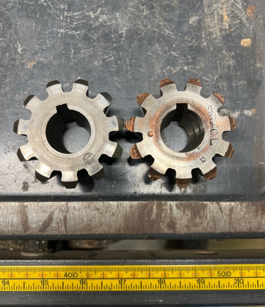

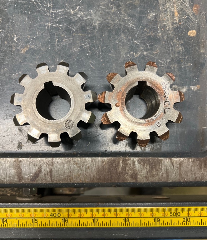

Example of keyway in wrong position. Corner of key way should be centered under gear teeth.
Left gear wrong, right gear correct. Old post with discussion. http://www.mtfca.com/discus/messages/70 ... 1496334174
Another post, which I can’t find now, concluded there were some repro gears that were of incorrect hardness.
- Posts: 5599
Thanks for posting that photo !
