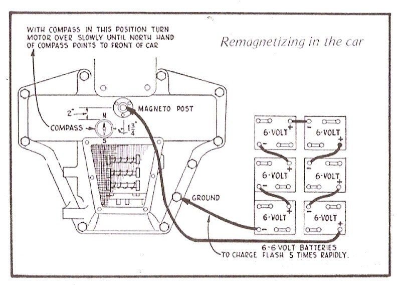

Bob. I sent you a text the other day. I have a DC wire feed welder. Looking at the diagram we just hook up ground and spark the magneto post. Maybe others can confirm.

Jim, I believe it's better to hook up the post and flash the ground. Less chance of damaging the button.

Thanks Steve. Makes sense.Steve Jelf wrote: ↑Tue Jun 18, 2024 11:45 pmJim, I believe it's better to hook up the post and flash the ground. Less chance of damaging the button.

Further to Steve's thoughts, I use a small pair of Vise-Grips to grip the nut on the top of the magneto post and connect the jumper cable to the pliers, so I don't accidentally arc on the tiny threads of the contact post. Then strike the ground to the hogshead.

First I’m not sure I’d use the mag post. I would take the mag post off, others that have used the mag post should comment. If you read the post I made prior to Jelf’s you see that I spoke to that point but as the young folks say you do you. Using a DC wire welder can be used IF YOU HAVE THE ABILITY TO REMOVE THE FEED GUN AND CONNECT ANOTHER CABLE TO the connector where the cable & gun connected. You’ll also need to remove the wire spool depending on how the wire welder works. You don’t want wire unspooling ha. Remember if the wire feed cable/gun is capable of being remove and another lead connected when turned on you are hot till the power is off.

John: For the MIG, how about disabling wire feed and making/installing a copper stud that fits the thread in the torch nozzle tip that the wire passes thru. (Remove brass bushing/install solid copper stud in torch tip.) The stud serves as the torch contact, ground clamp completes the circuit. Pulsing current is done with nozzle trigger. Has anyone tried this? jb

NO,NO,NO. Remove the mag post connector. Contact the mag lead button directly. (An old valve with some rubber hose for an insulator.) If you go thru the mag post you turn the spring into a heating element & at the very least lose the spring temper.Dan Haynes wrote: ↑Wed Jun 19, 2024 8:29 amFurther to Steve's thoughts, I use a small pair of Vise-Grips to grip the nut on the top of the magneto post and connect the jumper cable to the pliers, so I don't accidentally arc on the tiny threads of the contact post. Then strike the ground to the hogshead.
One 12V battery isnt enough. I have had marginal success with 3 12V batteries.
The Tom Carnege method is the most successful & quickest method I have seen & done. Magnet saturation is achieved in 1 strike if the field coil is good.

As an electrical expert I have to ask what position the flywheel needs to be parked at for this to work? Also please note that magnetizing happens when the current suddenly drops, i.e. stops flowing, as when you remove the connection. It should not be necessary to have current flow more than a second.

You can do the compass dance if you use the old method pictured. Unnecessary.waterloo wrote: ↑Fri Jun 21, 2024 10:05 pmAs an electrical expert I have to ask what position the flywheel needs to be parked at for this to work? Also please note that magnetizing happens when the current suddenly drops, i.e. stops flowing, as when you remove the connection. It should not be necessary to have current flow more than a second.

Look @ the magnet keeper screw ends, they must be centered in relation to the mag post. Either method.
Easily seen with the inspection cover removed. That centers the magnets over the charging coils.
You are correct, one quick strike does the job. 2 or 4 doesn't improve the charge using a hi amp DC arc welder.
But we just cant resist. More is better?? Not here.

The in-car charge will work (I've done it with batteries), but recharging is best with the magnets off the flywheel, one at a time (I've done that too). I'd go with the in-car charge until there's some other reason to dig in deep.

If the coil spring is turning into a heating element, you are holding it way too long and you need to learn to flash the connection. If the spring is glowing red as John says, the solder between the individual coils (which melts at a far lower temperature than red-heat for steel) will be found in a puddle at the bottom of the crankcase and the cloth insulation wraps burned off the copper coils.speedytinc wrote: ↑Fri Jun 21, 2024 8:56 pmNO,NO,NO. Remove the mag post connector. Contact the mag lead button directly. (An old valve with some rubber hose for an insulator.) If you go thru the mag post you turn the spring into a heating element & at the very least lose the spring temper.Dan Haynes wrote: ↑Wed Jun 19, 2024 8:29 amFurther to Steve's thoughts, I use a small pair of Vise-Grips to grip the nut on the top of the magneto post and connect the jumper cable to the pliers, so I don't accidentally arc on the tiny threads of the contact post. Then strike the ground to the hogshead.
