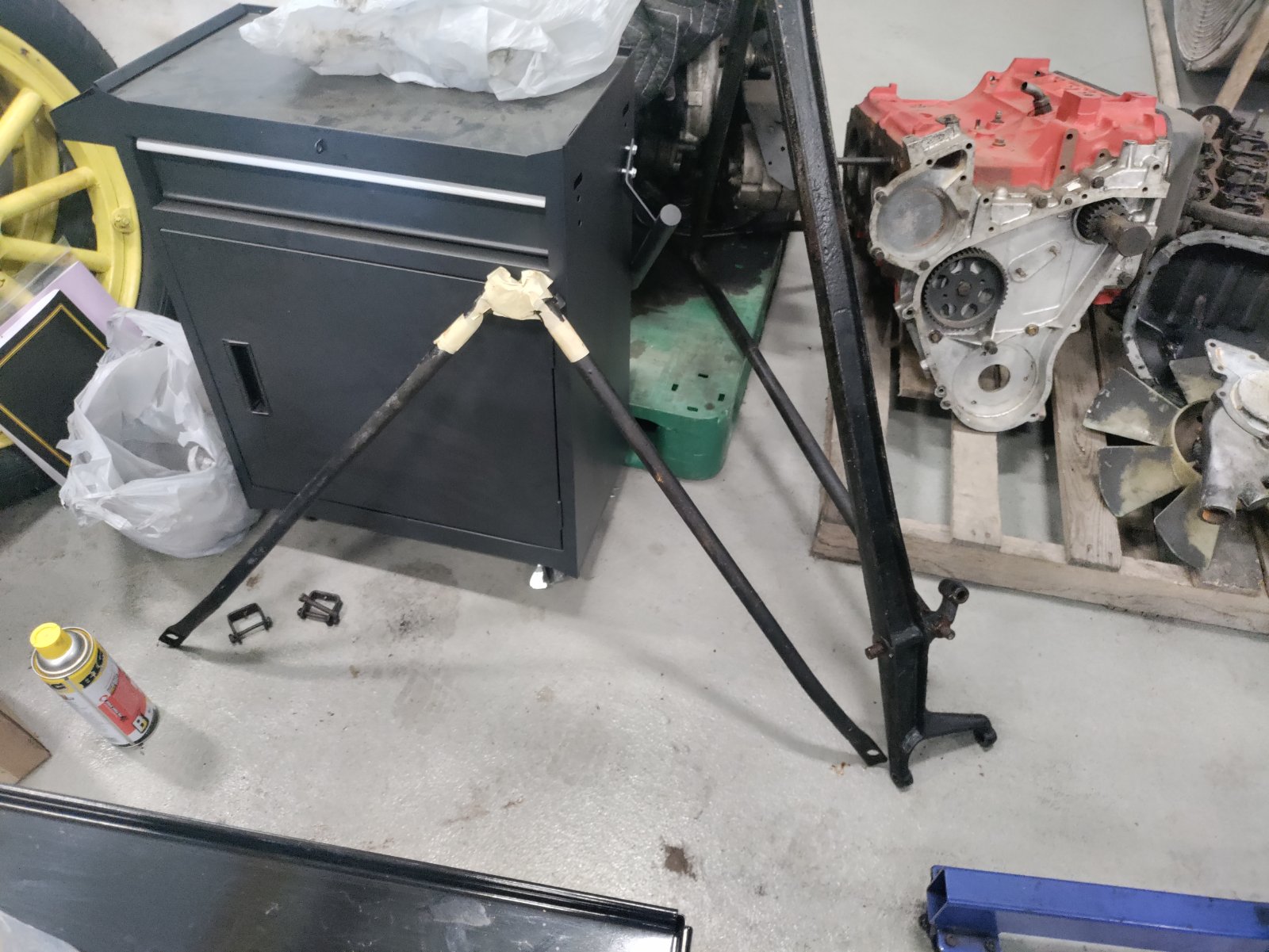

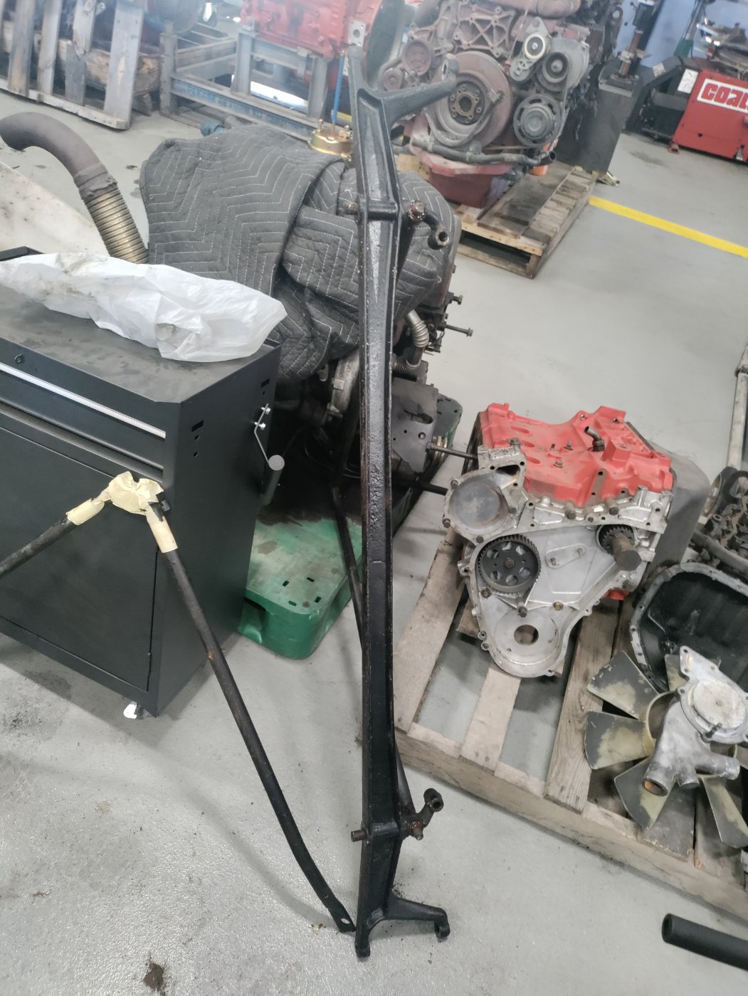

The ball is quite malformed, I wanted to remove it to see what k can do, I think there's a weld on replacement, also it should be the earlier style (I think) but I got the more common later style with the lower supports, actually one is loose in the bracket, if I tighten it up it becomes a tad shorter of the other one, what should I do about that, I didn't remove the rod, but from what I can see it looks fine thread wise on the rod.

Lucas, the U bolts for the early type spring mounting are not available new, so you will have to source some good used ones. To use them on a 9 leaf spring would require them to be 1/2' longer than standard. I have never seen such U bolts. A photograph may help identifying just what you have. Perhaps they are aftermarket hand made items.

I don't know if the pictures are good, but as yok can see the ball is bad, I tried to get one of the threads its bad on the wishbone on a side the the lower half with the tape o font know how to adjust because I e is loose but if I tighten it it is shorter than the other. The u bolt may be stripped on one side but since I'm taking 2 leafs off, the damage will be raided just above the nut and I can re use it since the threads below are fine. Thanks everyone who replied this far I appreciate any help I can get.
