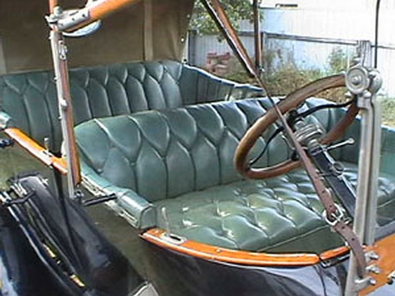

Here are some more pictures before the restoration. I'll report back here in the forum later. Thanks for your feedback.
Regards, Anton
Regards, Anton
- Posts: 1645
- First Name: Dennis
- Last Name: Seth
- Location: Jefferson Ohio
Re: special valve-question
Beautiful car.
The license plate numbers in the painting match the license plate numbers in Antons's photo and the car looks very similar.

Allan: Yes, it really is a nickel beauty, as you described. On the exhaust valve plate, you can see Holden and an N. The valve spring retainers have a split keeper. It's now certain that this is the T from Bob Chantrell in Adelaide. I compared the license plate number on the painting Kerry posted with the photo I also posted. They are identical. Many thanks to Kerry for the painting!
