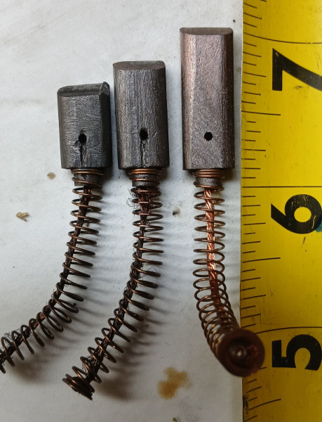

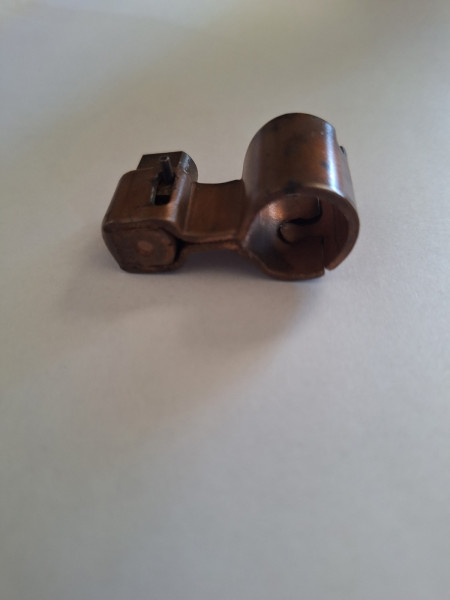

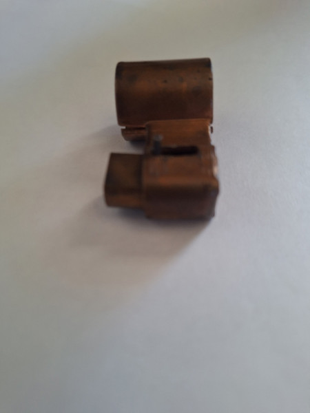

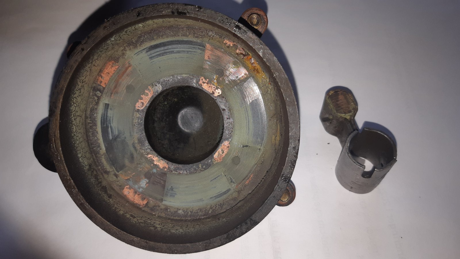

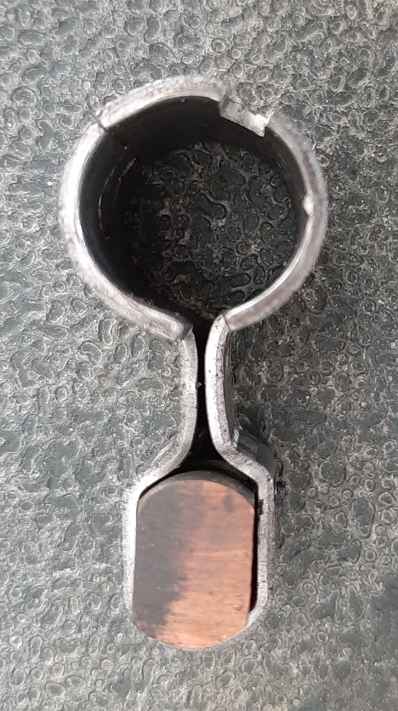

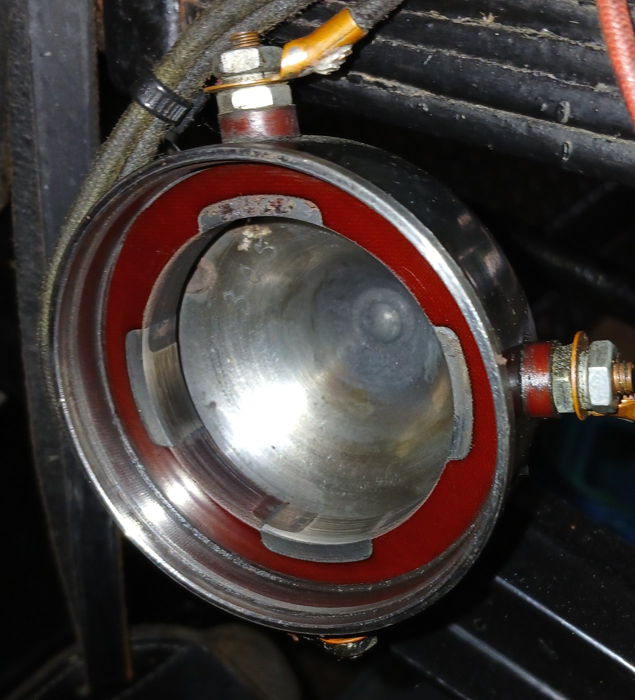

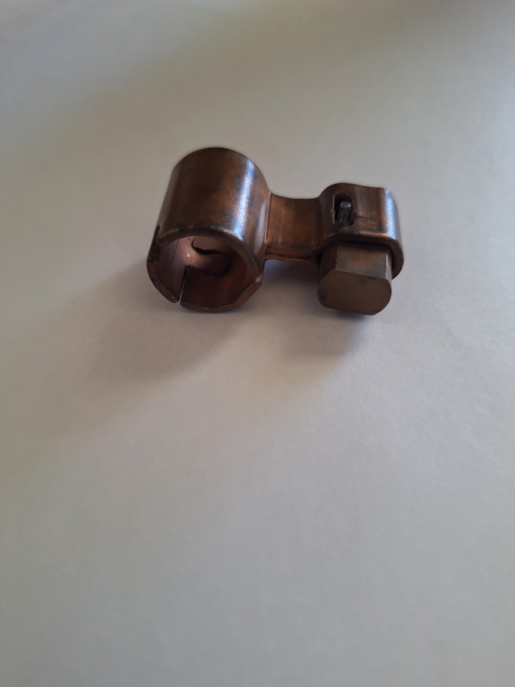

About 2+ years ago I installed a reproduction New Day timer assembly on my '26. Yesterday while wiping out the housing, I observed what you see in the attached photos. I was shocked. My best guess is there's only about 1000 miles since the timer install. Looking for opinions or any applicable advice.
Thank you,
Peter

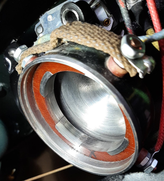

Out of curiosity, what does the “race” look like in the timer body ?
Over 62 years ago I ran a used New Day in my first T. Great timer ! I fear that the reproduction units don’t equal the quality of the originals, especially the fit of the bronze brush in the rotor. I believe the originals were self-lubricating graphite bronze - the reproductions are not.

There have been many discussions of New Day timers over the years, often with detailed pictures. You can spend a lot of time with Mister Google reading about these timers, but it all boils down to a couple of points. 1 There's New Day and there's New Day, sometimes excellent and sometimes miserable. Unsurprisingly, the miserable ones are reproductions. 2 In recent years the Tip Top Timer reproductions from Spokane have enjoyed a reputation for being excellent.
Even people who know their stuff can mess up, so it's possible you got a defective Tip Top brush. More likely, it's somebody else's repop. If you contact Mark, perhaps he can sort out your situation.

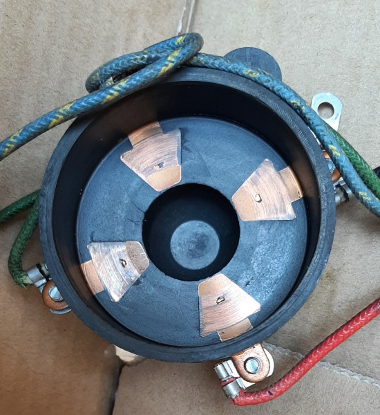

Post by 2727 » Wed Aug 06, 2025 3:11 pm

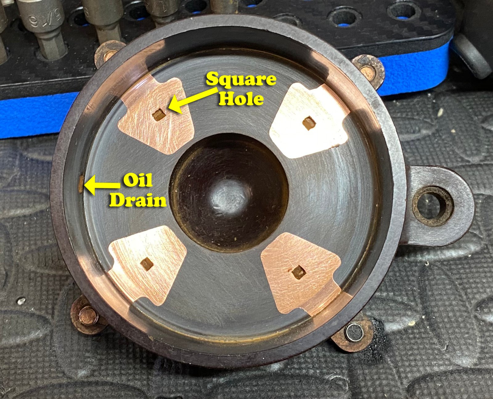

Though I did not photo the housing, it looks Ok in my opinion, smooth all the way around. I have cleaned it previously and there was quite a lot of "dust" which I just attributed to the brush and cap breaking in. I purchased a spare brush a while back which I installed today. I'll keep an eye on it. I do feel the brush in the replacement seems to slide in and out more freely than the former.
Peter

Post by 2727 » Wed Aug 06, 2025 3:30 pm
The timer in question came in a Tip Top box which I still have. The box has a date 1/13/2021. The replacement brush was purchased 2/13/2024. That's all minor info. I'm just going to keep a close eye on things.
Peter

There is a discussion about the brass vs bronze brush material. Yours looks like brass.
viewtopic.php?t=11075

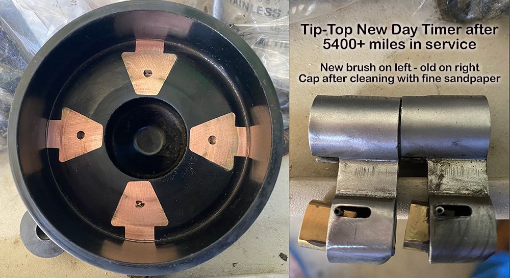

I have also experienced great success with the newest style of reproduction New Day timer offered by the T parts vendors.
I’ve been running one on my speedster for several years and have only noticed some minor wear and requiring very little maintenance.

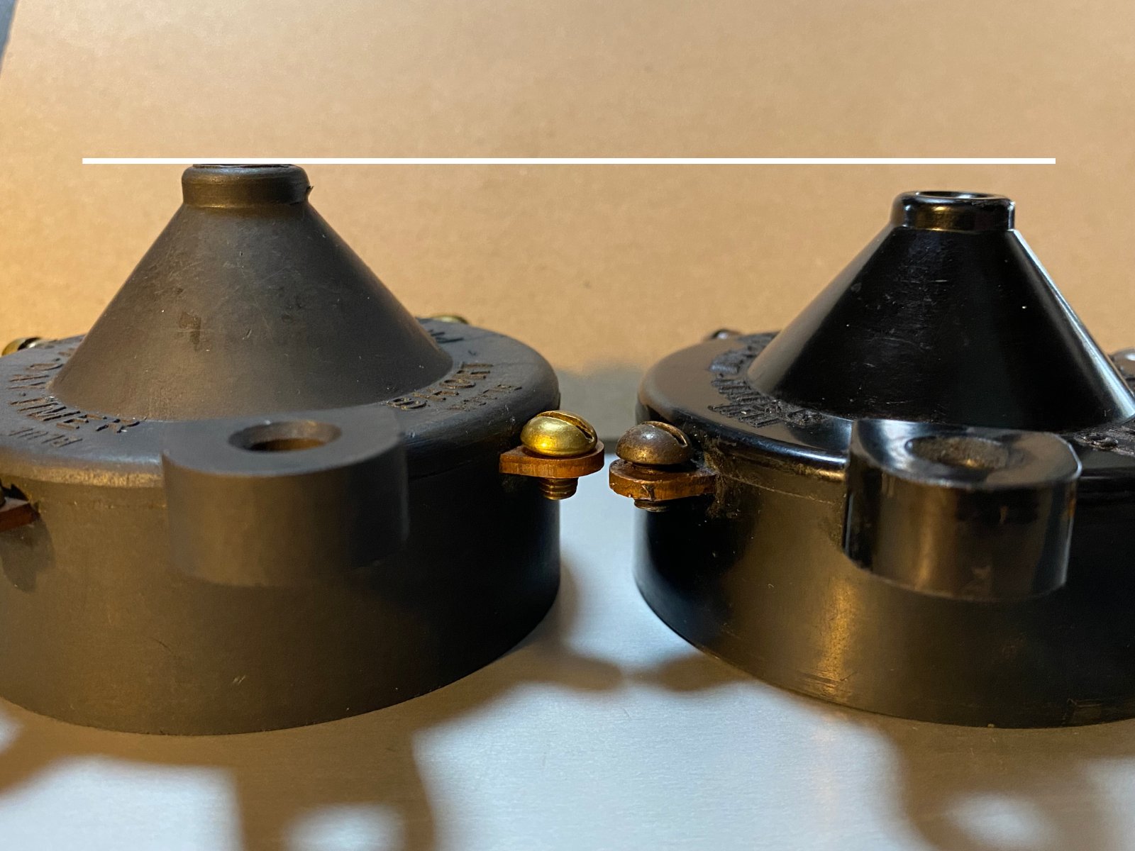

Timing cover is centered with the correct tool. I also measured the depth of the timer housing and the distance from the timing cover where housing sits to the outer edge of the newly replaced brush holder. Did not check dimension with problem brush. The difference is 1/8 inch which I feel is enough but not too much. Camshaft seal is modern style, no felt, no brass washer, no oil leak at camshaft. Coils all rebuilt and adjusted by Ron Patterson.
Peter

Sounds like you did everything right. It certainly is a mystery. One thing I do to the brush is round the leading edge of the brush slightly thinking that it will reduce brush and cap wear as it spins. Does it make a difference? No idea.

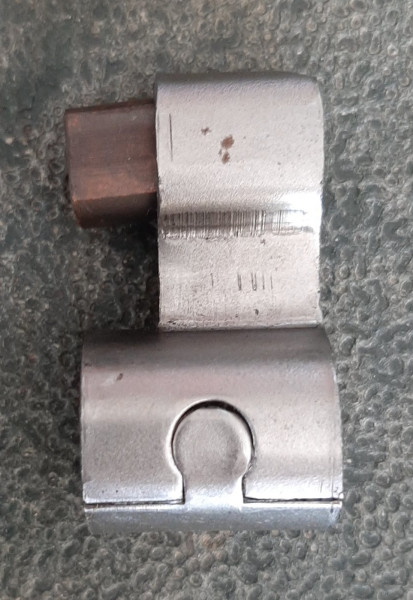

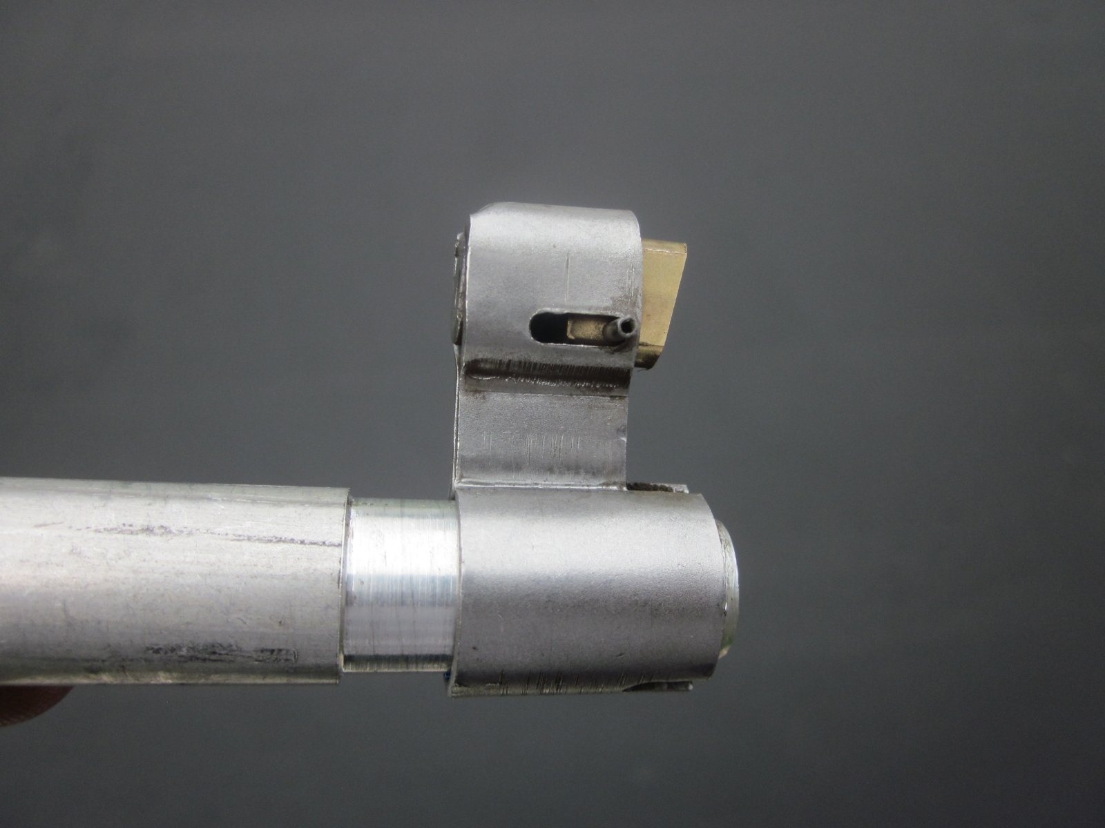

Shall we complicate the discussion? Some people will take the defective brush out of the rotor and toss it, and make a new one from an old generator brush. Apparently if you have the skill to make a good fit, it works pretty well.
Posts: 5033
First Name: john
Last Name: karvaly
Location: orange, ca
Re: New Day timer brush question
Post by speedytinc » Thu Aug 07, 2025 3:34 pm
Steve Jelf wrote:
Thu Aug 07, 2025 3:06 pm
Yes it does. I have done several score this way. Zero wear to the timer body ever. Make the fit just enough to freely move.
The brush cant cock like OP's example.

Post by 2727 » Thu Aug 07, 2025 4:29 pm
Making one's own brush sounds interesting to me. I think I am capable but don't have a brush. Going to a flea market this Sunday maybe I'll find one. Thanks for the Idea.
Peter

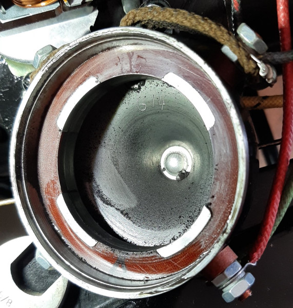

Post by dykker5502 » Fri Aug 08, 2025 2:23 pm

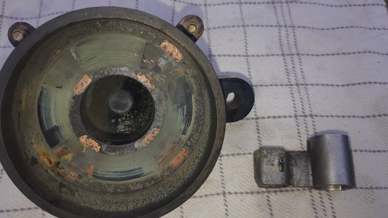

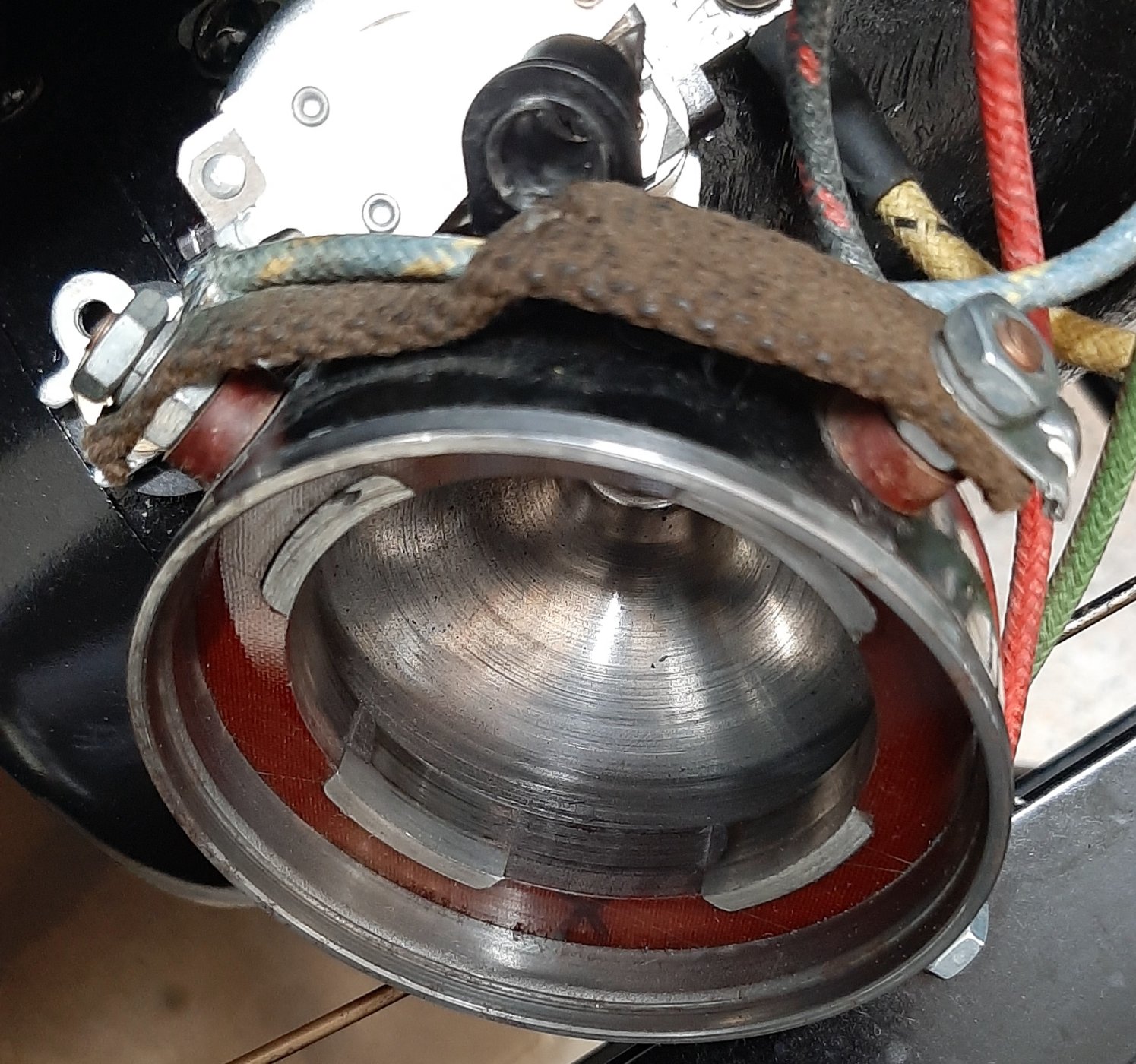

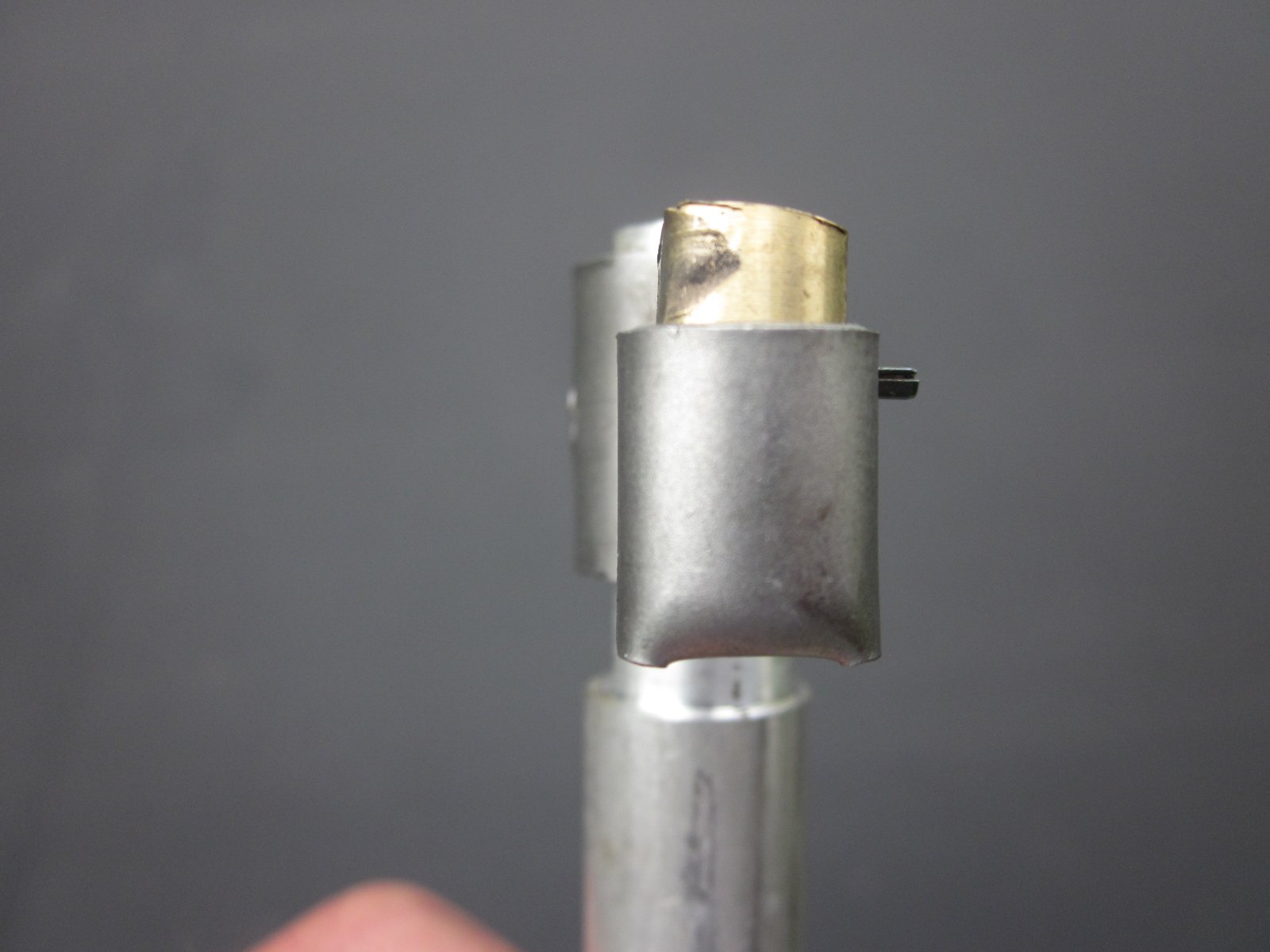

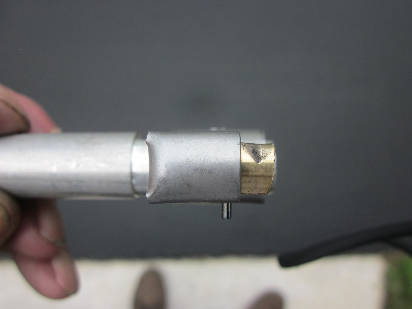

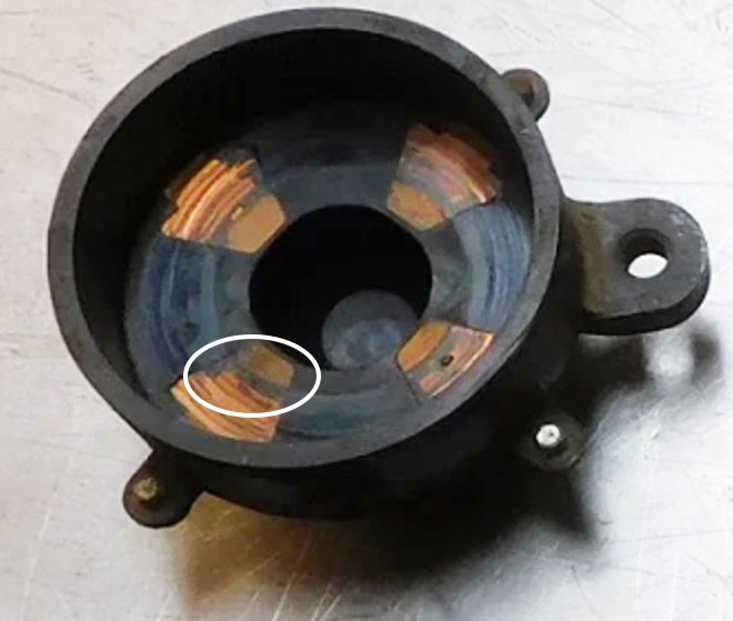

Lots of interesting points as I a couple of years ago bought a New Day timer expecting a maintenance- and trouble free operation. After all to few kilometers my brush looked like the one in the first entry:
ECCT adjusted coils and normally running on magnet. I cleaned up the timer to make sure it was smooth and clean and bought a new rotor with same result after few kilometers again.
Now I run the original type roller timer on all T's. I have though considered as Steve mentions make new brushes with Generator/starter brush material (not solid metal).
Ford Model T 1914 Touring
Posts: 5033
First Name: john
Last Name: karvaly
Post by speedytinc » Fri Aug 08, 2025 2:43 pm
Your brush is worn down to where the brush holder has rubbed/scraped the contact face. That grey stuff is ground phenolic.
For this to happen the brush is mounted too far out. The brush holder should not be able to contact the face.
You probably have too much forward cam thrust movement & a possibly thicker timing gear thickness from a non stock gear.
I would guess that as new, the timer body "danced" with each revolution. You would need to solve the issue(s) to run a new day.
Otherwise, a roller timer would work better for you, as it is not as particular to in & out location/movement of the roller.
New day timers dont work in every situation or fix other problems.

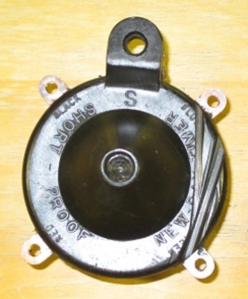

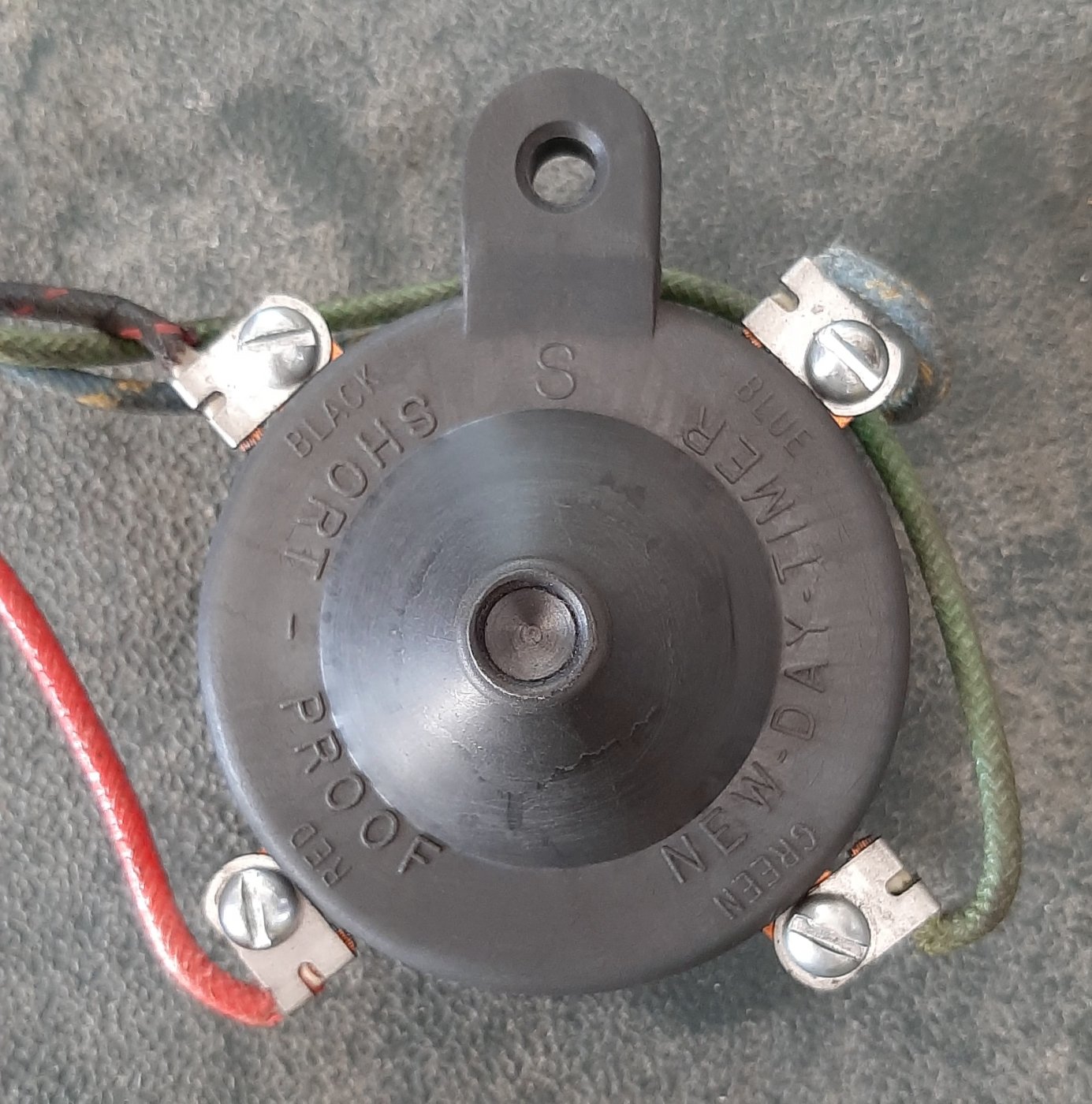

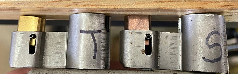

I'm curious about the history of infamous 's' branded New Days. When were those around? Were they made by the same outfit as today, just using a better recipe for the plastic?
Posts: 2310
Last Name: Juhl
Location: Thumb of Michigan
Post by Oldav8tor » Sat Aug 09, 2025 12:36 pm
"S" caps were sold by Snyders, before my time. That said, they still turn up on cars and at swap meets. They are made of a softer plastic and stand a little taller than they should. I've seen a couple with grooves cut into them by a fan belt as a result. The interior surfaces of the cap wear quickly leaving "bumps" where the contacts are that accelerate wear on the brushes as well. They can be identified by the "S" visible below the hole. They were not made by the folks from Tip Top timers. The "good" caps are made of a bakelite-like material. Hard and rigid. While we're at it, if you're at a swap meet and want to know if you're looking at an original cap, the little holes in the contacts of an original cap are square (second photo.) I've run an original cap on my car for a few thousand miles and compared it to a Tip-Top. The Tip-Top holds up as well as an original....maybe slightly better.
For what it's worth, one of the worst reproductions of a New Day is the "Best" - it really wears quickly. See how the plastic has been scraped out between the contacts. The debris piled up on the bottom edge is plastic. (Photo three)
From my comments you may think I'm a New Day nerd. Truth is, one came with my car and I've seen no reason to change. I collected the information I'm sharing from a "Shop Talk" I gave at the Piquette Ford Factory Museum in Detroit last year.
Eric Sole
Posts: 137
Joined: Mon Jan 07, 2019 4:25 pm
First Name: Eric
Last Name: Sole
* REQUIRED* Type and Year of Model Ts owned: 1927 Roadster
Location: Barcelona, Spain
Post by Eric Sole » Sat Aug 09, 2025 2:07 pm
Tim, you posted “For what it's worth, one of the worst reproductions of a New Day is the "Best" - it really wears quickly. See how the plastic has been scraped out between the contacts. The debris piled up on the bottom edge is plastic.”
I assume you are referring to the marking on the original Snyder’s packaging:

I bought this New Day timer from Snyder’s in 2005 and drove 500 miles with no troubles until the transmission broke and the car was laid up for years during the repairs/restoration.
These are pics of that timer and brush as removed from the car:
My timer shows no appreciable wear after just 500 miles, but after reading about how the “S” marked units were prone to failure, I bought a TW timer, which is working fine.

How come no one has posted a picture of an original New Day timer brush?
Posts: 3868
Location: Lomita, California
Post by Original Smith » Sat Aug 09, 2025 2:50 pm
I just measured the distance across the face of a NOS New Day timer brush, and it is 7/16". I don't have a newer one to compare it to.

Eric,
Snyders may have sold the "Best" but I don't think they made it. I will admit some ignorance of it's history.
If you look at the picture of your "S" cap you can see the beginnings of plastic being pushed up over the contacts and on the face of the brush. Look back at my picture of a Tip-Top with 5400 miles on it. The contact margins are clean.
Below is a picture of a "S" cap showing more plastic migration.
I've also included a photo of an original and "S" cap viewed from the side. See what I mean about the "S" being taller?
Perhaps I should explain that I don't consider myself an expert on the New Day timer or any other. I'm simply sharing my experience and research...you can draw your own conclusions.
Eric Sole
Posts: 137
First Name: Eric
Last Name: Sole
Post by Eric Sole » Sat Aug 09, 2025 4:15 pm
Tim, you are the New Day timer expert in my book.
I now see the beginnings of the plastic being displaced on my timer, and that on a unit with so few miles on it! Makes me glad I popped for the TW timer.
I appreciate your observations and sharing your experience.

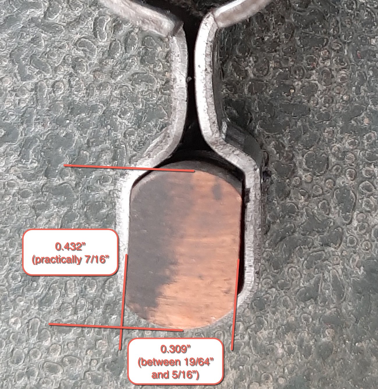

Post by Eric Sole » Sat Aug 09, 2025 4:34 pm
Here are the measurements of the Snyder's brush sold 20 years ago.
Eric Sole
Posts: 137
First Name: Eric
Last Name: Sole
Post by Eric Sole » Sat Aug 09, 2025 4:35 pm
Oh, and the new brush extends out 1/4".

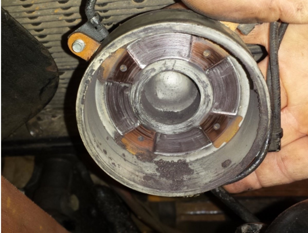

Post by Eric Sole » Sat Aug 30, 2025 6:37 am
Thanks for your info on the TW timer. The brush wear comparison is interesting.
My engine is still in break-in stage, so running is constantly improving. I just cleaned the dust out of my TW timer, and I could swear the idle is smoother now.
Here is the timer cleaned up:
As you can see, the brush has been running right at the forward edge of the timer. I removed 1mm from the back of the brush holder so it is closer to the engine now and while it is not completely centered on the segments, it is now more centered.
Don't know how important it is to have the brush completely centered on the segments?

I have no idea either re having the brush centered completely on the segments but lets face it, it can't hurt. Was a good idea to shave the brush holder down a bit. Some seem to need it, others don't. Critical to long brush wear is definitely a well tuned set of coils.
And yes, it no doubt runs a bit smoother after cleaning, I've seldom noticed it "telling me" it's time to clean it, I just clean it at every oil change, in fact I'm going to do that to mine this morning as I changed the oil the other day and didn't have time. It's still been running smooth as silk....as always.
Posts: 8195
Post by TXGOAT2 » Sat Aug 30, 2025 10:18 am
A coil or coils that are out of adjustment and drawing excess current will dramatically shorten the life of any timer. Bad coils can wreck a timer in a very short time.

Post by love2T's » Sat Aug 30, 2025 11:05 am
FWIW...as mentioned above..I cleaned the TW timer on my '13..usual carbon dust...no wear on the 4 metal contacts nor the micarta ring. Over 18K miles on this timer and for comparison here's a new brush next to current brush installed new this spring with already 1932 miles on it. I always get over 4K miles on a brush with plenty room to spare. I can even mount the timer on the block without the little wire that Tony (RIP) designed after a few originals were out there. Its easy with a little practice.
New on left..current one in use after 1932 miles.

Larry Smith asked me to post these here. Copper plated.
Posts: 3868
Post by Original Smith » Tue Sep 02, 2025 12:18 pm
I don't understand why Tip Top makes the brush a larger size? Any ideas?
