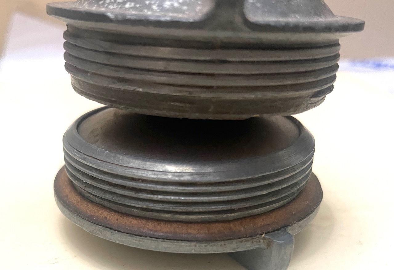

Posts: 4056
Re: 26/27 fuel tank cap
Post by DanTreace » Thu Oct 16, 2025 11:28 am
Old 24/27 gas caps may not be a bargain.
Obtained this one with one ear gone, thought ok still can work.
But after purchase found that the old zinc metal had swelled at the threads and someone must have used a flat file to reduce diameter. Problem is that flattened the threads so won’t fit at all. Maybe a thread file could restore?
Will. If you want this old one to try to fix to fit, email me your snail mail address and it’s yours. Dan
Old cap on top, new repro on bottom.
Adam
Posts: 1602
First Name: Adam
Last Name: Doleshal
Location: Wisconsin
Post by Adam » Thu Oct 16, 2025 11:59 am
Take it if it is free !
Easily fixed by slowly working into the threaded hole from an old gas tank with a little thinned lapping compound.
