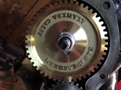

Here is a possibility that John and I discussed. See the photo of the 2 gears, which for all practical purposes are new, due to the rebuild. Note that the dimple in the brass timing gear and the alignment mark on the Scat crank are aligned, as they should be. Have any of you ever run into the situation where one of the spots got “mismarked” during factory production which could put “perfect timing” “one notch away from perfect timing”? A single notch could possibly effect TDC to the point of a "misfire", but not one that a human can feel. Has anyone ever had that situation? Not me, that I know of anyway.
I’m fortunate in that I have access to an exact replica ’27 Tudor (but the replica has a stock crankshaft) that runs very well and with me being a parts swapper, if a defective part is suspected, such as a timer, I simply borrow a known good part from the other car. Timers have been swapped, BTW.

If you think the timing gears are marked or made wrong then do a check called "degree the cam"
It takes some effort and is a lot harder on a complete assembly than doing it during the rebuild.
If the camshaft timing is off it will effect performance which you said was good.
I am not thinking this is not likely the issue but check it to eliminate it off the list.

That timing mark on the bronze gear is inline with the two dowel holes. I’ve seen other bronze gears that have the timing mark one or two teeth over to the right from your picture. I guess it depends on the timing needs of the particular engine build and set up. I agree with double checking the exact camshaft timing position you need for the particular engine against the mark that is being used now. Here is an example of a bronze gear with timing mark in different place than yours currently.
