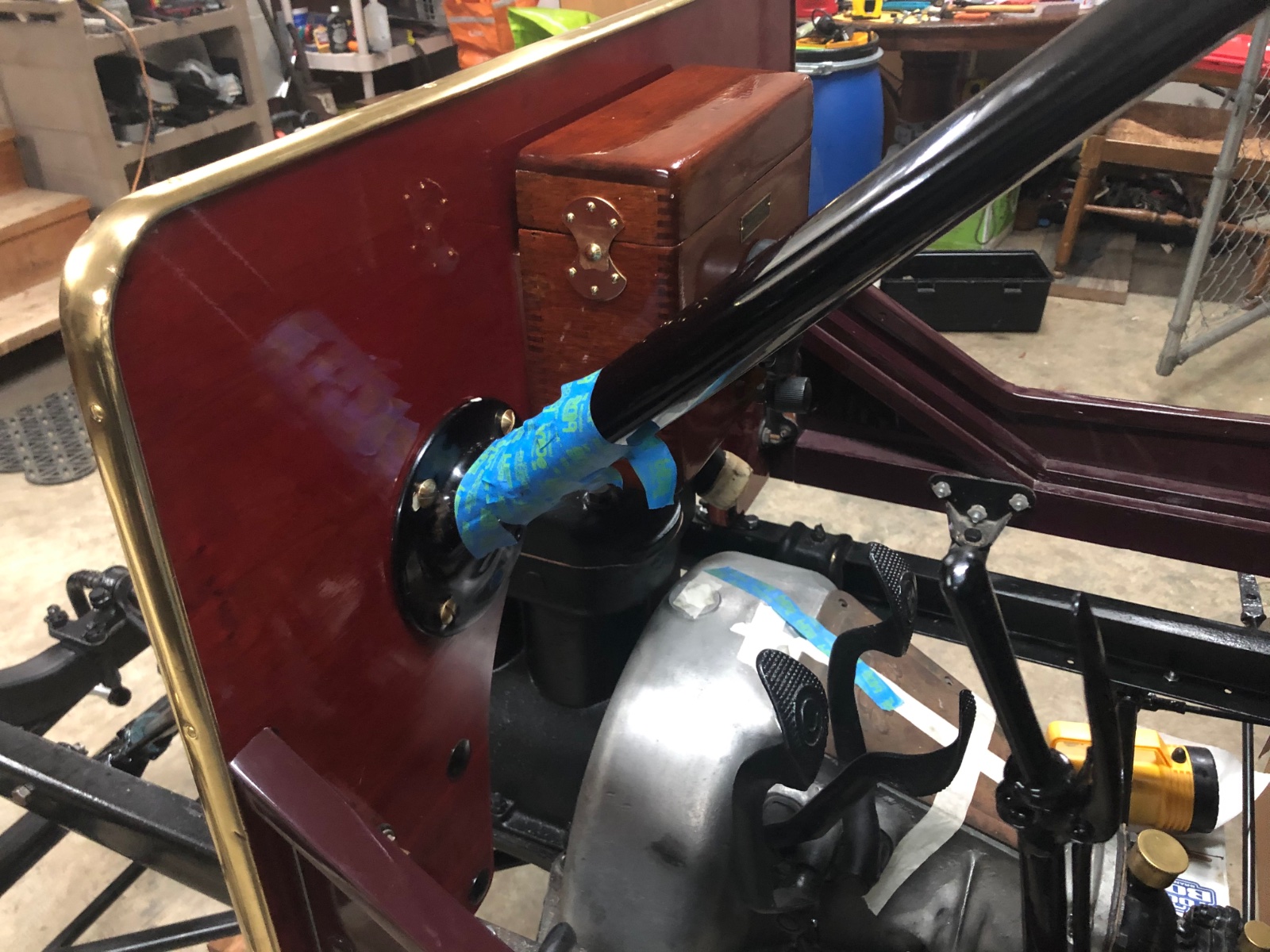

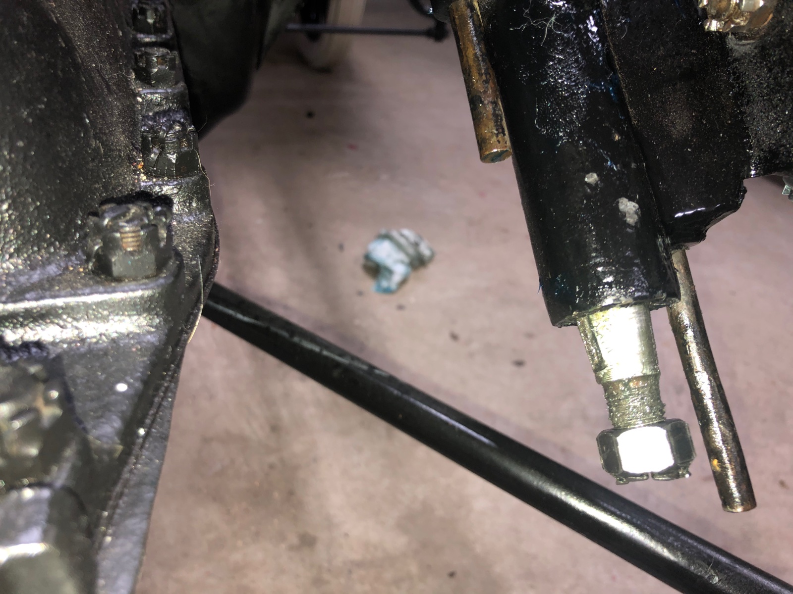

Post by Art Ebeling » Fri Nov 08, 2019 6:33 pm

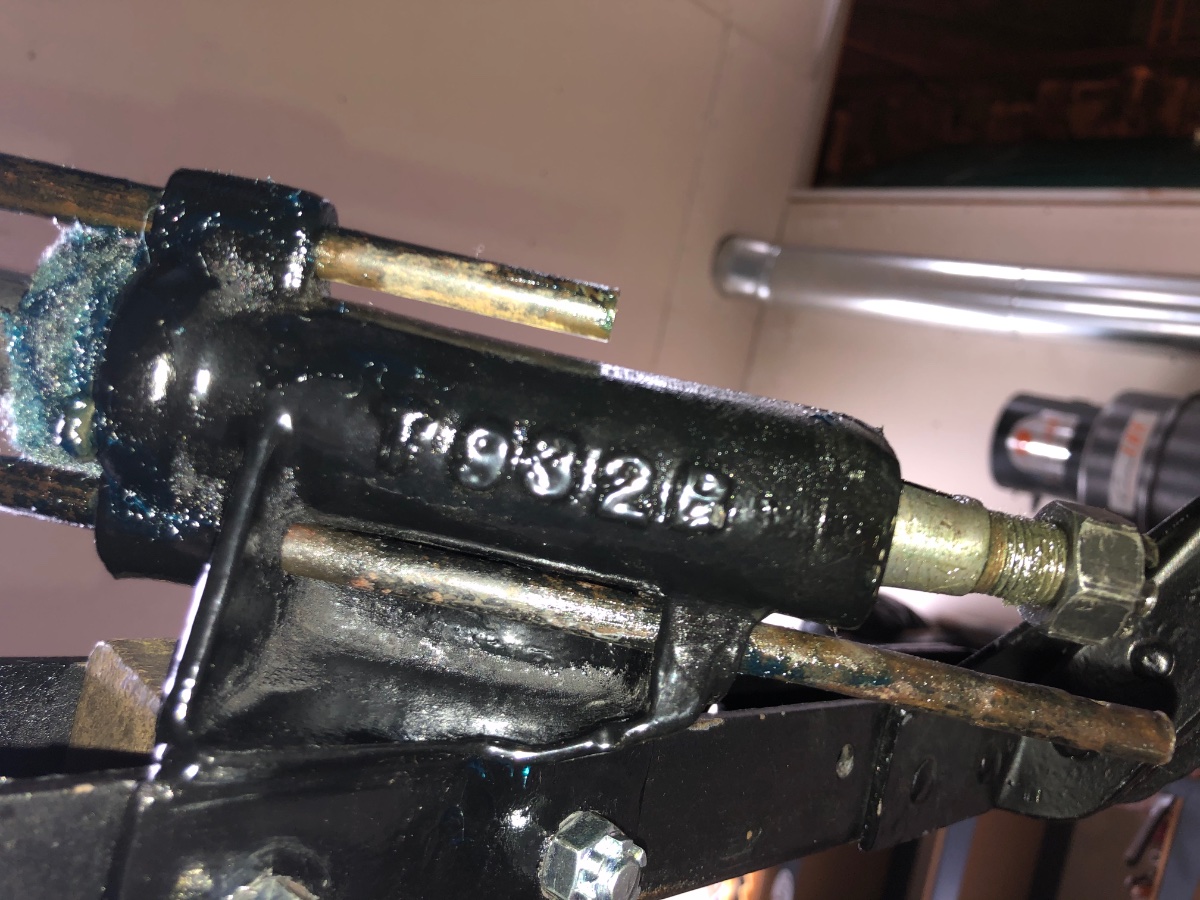

I put my steering in the 11 today but it doesn’t seem to have enough sticking out the bottom of the steering bracket for the pitman arm to tighten up on. The top of the shaft in as far as it will go. What is wrong here? Art

Post by Scott_Conger » Fri Nov 08, 2019 6:36 pm
Art
are you sure you've got the right firewall brackets and the firewall is in the correct position?

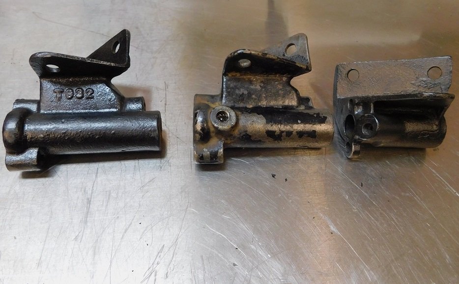

I’m more concerned about you having the correct frame-to-steering column bracket. Ford made a half dozen different ones for Ts. What part number is on that bracket?

Was the steering column a complete unit when you got the or are you assembling it from what’s supposed to be correct parts.

Did you change the steering gearbox? I fought this same problem on a 1927 touring car with a steering tube and gearbox that came from two different steering columns. My final solution was to trim off the end of the tube to get the steering shaft to fit the way I wanted it to.

The bracket is a T932B which should be correct according to Royce's article. The steering column and shaft were one unit when I got the car. Art

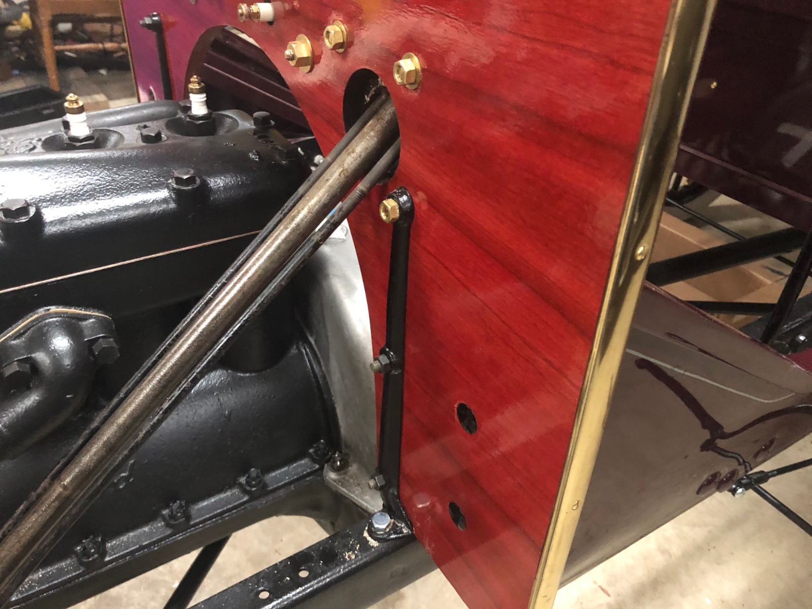

Don't shave the bracket! From the looks of things, the spark and throttle rods are long enough. You would need to shave too much off the bracket to make things fit. Do you know whether these parts came off the same car before it was disassembled? I would suspect the shaft is too short because everything else seems to fit correctly. Only other thing I could suspect would be the position of the firewall on the chassis.

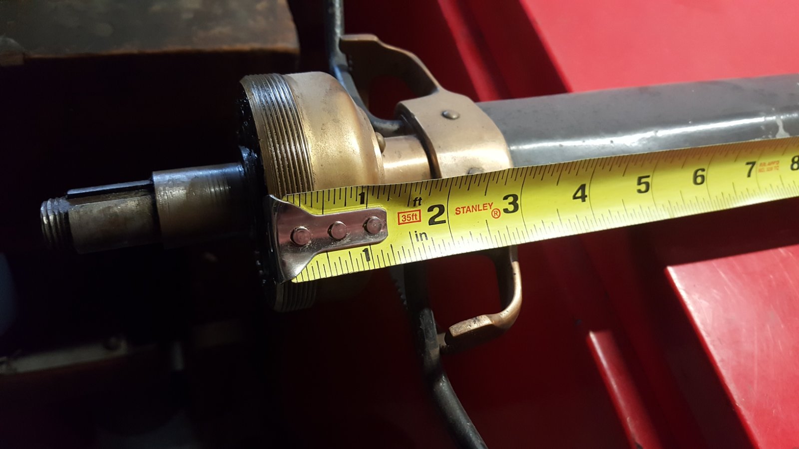

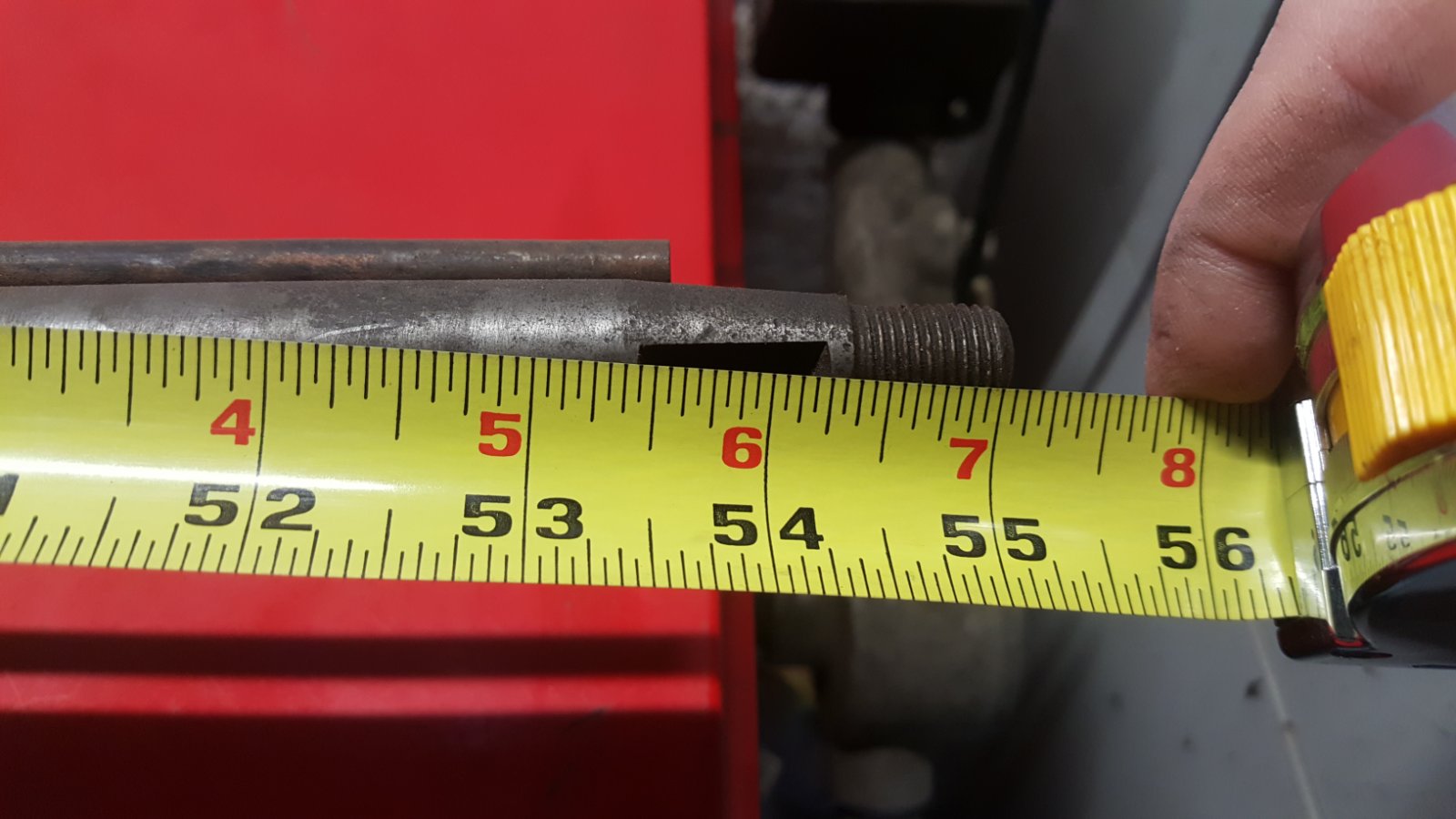

Post by Walter Higgins » Sat Nov 09, 2019 9:09 am

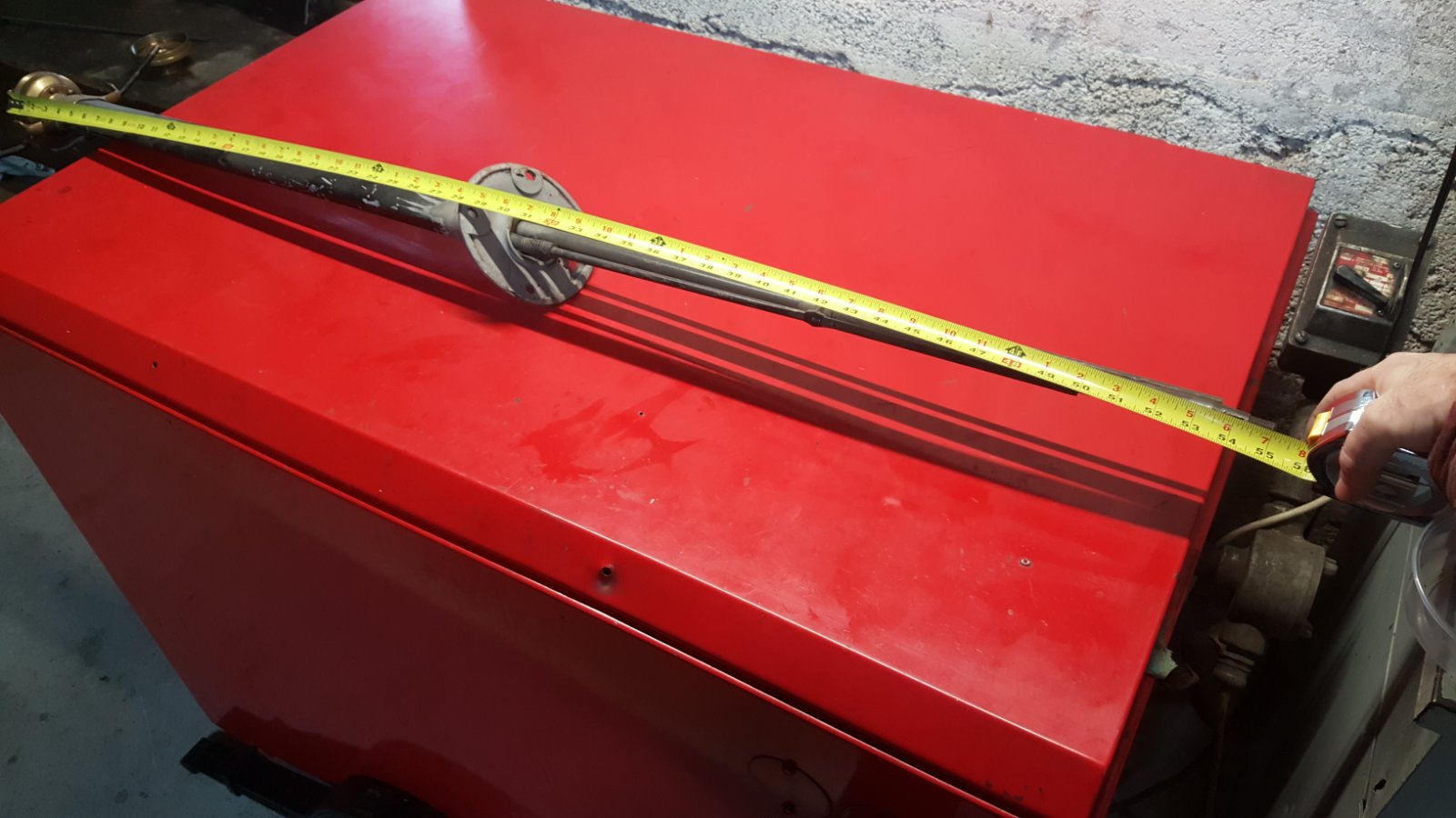

Attached are photos from an unmolested 56" 1912 column. The steering shaft should be the same length. Clipping your tape to the top of the steering case and going over the flange should be a valid datum point if you measure yours the same way that I did there. Obviously, you'll need to remove the unit from the car and take the bracket off the bottom.
The very top of the key slot is 53-7/16". The taper starts about 1/16" above that. How much difference is there between this one and yours?
For a second reference, with the gear case cover screwed on you will measure 56" from the flange that the steering wheel butts against to the very end of the threads on the shaft.

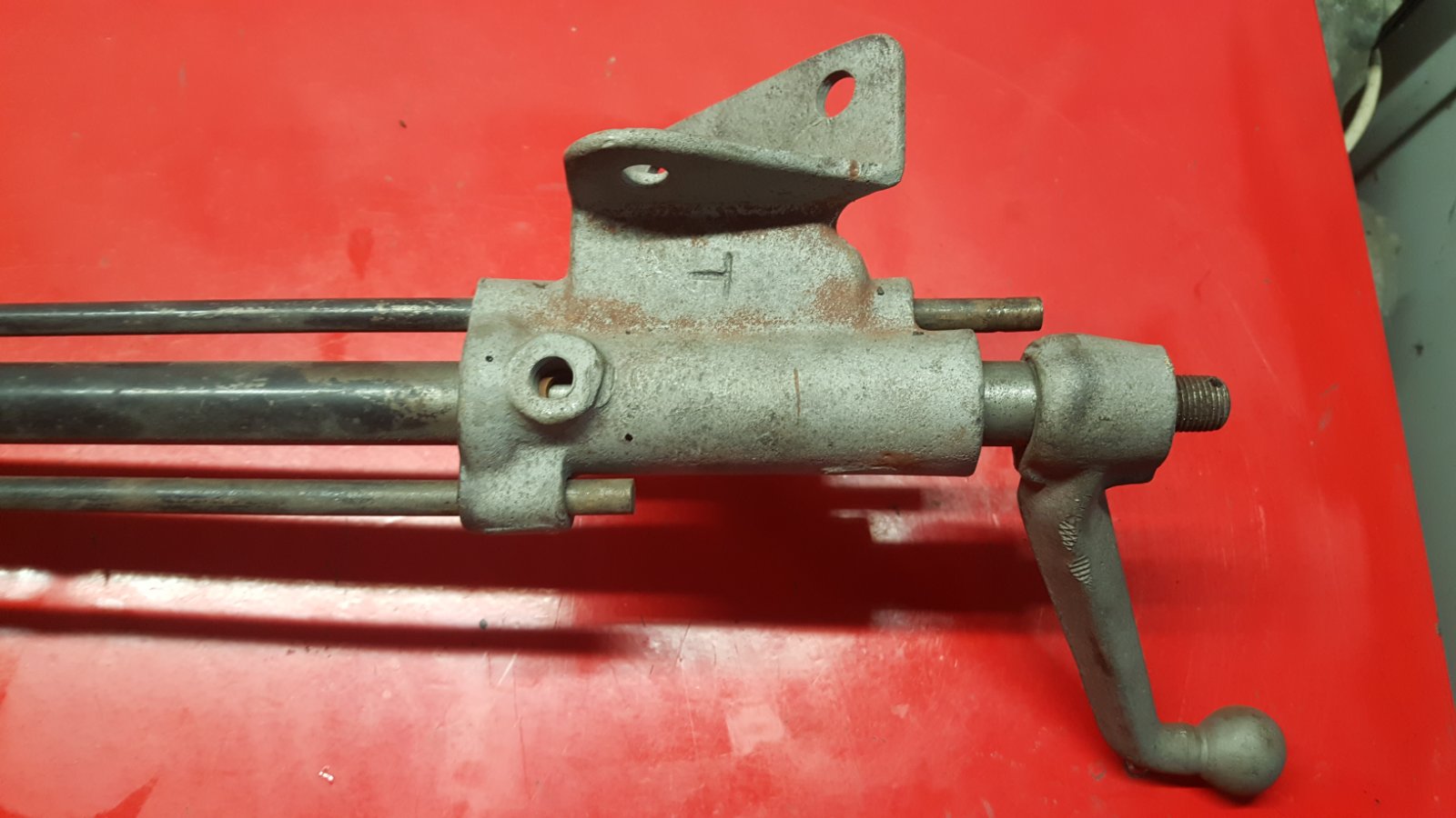

Compare the position of the spark and rod ends on yours and Walts set up. Your rods extend beyond the end of the main shaft much more than his. Unless your shaft is not seated in the gear case, your column and levers are not matched to the shaft.

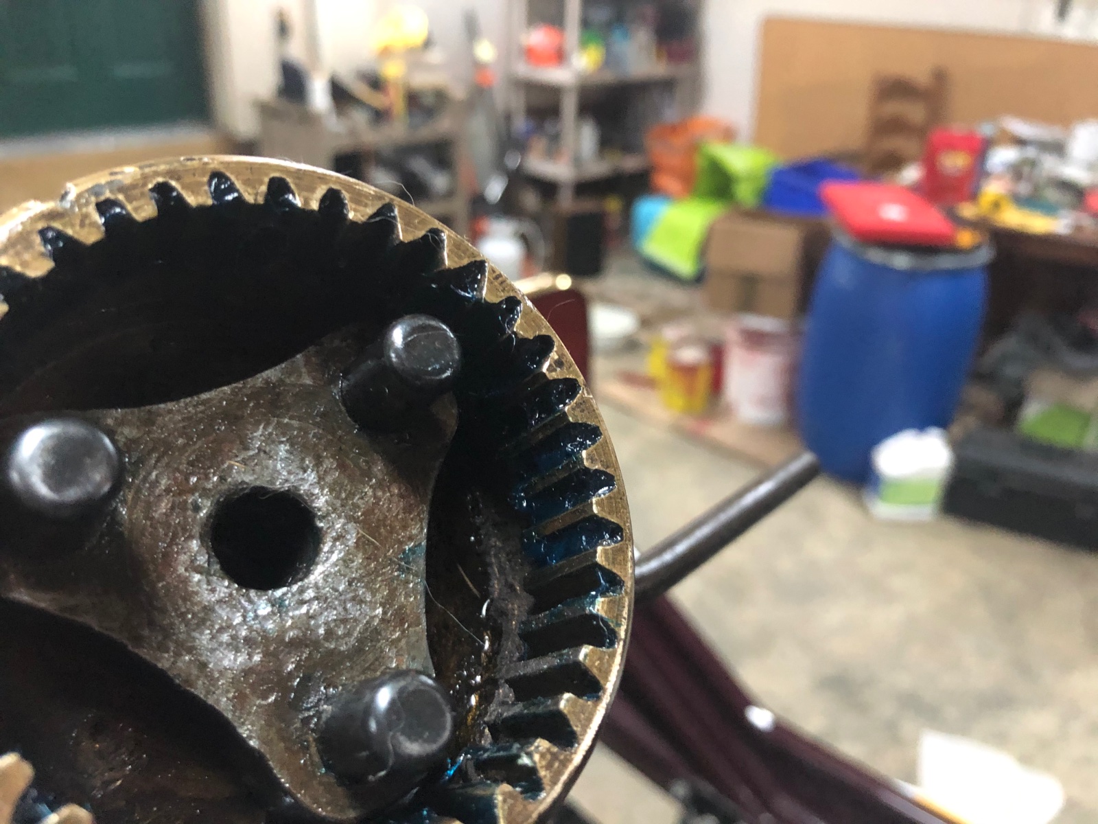

Post by Walter Higgins » Sat Nov 09, 2019 9:55 am
rgould1910 wrote:
Sat Nov 09, 2019 9:38 am
Very good eye!
Here is the column with a few parts thrown on the end for reference. The bracket is pushed back the right distance as measured off an assembled car.

I think I have the wrong steering shaft and will look for another. At the same time I may get the repro brass throttle and spark rods but I’m just not yet comfortable with taking it all apart. I have read Royce’s article several times. Thanks, Art
