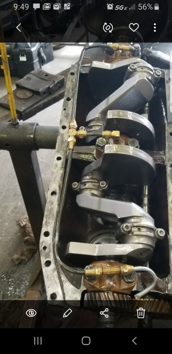

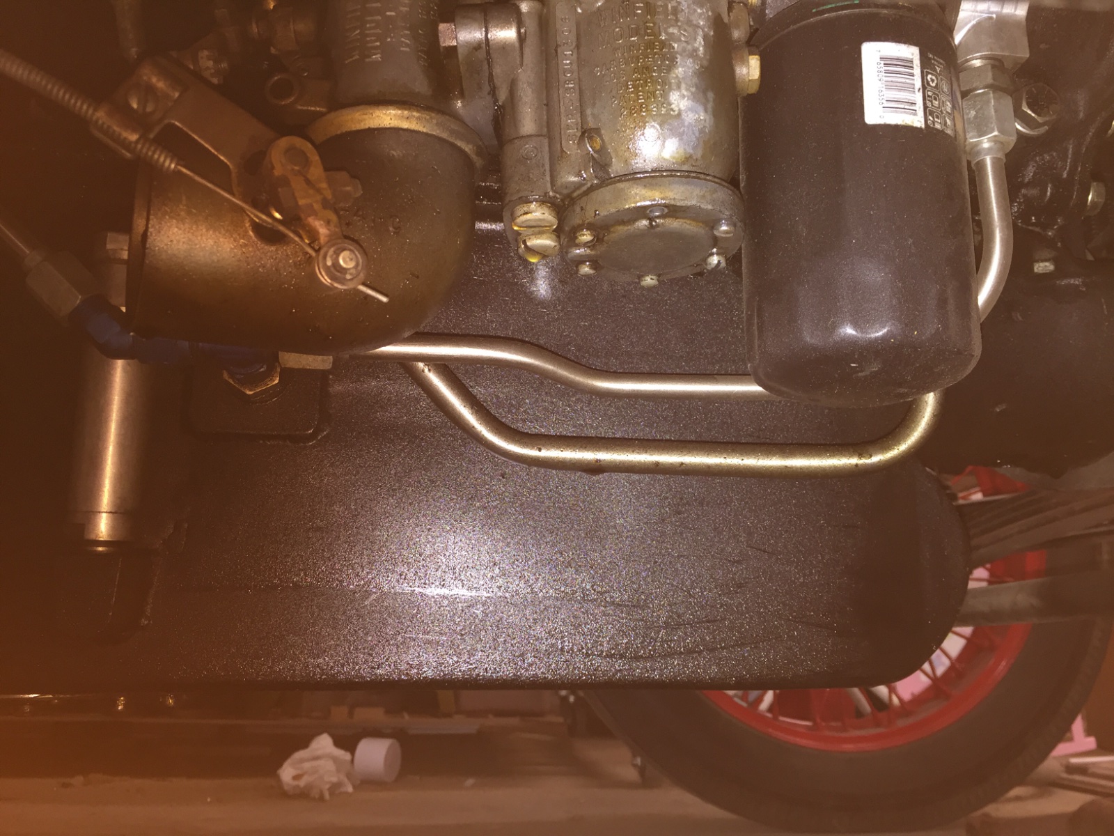

Post by Kevin Pharis » Thu Feb 06, 2020 10:59 am
A couple of pics...
