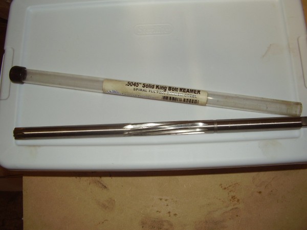

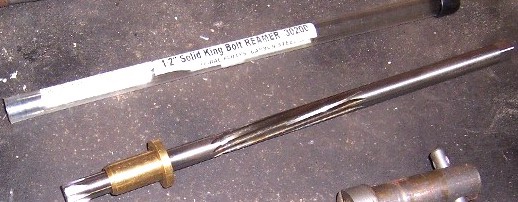

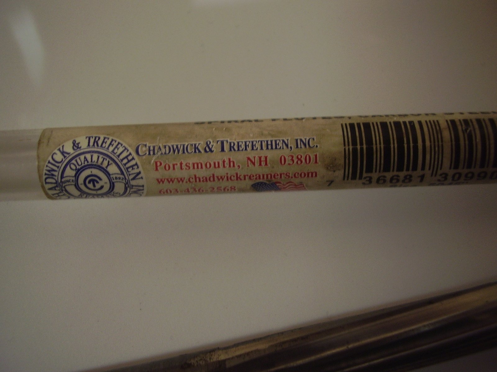

R.V.Anderson
- Posts: 680
- First Name: R.V.
- Last Name: Anderson
- Location: Kennedy, NY
Re: Adjustable kingpin reamer??
A hone is great, especially for high speed bearings such as the transmission drums, but if you want a kingpin reamer, here is what I have and use. The early (later '09 through later '14) spindle bolts that I make are exactly to Ford specs, except for the added oil groove, and they need the 0.504" reamer. Mine was made by Chadwick & Trefethen, who have been in business since the late 1800s I believe. It has a proper pilot and is the proper length for the job. Seems to me I paid about $125 for it 6 or 7 years ago, not cheap but I didn't have to mortgage the farm to get it. Should be well within the means of a club for its tool crib.

- Posts: 6798
RV
that is precisely the reamer I use when I install your Kingpins. Both the reamer and your product are excellent. You're right...the pilot is the perfect size for "as installed" bushings, to bring them to correct final size.
As far as honing, if you have the equipment or access to it, or just have the extra $$ you wish to spend with someone, Sunnen or Sunnen-type do a lovely job. The problem is, you cannot tell the difference between that and a properly reamed job, either in fitting to the car, or in driving the car. My reamers are cheaper than a hone and are a one-time investment. I spent the bulk of my career lapping/honing and super-finishing gas bearings to straightness and roundness to millionths of an inch...I have no bias against hones. In fact when you need it, they do far superior work to reamers...it's just that you don't NEED it to do kingpins. If they're your tool of choice, have at it with no beef from me.

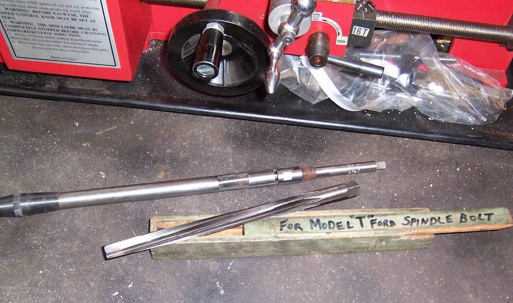

- Posts: 4084
Years ago used this USA made Critchley type adj. reamer with pilot to do spindle bushings, and an old used one-piece too.
These did only fair work. Are kept in the remembrance tool drawer.
Now....the very best results are from Lang's offering, this tool is just made for fun task of a correct and satisfactory job well done.
