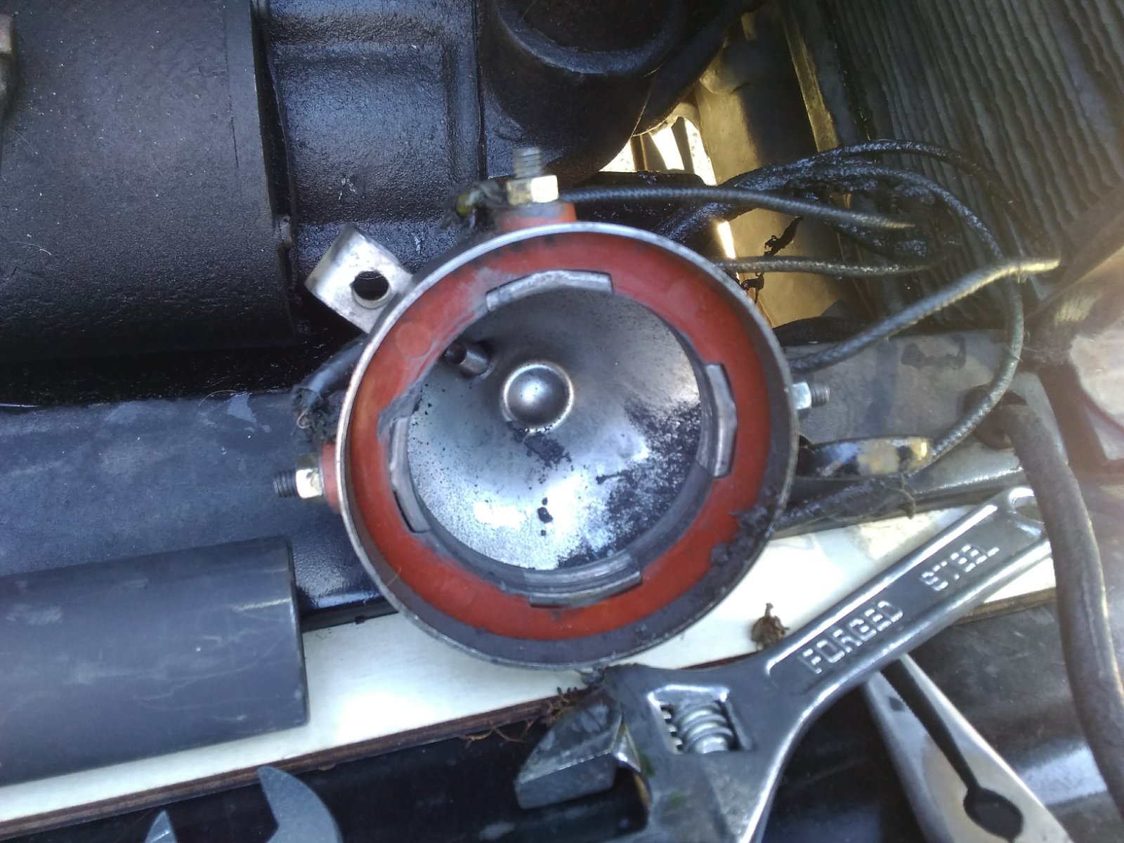

Re: model T problem
Posted: Sun Feb 23, 2020 2:54 pm
by Mr man
That's my timer. The guy I bought the t from replaced it before. He says a tiger brand timer. I pulled it off and noticed a nut was very loose. Could this be part of the problem?
Re: model T problem
Posted: Sun Feb 23, 2020 3:04 pm
by Oldav8tor
The nut that holds the brush on the shaft? In a word, "yes" it could cause problems if loose. Also check that the contact surfaces are clean.
Re: model T problem
Posted: Sun Feb 23, 2020 3:15 pm
by RajoRacer
It's a Tiger and a later imported repro, at that - orange colored insulator is how to tell from a vintage Tiger which has a maroon insulator.
Runway/raceway looks a bit funky also.
Re: model T problem
Posted: Sun Feb 23, 2020 3:23 pm
by Mr man
What is the runway/raceway?
Re: model T problem
Posted: Sun Feb 23, 2020 4:06 pm
by RajoRacer
It's where the roller runs around in a circle. That needs to be very smooth - no ruts or bumps or ?
Re: model T problem
Posted: Sun Feb 23, 2020 4:07 pm
by RajoRacer
Oh, what nut was loose ? A contact wire terminal nut or the roller retaining nut ?

One of the 4 nuts on the outside that holds on the wires was loose
Re: model T problem
Posted: Sun Feb 23, 2020 7:36 pm
by Mr man
It was the contact wire terminal bolt was loose. Oh, and the timer had a bunch or crud in it, so I cleaned it out and put it back on and put in a newer plastic coil, and now 2 coils buzz every once in awhile.
