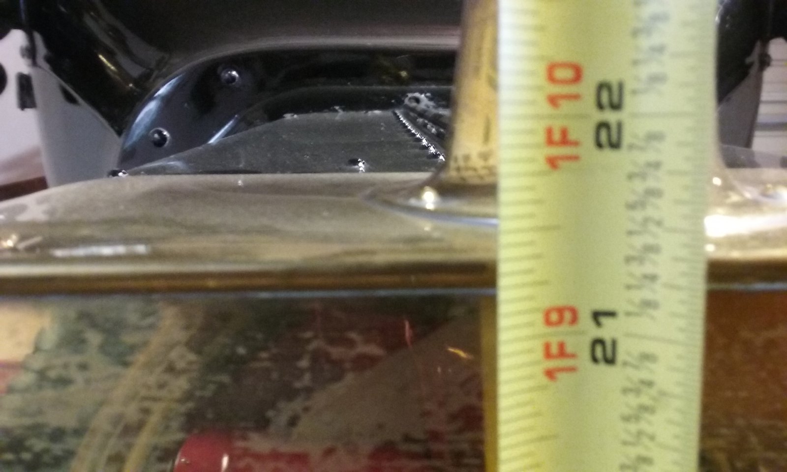

I've got 21 3/8th in my 1915.

21+" sounds about right for a brass radiator. You will note the difference between the number I gave for the low black radiator(17-23) and that number. The 15 to about 18, the radiator sat on leather pads only under the mounting ears. Then from about 18 up there were springs in cups in the mounting ears. Depending the crush of the springs, the measurements can vary.
I would think a better measurement would be from the top of the frame rails up which would be a little more hard to get with the shell in place. Chris list both a 1915 and a speedster in his profile and the avatar shows the speedster from the rear.

My 15 is a brass radiator.

Thanks guys, EXCELLENT! I keep seeing '15 speedsters and they always look a lot lower than the black radiator ones. I had no idea that the brass radiators were THAT much lower. Positive proof.
