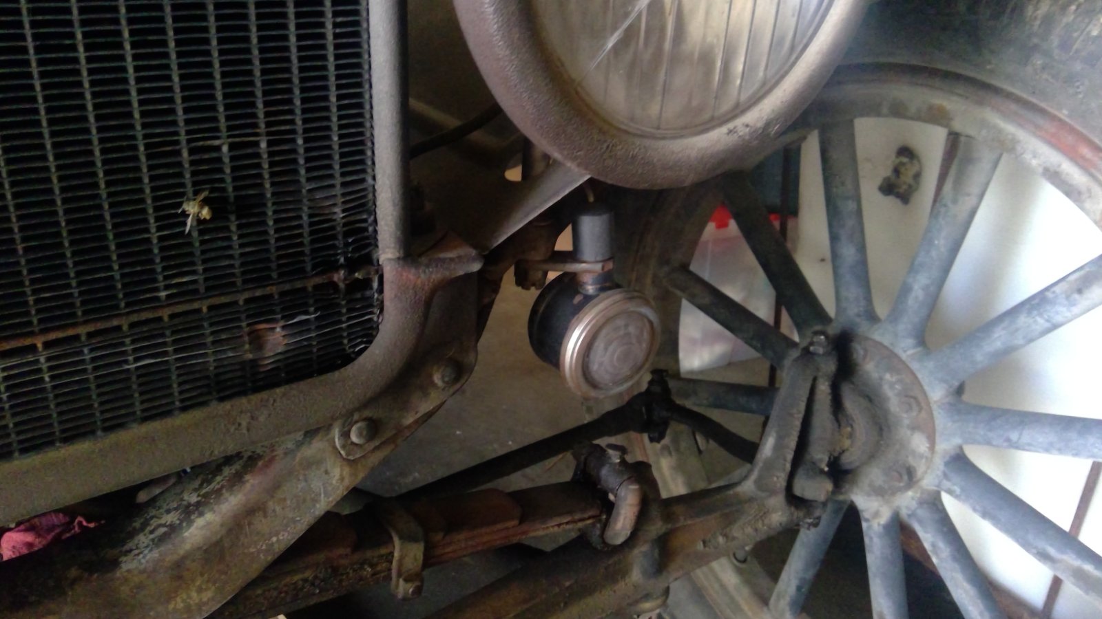

I used 2 of these on the front.
https://www.ebay.com/itm/20pcs-Red-Ambe ... SwuOZeUZgm
You just make a lightwieght L bracket and honestl,I used a very strong 3M double sided tape to put them on the bumper brackets and you can see them,but they are not "out there" to ruin the looks of the T. BUT any LED that you use,you will need to use a electronic flasher instead of a Thermal flasher as the current draw from LED is not enough to prompt the thermal flasher to work.
You can see them below the headlights.

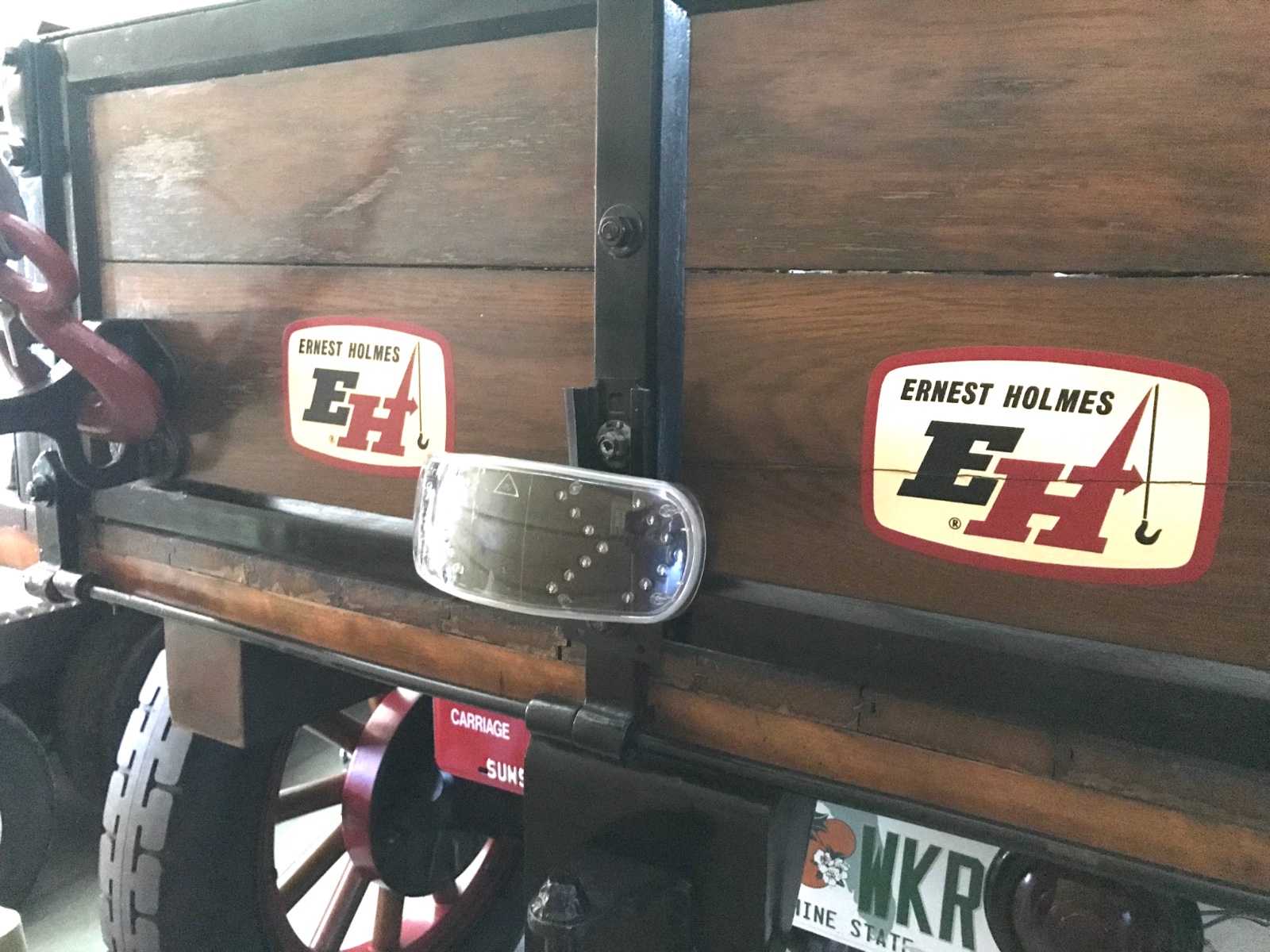

These are ELights. Only protect the rear. They have a sequential arrow and a 4 way flasher.
