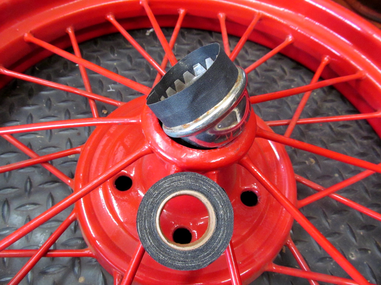

What’s the consensus on bending the hub cap tabs? Punch and hammer? Dab of silicone to keep from rattling or will they be tight enough just bending?
Re: Tired of sitting around
Posted: Sun Mar 22, 2020 6:28 pm
by DanTreace
Bead of silicone may work, haven't tried that. But use a wrap or two of good ole friction tape, that fills the gap and prevents rattles as the repro caps are a bit undersize.
A long screw driver or wood dowel used to bend over the tabs, typically do just every other one. Cap held firm by wheel weight, pushed tight against the wheel center when folding over the tabs.
