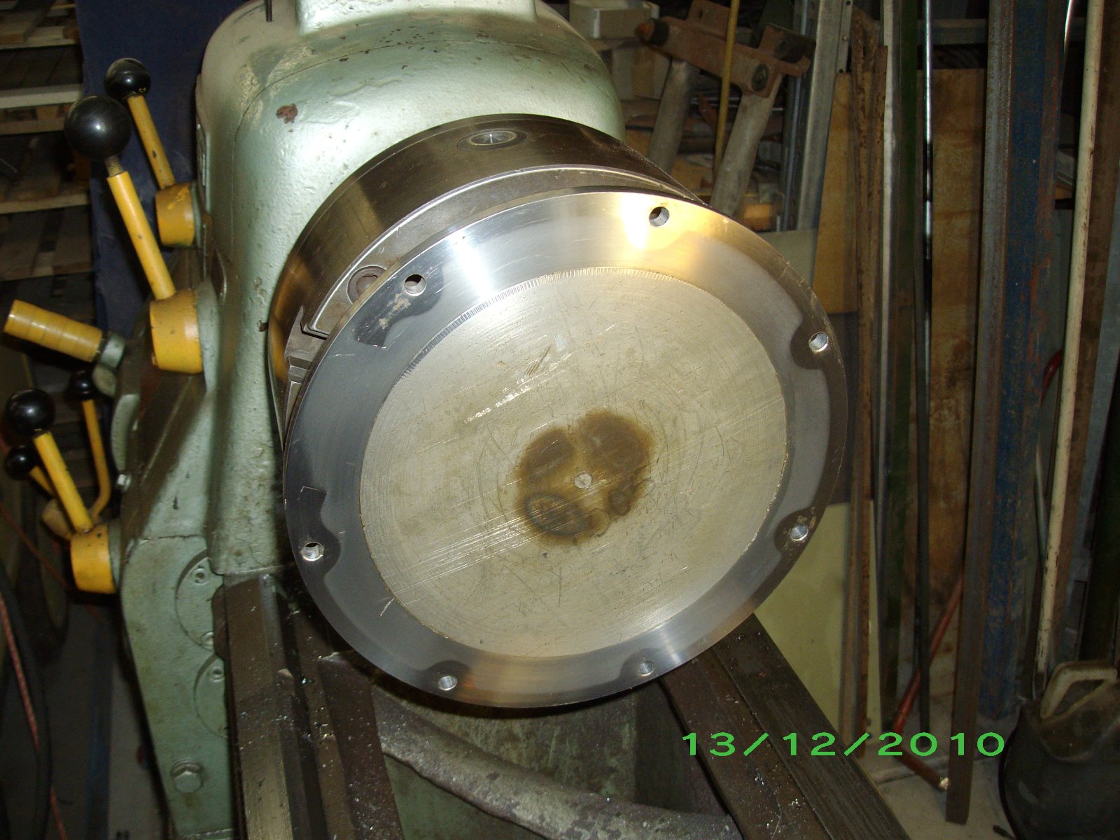

HI ; I did a number of axels like this ;
Toon

Some more pictures ;

ABoer, Brillant! Thanks for posting.
Hank

I made a faceplate similar to the one shown above... with a register on one face and a groove on the other, it registers either housing side by simply flipping it over.
I’ve never heated the whole tube up as shown above... but small nickel sized areas and air quenched to shrink. The tube moves far more than one would expect! A bit tricky as you need to let the tube stabilize in temperature before shrinking the next point. But as most things T related... patience is key

Terry, great methods by Toon Boer and Scott too, but mine was bent too much to repair with just heat/quench cycles like Scott's, and my lathe is not big enough to do it like Toon Boer, so i had to think of an alternative, while not ideal it worked !
