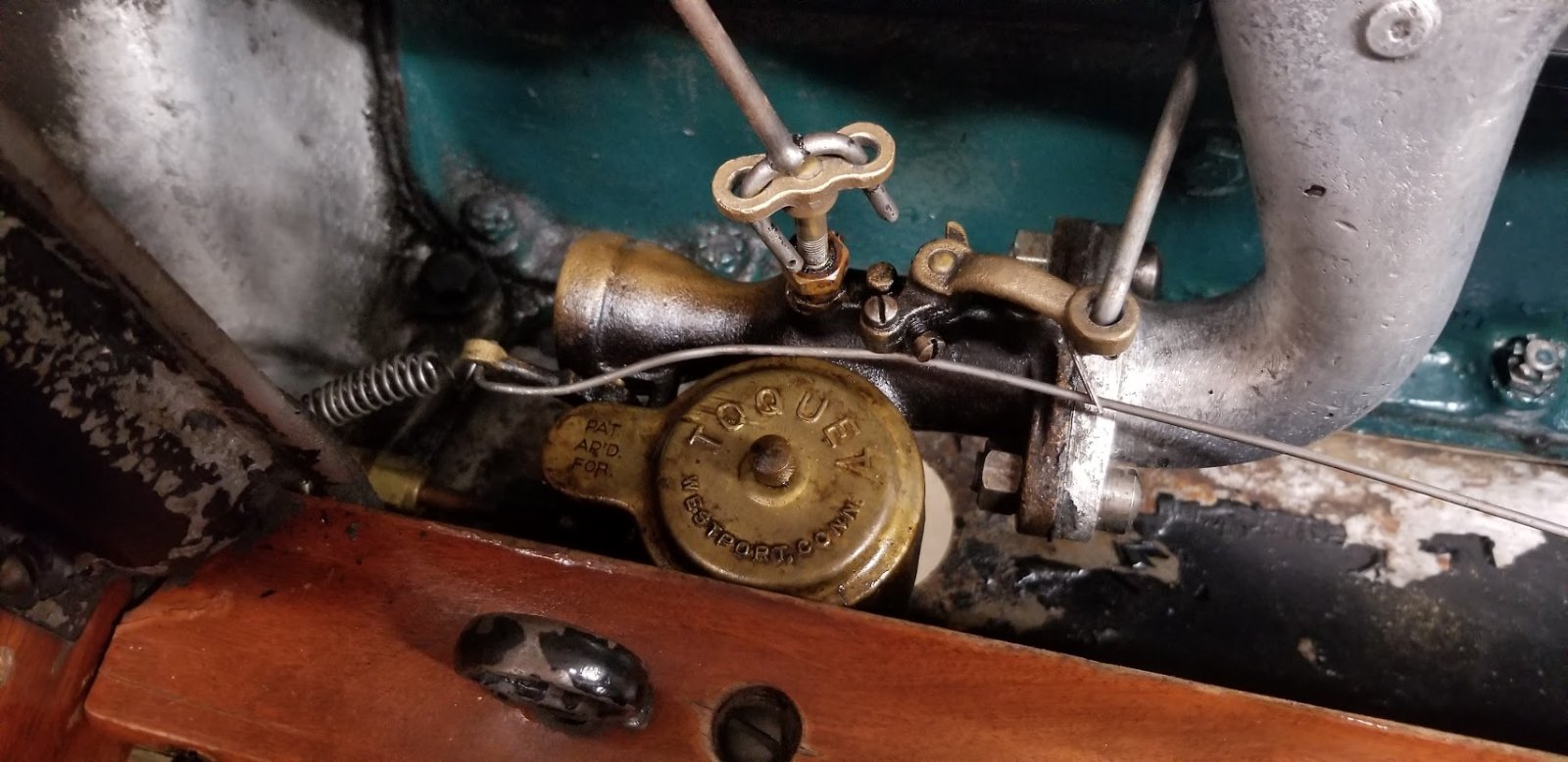

The carburator is not a standard NH, but an aftermarket:
Not that I think it matters to the worst, it seems to perform very well when driving.

Carburator is NOT a Holley NH or other standard but a Toquet aftermarket carburator which generally works fine. However I think it leaks a little and will take it apart and clean and check.
Thanks!
