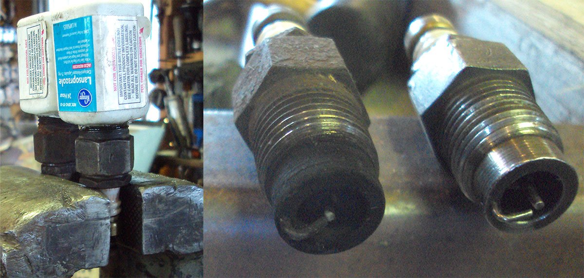

The spark plugs surprised me. I had run less than a tank of gas through the engine since rebuild but they were covered with carbon. 1 and 4 had a pretty thick build up. I suppose this was before the rings seated. One of my favorite plug cleaners is a pill bottle cut to fit the pipe thread and kerosene. 10 or 20 minutes really loosens the carbon. Not much leaks out.
