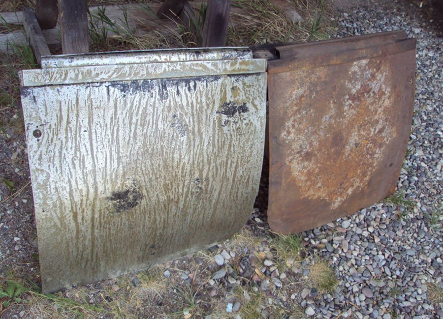

by John Warren
If you don't protect it, it really don't take long to rust. If it is galvanized, you will have to sand through the coating. I did spray some bleach on a few parts to help start the process.
