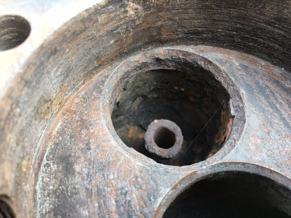

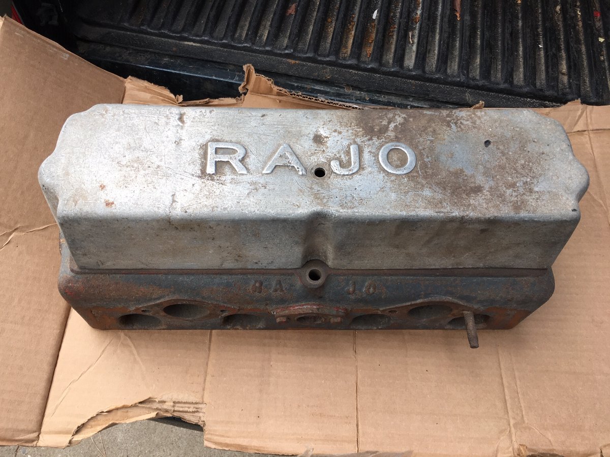

I have a chance to but a Rajo model B head (figure 2). My brother found it laying in someone's yard of all things and the guy (who hates Fords) gave it to him. My brother has offered it to me at a good price. It has the valve train, the valve cover, all but one of the push rods, and the machine shop just told us that it has no cracks anywhere. It is missing the intake and exhaust manifolds. The only other significant issue is some corrosion around one of the valve seats (figure 1). My question is how to deal with it. The shop who did the magnaflux says that it might be possible to re-cut the seat and run it, but they though putting in a new valve seat would be better. I also have a shop in Santa Rosa that says they can rebuild the seat by welding it up. I know that the web between the intake and exhaust is very thin so I wonder about putting in a removable seat. I think it will probably take a new valve guide.
Has anyone here rebuilt the valves on a Rajo and what worked for you? Also, is there anyone in the Sacramento area that people have used for old car work or who they can recommend for the job? I used to use a shop in Sparks when I lived in Reno, Nevada, who used to do a lot of work for Bill Harrah in the old days but getting it there is a bit of an issue with me being in Alaska now.

1st off, there is no one in Santa Rosa that I would let weld on that head, nuf said on that. My opinion only. Seats are bad mojo in those heads due to the thin area between the valves as you noted I think I would 1st try just grinding the seat and see where you end up- not ideal and the seat will be sunk but . . . . . The seat does not need to be 100% perfect for you to get some good miles out of it.

If that were mine, I would go very VERY light on hand (not machine)-grinding those seats, the absolute least you can get away with. Go easy, go slow, and check often. And all it has to do is seal... not be *perfect*. Take no more than what is necessary...Dan McEachern wrote: ↑Tue May 26, 2020 7:14 pm1st off, there is no one in Santa Rosa that I would let weld on that head, nuf said on that. My opinion only. Seats are bad mojo in those heads due to the thin area between the valves as you noted I think I would 1st try just grinding the seat and see where you end up- not ideal and the seat will be sunk but . . . . . The seat does not need to be 100% perfect for you to get some good miles out of it.
As an aside - LISTEN TO DAN. DO NOT let ANYONE weld on that head first. I also know of no one in Sana Rosa I would trust to do this, no way, no how, no no. There ARE people that I *might* trust, but they'd have to show me a whole passel of success stories doing this, with pictures and documentation. And that's only if it's cracked. No cracks? No way, Jose! I don't like even RESEATING valves that close, the few I've done were always nail biters - on fairly modern iron.

I agree with Dan,
If you go lightly you can probably clean that seat enough to use it for a while. I didn't realize it was that thin between the valves, then again my budget at the moment doesn't allow for overhead toys.

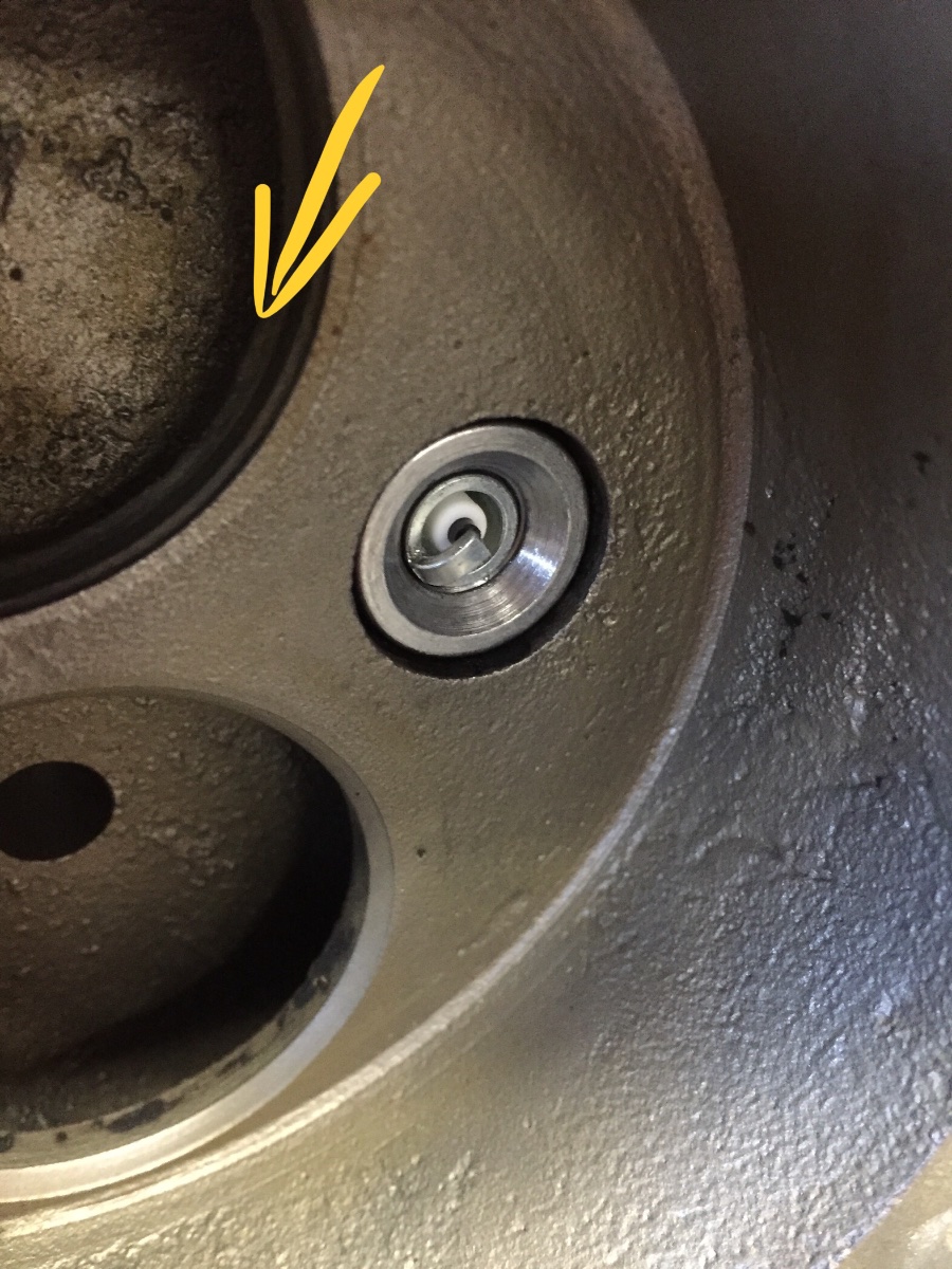

All the advice you've received so far is spot on, but FYI, around 14 years ago when the Rajo B head was off old #4 for a little overdue maintenance the shop that does my work called me and said we can't do anything with your valve seats, they're to worn, to many valve jobs, we need to put new seats in. I said "no way I don't want "removable seats". Anyway I finally agreed and let them do it. Knock on wood, I haven't had any issues since, in a lot of somewhat hard miles. So as much as I didn't want them......it worked for me.

If the only other option was using it for a door stop, one could always install the smallest diameter seat available to clean up the damaged material, and reduce the valve size to match. The valves and ports are dramatically oversized for the performance expected my most owners anyway. Who knows... running smaller valves may even improve the flow characteristics...?
I have a similar problem with my Akron-Hed project, and have reduced the valve size to 1.710” to allow a smaller seat and buy some “insurance”

A quick look at what a really bad valve seat looks like...
. With a .250” lift cam, the exhaust valve face would have just barely raised above the combustion chamber floor
