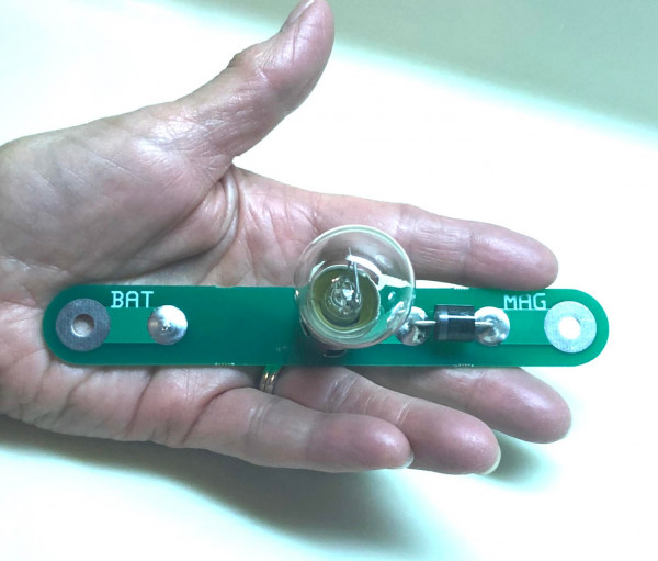

Does it matter if the diode is before or after the the 1156 bulb? I made mine magneto, bulb, diode, then battery. Searching old threads it’s say magneto, diode, bulb, then battery.
http://www.mtfca.com/discus/messages/411944/494541.jpg
Been running it a year that way. No I’ll effects that I can tell.

The bulb and the diode are in series so that part doesn't matter but you MUST make sure the diode is correctly installed since the cathode end (striped "banded" end) must point to the battery positive connection. The anode end of that diode must be pointed at the magneto connection. If you want to see a simpler version of this same device, I make them up with a printed circuit board and all parts mounted such that you only have to slip the thing onto the 2 ends of the coil box connections at the bottom. These are the Magneto (MAG) and Battery (BAT) connections that are the bottom 2 connections of the 10 connections on the engine side of the coil box. I will attempt to attach a picture of the device all built and ready to install. You can put it on or take it off in a few minutes with no wiring alterations other than removing the outer thumb nut on each side, then slide the Printed Wiring Board in place and reinstall the thumb nuts. If there is no picture posted here then send me an email or PM and I will send you a picture of the device.

Yes they are actually designed for just that purpose. Choice of bulb can increase or decrease charge rate depending on the Amp-hour rating and voltage of the battery you use. Contact me via email for more info.

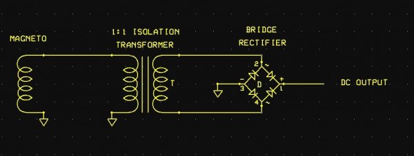

A Bridge Rectifier will not directly replace the single diode in this type of charger.
One leg of the bridge will be a short to ground.
In order to use a bridge rectifier, the magneto output must be isolated by a one to one isolation transformer.
Then a bridge rectifier will give you full wave output.
I have this arrangement in my '16 T.
It works great.

Bob, You want to show us how you hooked up that isolation transformer on that grounded leg? Sounds very interesting.
Re: Magneto battery charger
Posted: Sun Jun 14, 2020 4:14 pm
by BE_ZERO_BE
Here is a sketch of my setup.

What a lot of folks don't seem to understand is that the light bulb acts as a current limiter to prevent the charging current from getting large enough to overcharge a small battery or large enough to pull the magneto down so the car won't run on magneto. This device was written up many years ago in the MTFCA elecrical manual and it is essentially a copy of the way the phone company used to limit the current to a given phone that was powered through the phone line. They put bulbs in series at the central office and those bulbs would light up bright if there was a short on the line but otherwise simply limited the amount of current that was available to the consumer's telephone. Telephones operated on very large 48 volt storage batteries and for many years they were essentially just a larger version of the batteries that were being used in our cars. Those batteries typically last for more than 20 years unless there was some major calamity that drained them completely.
The typical cell phone has a small voltage battery in it that is often about 3V or so. It is charged from a 5V source in the USB which is a regulated drop from the cars 12V supply. That makes it all battery derived.
The small charger I pictured above uses a lamp as a current limiter and a single diode to provide some charging current to the 6V or 12V battery that the car might have in it. If you rarely drive at night this charger will charge your battery with a small current that is there the whole time the motor is running. I have had them on my brass cars and never had a battery go bad using only this small charger to put back the current taken from the battery by a motor that is in very good tune and fires right up on the first spin. Full wave will increase the efficiency but it really doesn't make enough MORE power that you might need to keep up with headlights and tail lights. LED's will reduce the needed charge amount but the starter will need that larger reserve of a full size battery. This small charger does not need any switch or fuse because the bulb serves as a fuse and the diode is super heavy duty for the amount of current taken.
Good evening BZB,
Would you have a parts list to go along with your drawing?

Here is how to connect two identical transformers back to back to make an isolation transformer.
This will give you about 48 VA of power to the rectifier.

J1MGOLDEN wrote:
Thu Jan 27, 2022 3:29 pm
Can you buy that little green strip all made up or do you have to make your own?
The green strip is just a piece of circuit board. Most anything that provides electric insulation will work, like a wire junction box which also provides an enclosure and mounting

You would need a transformer to make the full wave rectifier work, as one end of the Magneto Coils and the Battery goes to ground.

Half wave rectifying the magneto output is good but only uses the positive magneto voltage pulse so is not as efficient as full wave rectifying the output. Full wave rectifying the output makes use of both positive and negative magneto voltage pulses. The problem is the magneto output is referenced to ground and so is the load (the battery; negative ground). That shorts out one of the bridge diodes effectively resulting in half wave rectification.
But wait, there is a simple solution as Bob points out. Simply use an isolation transformer with 1:1 turns ratio (Vsecondary = Vprimary) to magnetically isolate the magneto from common ground, then you can Full wave rectify it and reference the negative output to common frame ground without issue.
ISOLATION TO BRIDGE.jpg (19.26 KiB) Viewed 13049 times
I found an inexpensive Triad N-68X 1:1 isolation transformer on ebay as mentioned earlier in this thread so figured I would try it out to see what the benefit would be in picking up the charge current. Its a simple, cleaver, straight forward, logical approach but unfortunately IT DOESN'T WORK!. There is no benefit to the added cost and complexity, in fact, their is a marked penalty imposed rendering the approach far less effective than the simple, tried and true, time tested half wave diode and 1156 bulb method. For those interested in learning why their electronics prowess failed them too, read on.
First of all, transformers are not lossless devices. They are designed for optimal efficiency at a specific operating frequency, voltage, voltage transformation ratio and load current. Core losses is a contributing factor but not the primary reason why this method fails to provide a viable means to full wave rectify the magneto output. For that, we need to look at the transformer model. Next we will use that model to create a larger model of two transformers connected back to back as Bob's schematic illustrates and lastly, we will make an equivalent model of that transformer which will expose the root cause it fails to produce the desired benefit.

I have no data on it.
I had no voltage regulation system other than an ON-OFF switch to control the battery charging.
I monitored the battery voltage with a voltmeter installed where I could keep an eye on it.
As far as testing, I can only offer usage experience.
During normal driving, my battery voltage would rise from a quiescent 12.5 volts to 14.5 volts within a few miles.
At that point I would turn the charging system off.
The biggest stress test I put on my system was a 1½ hour night drive.
My headlights are 12 Volt, 50 CP.
The battery didn’t drop below 12 volts during the trip.
I was satisfied with the performance of the system for the five plus years that I had it on the car.
