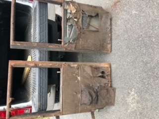

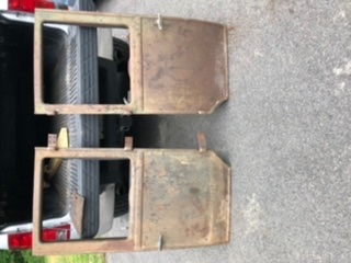

Full disclosure: my wife calls me Sanford and Son and I have it as my ringtone😀. So, this is piggy-backing off of my hinge post. I came across two, what I believe to be 26-27 Fordor rear doors. Nor that I neeeed them, but......

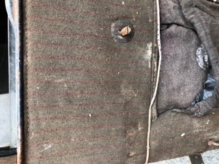

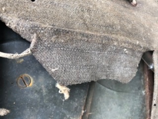

These doors are in awesome condition: complete, only surface rust, one has complete un-broken/ cracked glass ( my wife calls me a geek because that got me excited). I have tried my best to cram as much info into my head in a short time. Now the questions. One door has the grey material with maroon stripe. However this door is definitely black. Secondly, the next door is definitely green, and the material is dark ( dirty) with a black stripe that has a single white stripe within the black stripe. I have not read or seen any material of this description. Both doors have black garnish moldings. Is this normal or should they be car color?
So, can anyone confirm the year of doors and shed any light on color combo? Thanks for any help to this newbie🤙

I don't know the dimensions, but they sure look like Fordor doors to me. '26 and '27 Fordors used the same body as the '24 and '25 Fordors. Dave

These are @ 47” tall at the jamb side and @ 24 1/2” across belt line. All metal, no wood
