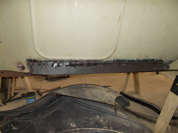

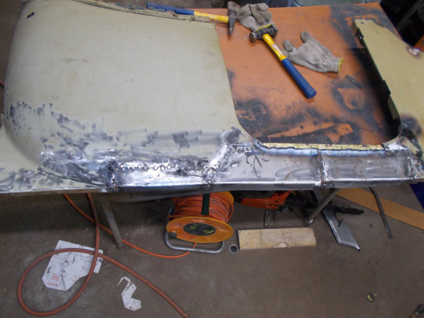

Repairing rust damage on the bottom edge of my 24 roadster body. Drivers side went good, simple strip of new tin. But the door side was a problem, Placed the panel on my bench, clamped the door in place and cut new tin to patch. Welded in place and tried it on the wood frame, not even close to fitting. Had to split the new tin and extend it by one half inch. Seems to fit good now and the door fits,

My dad used to joke that if you made something too long, it would be difficult to make it right. However, if you made it too short, you could always scab a piece in to fix it!
Re: If it don't work the first time,try again and again
Posted: Sun Jun 21, 2020 10:12 pm
by Wayne Sheldon
All kidding aside, LOOKING GOOD!
