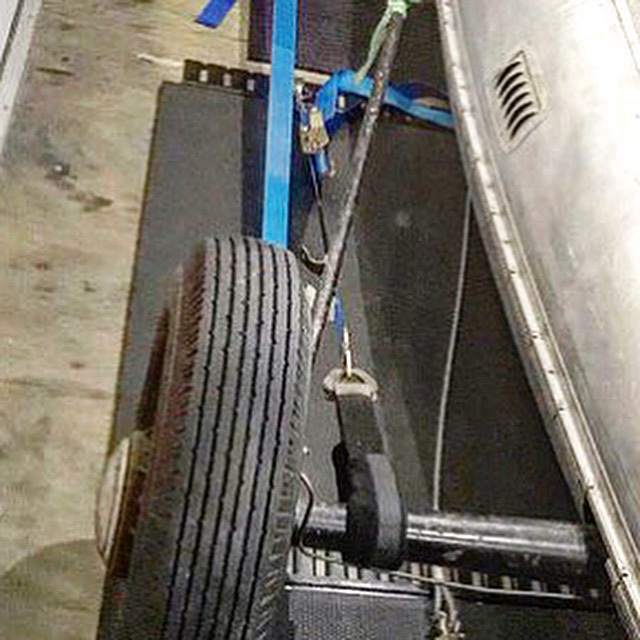

I don’t have a Model T image handy - but I transported this Model A Belly Tank Racer to the CEO of J.D Powers outside of Chicago last year.
I secured it at the rear axle & front tires which were pulled to the center.
This keeps the vehicle from being pulled apart.
I use this method on Model T’s and Early Brass Cars but I usually secure to the wheels using padded axle straps.
