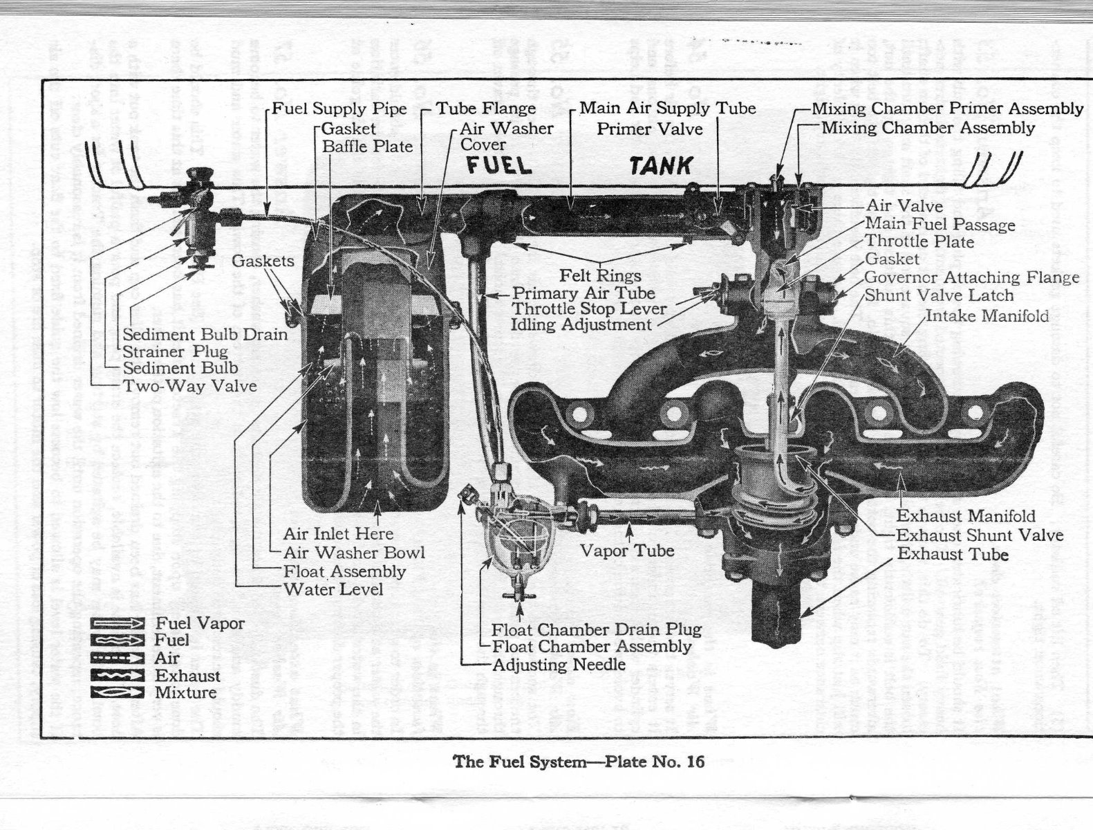

I have attached a couple of scans. When you mentioned your vaporizer was a coil, it got me thinking. Kingston MD's have a large rectangular block that has a maze cast in it for the hotplate. Earlier Holly's have the coil.
Again hope these help,
Kevin

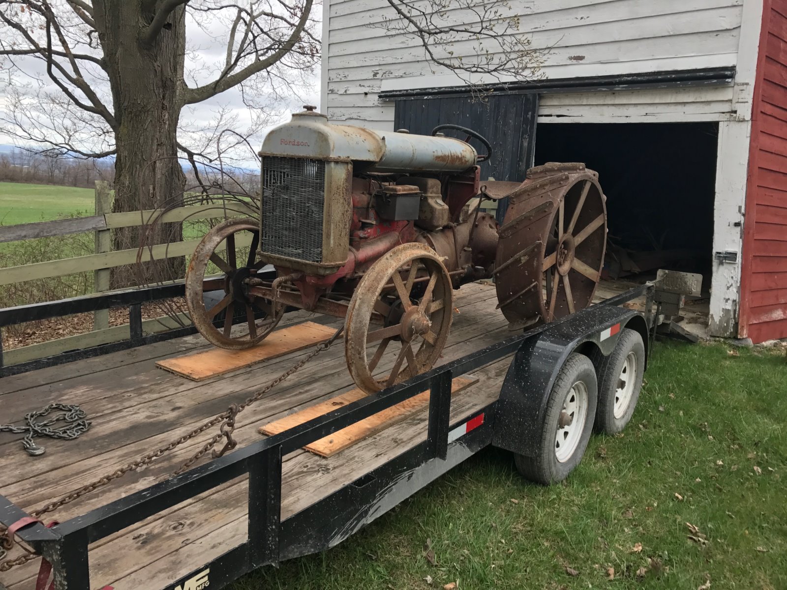

Here is a picture from when I picked it up. Will be ordering a new radiator from Fordson House.

Kevin, plate 16 diagram is my vaporizer setup. Joe, I have to start mine about 4 times out on the needle and then can lean it. Maybe a valve issue. I can not run it with out water in the air bath because it seems to need that back pressure. I put packing foam in it to hold the float open and could only run it partly choked. Does yours have a priming cup on top of your vaporizer? I have a 36 Fordson N with a downdraft vaporizer that starts easier.
