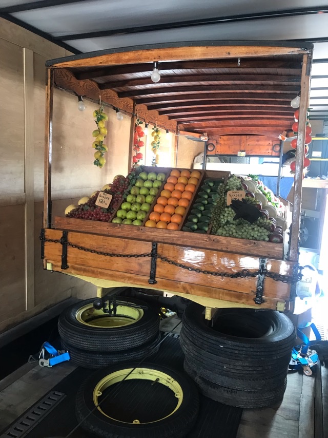

I had a 1908 Thomas Flyer ( tribute car ) collapse inside my enclosed car trailer during transport
from Colorado to Washington.
Turns out the frame was being held together by C Clamps and angle iron ๐Ÿ™„
