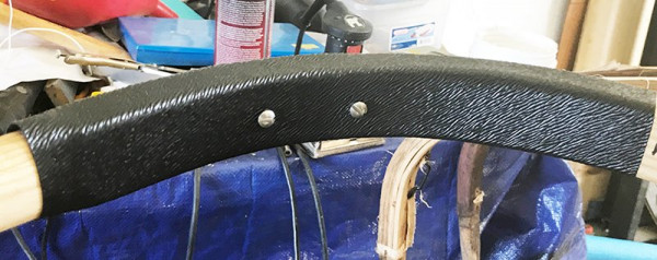

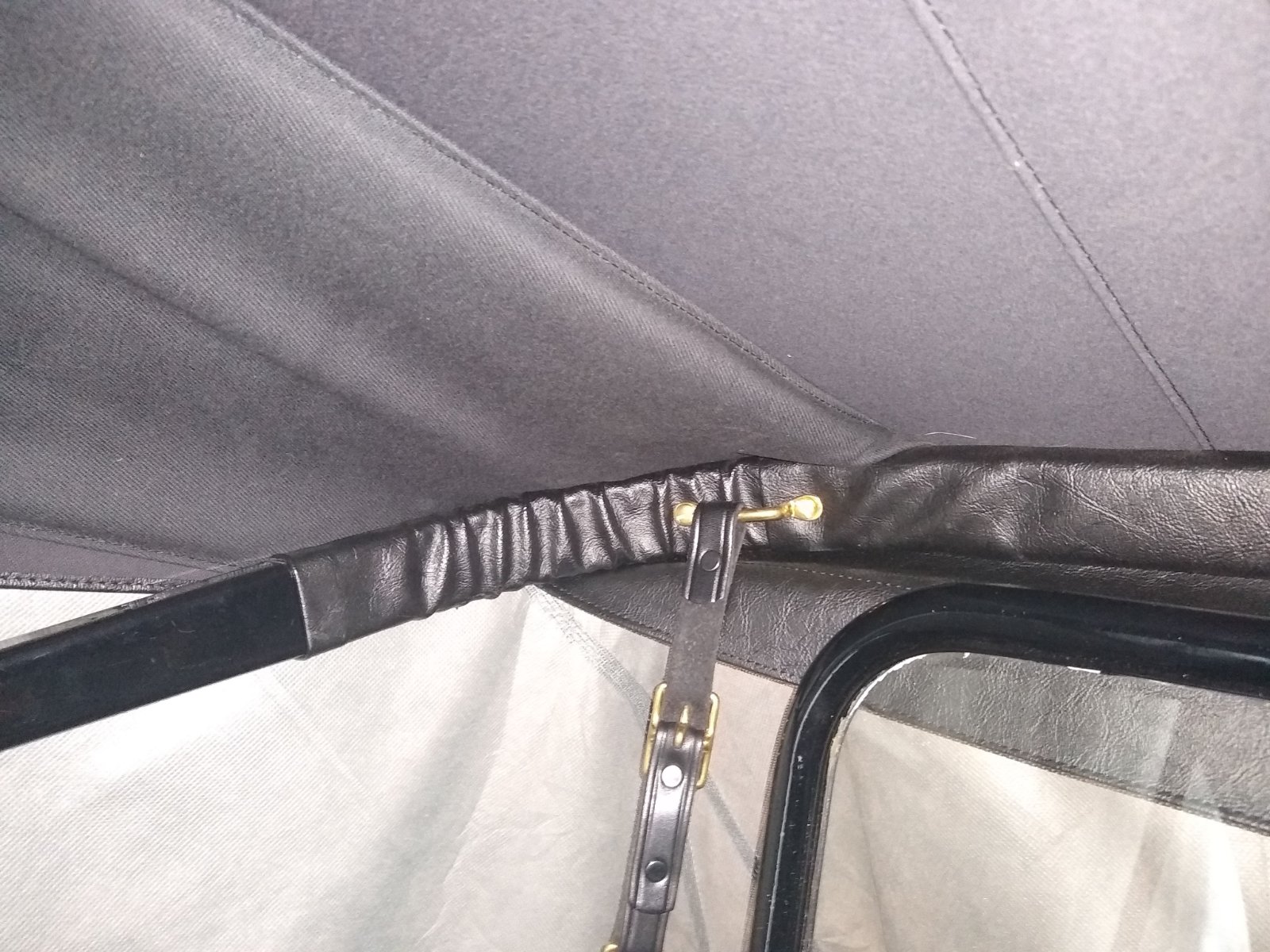

Here's what my wrapped top bows look like. I think one of the classtique videos shows wrapping the bows that may be helpful for you too.
Neal

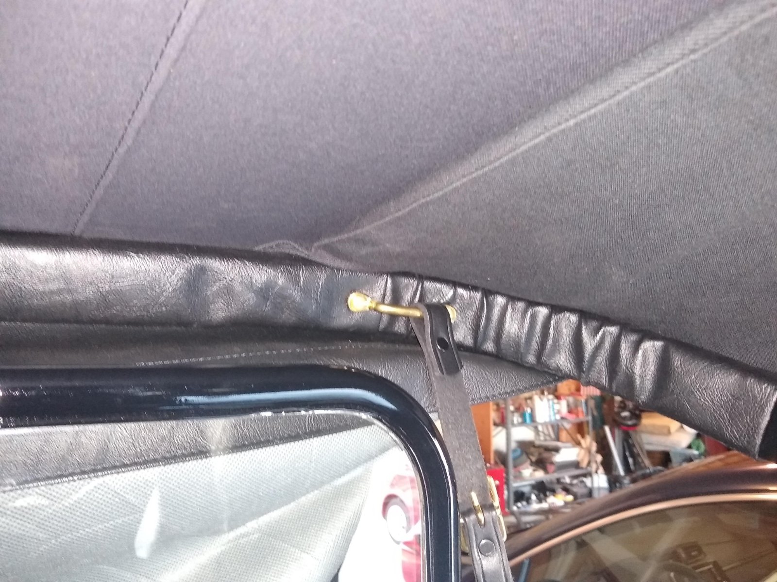

I wonder if there is a period picture that shows what that area looked like on the cars when they were new?
- Posts: 4090
Re: Top install question

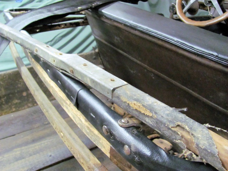

Likely hard to find period photo of that detail up inside a raised top.
On my '23 the front busted bow had a metal repair, and remains of the front bow wrapping, it was stiff, but was tight around the curve. With hardly any wrinkles. That old material Ford used was thinner that our modern vinyl.
I wrapped the new wood bow replacement with vinyl, takes time to pull and stretch, and got little fold wrinkle. But this was the barn look car so didn't really work on it.
For my '25 touring the kit came with nice angle cut pieces of bias cut vinyl, and that wrapped very nicely without large wrinkles.

Dan, did the wrap on your front bow come in more than one piece? It looks like a seam in the photo.

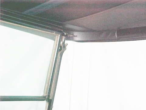

From the factory, on a two-man top, the leatherette on the front bow is a single piece.
I'll take some photos and post when I'm back home and have some time.
I believe your problem is the material used is too heavy/thick.
Classtique supplies one long and two shorts (one for each curve) because, I believe, Mike is not able to cut leatherette on the bias from his rolls of top material long enough to provide a single piece. I don't know if the long piece he supplies is cut on the bias. The short pieces for the curves should be cut on the bias. Frankly, in my opinion two long pieces cut on the bias would be preferable so there is only one "joint" where two pieces meet instead of having three pieces and two "joints."

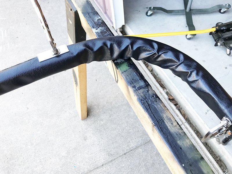

I am going thru the same issues with my 21 touring. I originally did the top on this car some 50 years ago with a kit from Carters. It did not have any covering on the curved sections of any of the bows. I am rebuilding the top with a Classtique kit. The front vinyl wrap came as one piece. The video shows separate pieces for wrapping the curved sections. Also in the video she is only covering the wood section of the curve. So I cut mine into three sections and did the center section first. I took a break after a couple of tries on the curved section. That vinyl just doesn't want to conform smoothly. Maybe its not cut on a bias. Its in the high 90's here, great for the vinyl but not so great on me! The rest of the bows are going on just fine with the drill fabric. No problem on the curves. The spray adhesive really helps hold things together while you are positing the fabric. I am thinking of using some vinyl I have from another project and cutting it on a bias and trying with it on the front bow.

The photo that Dan Treace posted is correct. There are two posted above that are horrible, and I would be ashamed to own a T like them. Those guys need to read up on what cutting the material on the bias really is! It is not an impossible job. However it takes some effort, and as I mentioned previously a heat gun and some contact cement are a help. Tacks work too, but a staple gun is easier than dropped tacks!

I think you are going a little hard on some of the posters. We're all trying to do the best that we can. The vinyl that came with my kit is cut on the bias and I've tried everything I can think of and a few things others recommended with no luck. It looks better now than the first photo I submitted but not perfect by a long shot. I think most vinyl available today is thicker than was used back in the day and doesn't give as much. I've reviewed the available videos on the subject and they really don't offer much help.

Dan Treace, thank you for posting that picture showing how smooth the job can come out when the wrap material is cut on the bias.

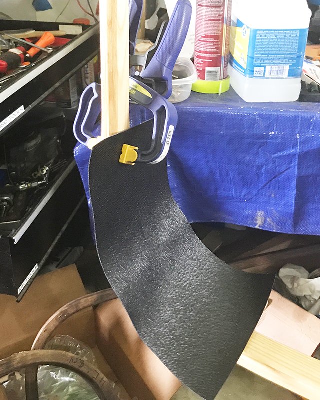

Ok, I'm back again. I ordered some material from Classtique that matches the rest of my kit. The front bow wrap comes in three pieces with the end pieces for the curve cut on the bias. Now I am faced with how to proceed with attaching it. I don't want to ruin it and have to buy replacements and lose time getting my top installed.
I've attached a picture of what Mike sent me. I'm thinking I might glue the center to the underside of the bow and try using a heat gun and such to stretch it around the top where I'd tack it. I believe the video said they cut slits in the material to help it conform. I assume we are less worried about the appearance of the material on the top of the bow compared to what is visible to the car's occupants.
For those of you who have been successful in getting a tight wrap on the corners, what did you do?

Why don't you try using some clamps and push pins to temporarily hold it in place while you practice wrapping it and smoothing the wrinkles out?
MikeSommers
- Posts: 48
- Joined: Sat Jan 19, 2019 4:34 am
- First Name: Mike
- Last Name: Sommers
- * REQUIRED* Type and Year of Model Ts owned: 1913 Touring
- Location: Vernon Hills, Illinois
Preventing wrinkles is deceptively simple. Spray scotch adhesive to the inside curve of the bows and then apply the fabric. Once it has dried, you can stretch and wrap the fabric up over the outside edge, stapling as you go. Only wrap the fabric almost halfway across the outside edge, so when you wrap the other side, it is still secure, but only one layer in thickness. The spray glue prevents wrinkles from form on the inside edge, and also prevents wrinkles, since you are wrapping it onto a larger radius.
- Posts: 3953
- First Name: Larry
- Last Name: Smith
I don't know why Mike would be supplying the material for the front bow in three pieces, when if done correctly, on the bias, it can be done with one piece! I have done several with no problems. It isn't easy, but is definitely doable. I have also used contact cement and a heat gun to help me with the task. Mine come out looking just like the photo that Dan Treace posted above.

Thanks to all for your comments....they helped.
As I said, I purchased material from Classtique to match my top. It came in three pieces with the end pieces cut on the bias. I agree that you could likely do it in one piece if it was all cut on the bias.
What I did was glue the material to the inside of the curve and by using heat, clamps and strong fingers, stretch it around the bow. I did put a little slit on each side near the center which I think helped a bit. I did not make numerous slits as shown in Classtique's video - they were not necessary. In truth, the spray glue made it easy - I also used it to glue each side of the top down as well. I put in a few tacks for safety and am ready for the next step.
