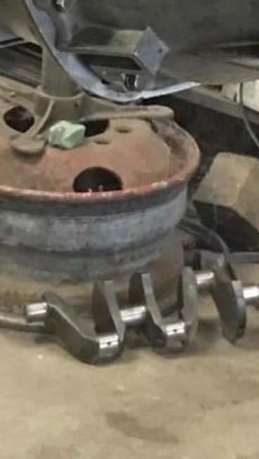

My dad's main hobby was drag racing, which he did from the late 50's through the early 80's. I came along in '69 and tagged along and got that high octane in my blood.
I'm about to undertake another rebuild on my high school car ('54 Ford tudor sedan) with a stroker small block Ford...looking for around 500 hp. With my Model T, the goal is to slow down and enjoy the scenery.
Tony's explanation of the engine internals is one of the best explanations I've seen of why the little engine shouldn't be revved too often. I baby mine....probably too much.

This was a pressure fed crank with less than 10 hours but 6500rpm
Broken crank
Broken crank
Reliability is in the eye of the beholder.
(Picture from Erik Barrett)
