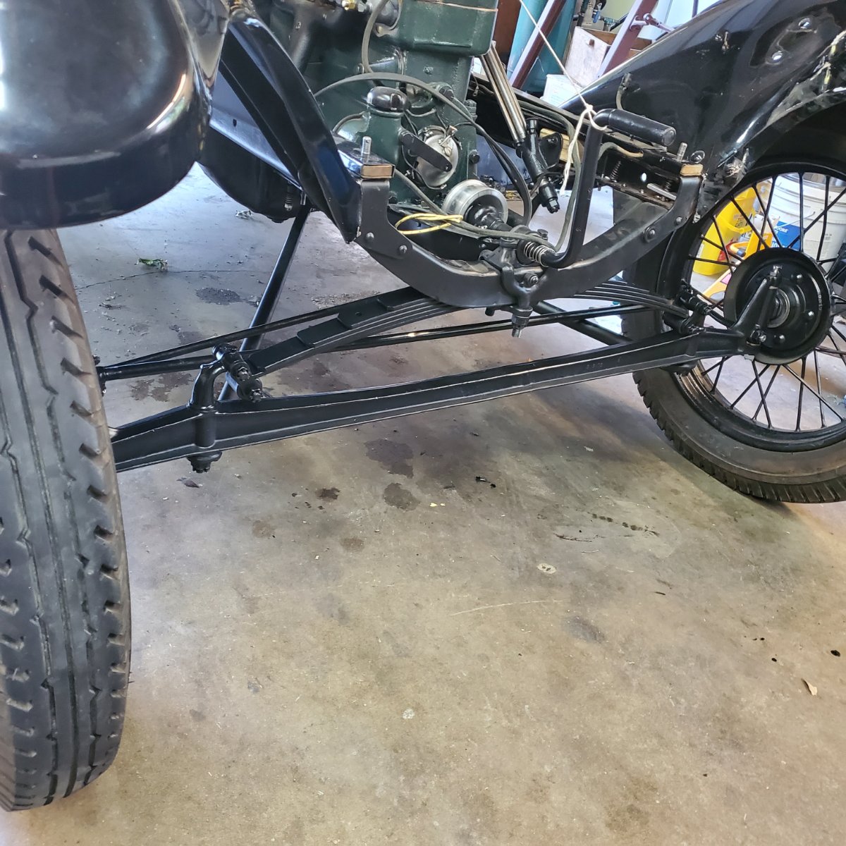

I was hit by a distracted driver a few weeks ago and thought I'd write a few words on the progress in getting this car back on the road. The insurance co totalled the car as the repair estimate I provided exceeded the $10,000 agreed coverage. They gave me a non-negotiable salvage buyback of $2800 which I accepted knowing I could do the chassis work myself and come out ok.
The bulk of the chassis damage was to the front end. I replaced the axle, the perches, the shackles, one spindle arm, the wishbone and the bottom spring leaf and clips. With careful heating and bending I was able to save the tie rod. The rest was fine. Here's a photo of the front end after repairs. I'll want to test drive the car after I reinstall the radiator just to be sure it tracks the way it should. I called Rootlieb and it looks like the fender and running board are still six weeks out. I forgot how much work was involved in rebuilding a front end. I figured I'd have it done in a week!

I contacted the painter and he recommended painting all the fenders. I said I'd leave it to his judgment. He comes highly recommended and I've seen his excellent work on a twenties/thirties Buick and a Model A pickup. I'm in the cue for new Rootlieb fenders but it looks like it will be late August or September before they arrive.
With the down time, I'll make new floorboards.
I'll keep you posted.

Re: Update on accident
No problem Wayne. I am living with the frame. Everything is straight or appears straight. The doors open and close as before. The radiator fits as it should and the rod is straight. When I installed the front axle assembly, the ball of the wishbone slipped perfectly into the pan sockret without coaxing. That said, the back side of the front cross member is flared where the bottom leaf of the spring bent due to the hit on the drivers side. Ine spite of the damage, the front end is square and the car tracks as it should when driven.
I decided to leave well-nigh alone re the frame and ceoss member.
Thanks and glad to hear that Richard! When I looked at the original pictures of the damage I thought maybe just maybe the hit was outside the frame enough that it might have been okay. I have seen quite a few decent looking model Ts found to have bad frames over the years. If it all lines up okay, measures okay, then runs and drives like it should? You should be okay. If it were me? I would probably fix that fender.
Take care and be well my friend.
