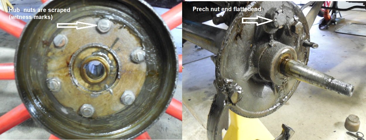

wheel nuts hitting the nut for the leaf spring bracket, you might want to check the Babbitt washers out inside the rear axle before you go through a stop sign.

I agree with Joe, if you remove the wheel I'll bet you'll see witness marks where the hub nuts are rubbing on a the rear perch nut on the backing plate.

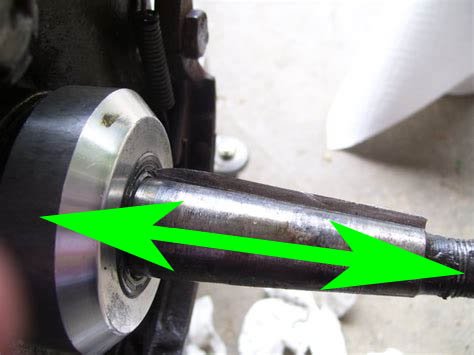

I want to be sure of what Mark is saying here.
CudaMan wrote:
Sat Aug 01, 2020 3:22 pm
...and you don't have any axle side play
Would that 'play' be a sloppiness along this axis?
1916 Touring

Here is discussion showing what the effect of the hub nuts rubbing on the perch nut looks like
http://www.mtfca.com/discus/messages/70 ... 1487778886

Post by CudaMan » Sat Aug 01, 2020 8:00 pm
Yes, the green arrows show the direction of side play I was talking about. :)
If it turns out that you have no side play and you decide to use shims on the axle taper, be sure to keep the inner edge of the shim away from the axle seal so that the seal doesn't get cut or otherwise damaged by the shim.
