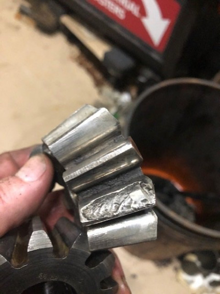

Post by ivaldes1 » Wed Aug 05, 2020 12:26 am
I have a pinion gear with one tooth gouge on it pictured. I wonder how it happened? I don't actually need it because I am changing to a higher ratio of 3:1 but I would rather not just throw it away. It is otherwise good. Other than put it in the box of bad parts what can I do with it?

Re: Gouged pinion gear?
Post by Stephen_heatherly » Wed Aug 05, 2020 8:06 am
Keep it as a conversation piece or throw it away. It's not good for anything anymore.
Post by Susanne » Wed Aug 05, 2020 9:42 am
Paperweight? Maybe a projectile for a BIG slingshot? Definitely not in a differential any more...
That pinion has shuffled off its mortal coil, and should be permanently retired. If it was a one-off only one in existence pinion, I'd consider using it as a pattern to make a new one... ABSOLUTELY worst case it could be welded, machined, heat treated, hardened, and maybe put back into light duty service, knowing you put a grenade in your rear end and expecting it to come back apart and cause a catastrophic failure of your differential.
Post by Jerry VanOoteghem » Thu Aug 06, 2020 6:37 pm
No, it really isn't. Keep it as a conversation piece?
Post by GrandpaFord » Fri Aug 07, 2020 8:31 am
The highest stress on a gear face is not at the surface but below the surface. After many cycles the gear will fail by spalling. The number of cycles it takes depends on the steel and the force. More force means shorter time. Once a spalling failure occurs on one face the rest are close behind. Better to replace the gear.

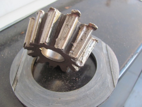

Post by DanTreace » Fri Aug 07, 2020 8:54 am
Ignacio
Your pinion gear is rather nicer than this one :)
Could only guess how noisy it ran....or if the owner of that T ever added lube to the axle :shock:
Post by John kuehn » Fri Aug 07, 2020 9:37 am
WOW Dan!
That has to be one for the record books!
Using that gear as a guide for how long they will run makes Ignacios gear look
good for a lot more miles down the road.
Post by Ruxstel24 » Fri Aug 07, 2020 10:00 am
A little JB weld and both those pinion gears are good as new !! :lol:
My 13 tooth had a missing tooth that developed last fall....it's in the scrap bucket.
Excessive side shim wear and a loose pinion nut were my assumption of the cause.
New spool FP bearings and reshimmed and all good so far, shifting is much smoother too. :D
