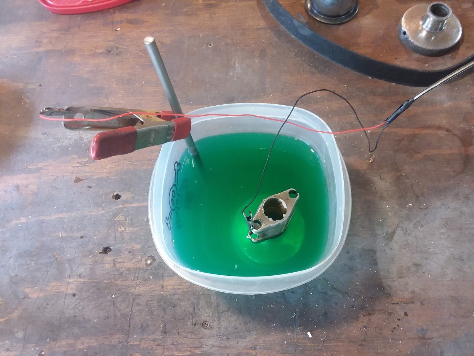

I did a little YouTube plating while it was apart. All you need is vinegar, salt, some nickel and a phone charger.
I masked the sanded (most of) the pits out, masked the threads with some paraffin, and plugged it in. I'm pleased with the results, for a twenty dollar investment.
