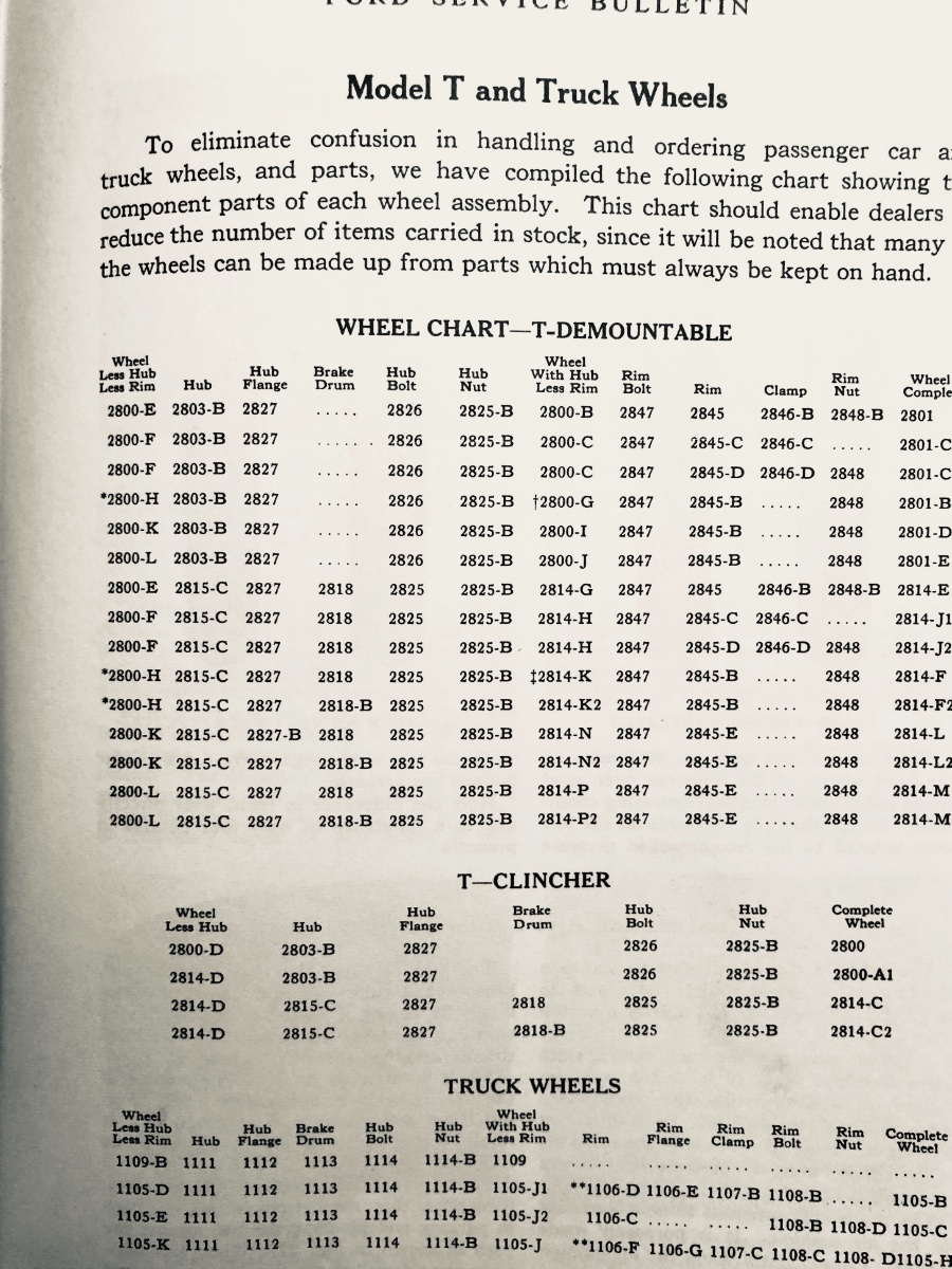

Look up the Service Bulletin about wheels. You will be shocked.

Thanks. Do you have a link?

Holy mackerel! Okay, I can see that assembling a truly matched set could be a chore. I think I'll have to re-watch some Engels coach shop videos
