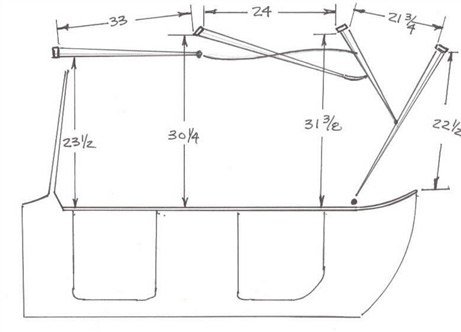

I’m about to put the top on my 24 Touring and was wondering if anyone has the measurements for where each bow goes on a one-man-top car in the fully “up” position.

Not sure of the year, but shouldn't matter if your car is late 22 - 25, this should be correct.
Re: Top Bow Spacing
Posted: Thu Aug 20, 2020 6:57 am
by RustyFords
That’s perfect Martynn..thank you.
