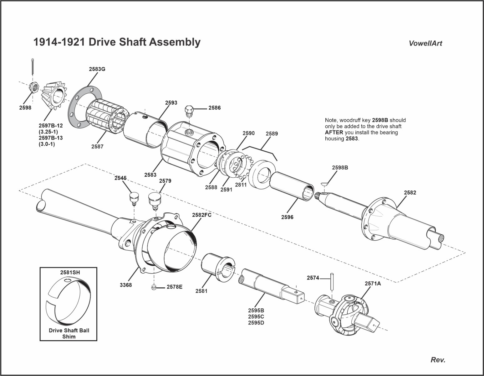

***1914-1921 Drive Shaft Assembly***
Posted: Fri Aug 21, 2020 3:57 am
by VowellArt
Re: ***1914-1921 Drive Shaft Assembly***
Posted: Fri Aug 21, 2020 10:17 am
by DHort
2586 does not exist on my cars
please include bolts that go into 2583
Otherwise it all looks good.
Posted: Fri Aug 21, 2020 10:29 am
by Mark Gregush
The 2586 would have been used on all closed spool housings. It retains the pinion bearing sleeve. 1921 back would have used studs not bolts.
Edit re 2586;
Except the early housings that were babbitt. :)
Posted: Fri Aug 21, 2020 11:35 am
by Original Smith
Since when does the cast iron housing use bolts? They use studs and castle nuts!
Posted: Fri Aug 21, 2020 4:11 pm
by VowellArt
Small change
The reason for this change was because to show the differences between the 1918 and 1919, I'd need to draw a completely new drawing for those small plugs that cover the pin holes for the U-Joint. Just didn't think it was worth it...so I made a notation instead.
Posted: Sat Aug 22, 2020 10:39 am
by Original Smith
Like everything else, do your research before posting on the forum!
Posted: Tue Aug 25, 2020 5:30 am
by VowellArt
Larry, that's exactly WHY I do post to the forum. My research is limited, you guys know a hell of a lot more than I do, sooooooo, I post here, so you and everyone else can help to make them correct. ;)
