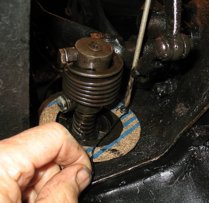

Post by Steve Jelf » Wed Aug 26, 2020 11:35 am

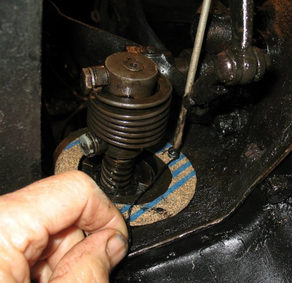

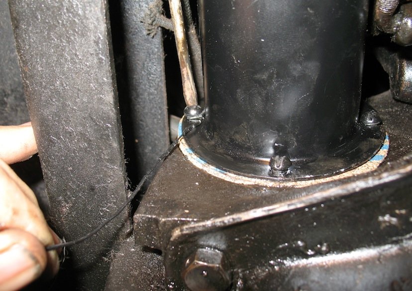

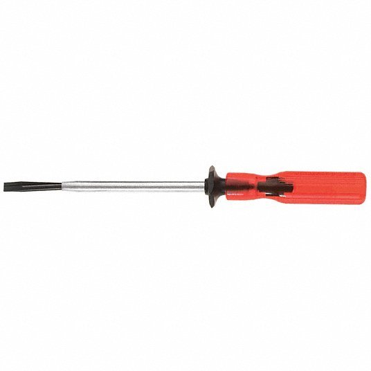

My father always said that if the engineers had to change it before they could have their supper, like he had to, it would have been designed differently. A split screw driver ( Kline K23 ) makes those screws much easier, as long as the screws have a decent slot. Usually you will find these screwdrivers in the electrical tools.
split screw driver.jpg (13.97 KiB) Viewed 5676 times

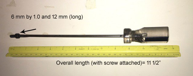

Post by Bill Robinson » Wed Aug 26, 2020 4:32 pm

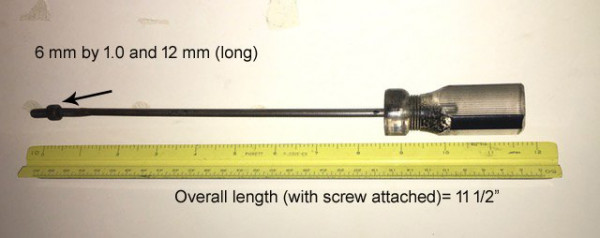

Allen Screw Driver- thanks to Reid Welch's post
Back around the turn of the century there was an active forum member named Reid Welch from somewhere in Florida. A thread was started regarding the pain of installing and removing the slotted bendix screws. Pictured below is Reid's answer. The picture is my donated screwdriver that I cut off and welded a short 1" piece of an allen wrench to the screwdeiver shaft. Once the driver is inserted into the allen screw it stays put and allows you to wiggle the screw through the shafts and align it with the threaded hole, horizontally. Overall length is very important. I have used the screwdriver many times over the years on my T's and helping many friends. It's still working now....and For All Eternity.

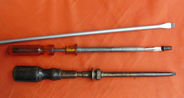

Choice tools in the T tool box, small screw holding screwdriver with release sleeve. Plus an old time one. The extra long single slot is used to finish the tightening, or for removal, as it reaches easy past the brake pedals and cams.
