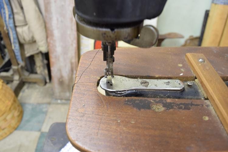

Briefly, the machine was in storage for about 20 years, used by the family for harness repair. It is a Singer class 29, an industrial machine, commonly known as a “patcher.” Mostly this type of machine was found in harness and shoe repair shops. I will down load a pic of the actual machine later. Ours is from 1914… say don’t some of you folks have 1914 Model T’s? The sewing machine is in two parts the table with treadle, and the actual sewing machine. The machine allows for slow hand stitching by turning the hand wheel, the material is fed by a walking foot. Or with speed using the foot treadle. There is no need to actually turn the work being sewn; this is done by turning the foot and the direction of feed is changed. I believe 1/8 inch leather can be sewn. The total machine with base is over 100 pounds of cast iron. If you enjoy the sound of a machine making mechanical noise , this has its own music.

Some pictures of a 1914 Singer 29-4 "patcher" sewing machine. A similar machine that may have been used by a Ford supplier to manufacture side curtains, floor mats, and even fan belts. Or reinforce a fan belt.
